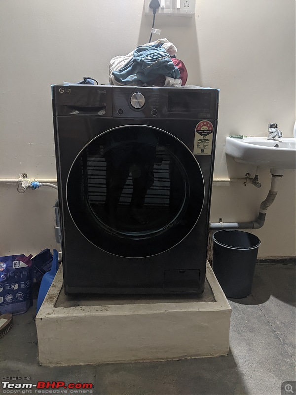

I am looking at replacing my 13 year old LG washing machine, I am looking at a front loading, atleast 10 kilos capacity machine. I was thinking of LG again, any other good reliable brands ?
I finally brought an 11kg LG direct drive washing machine, brought it at a LG shoppe for 38k, this included 2k exchange offer for my old machine, plus cash backs etc.
The machine is sooper silent except when it goes into a high speed spin cycle, it gets a little noisy, all four legs are properly balanced yet it makes sound, i am not bothered as the machine is placed on the ground floor. Over all happy with my buy.
