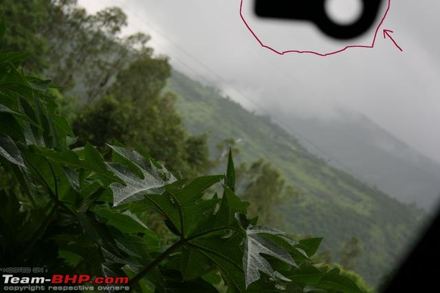

Hey guys, needed some help. My cousin got me a Canon EOS 400D from Aussie Land. I am having some problems with the pictures.
The Digital Camera Thread: Questions, discussions, etc.-img0535as1.jpg
As you can see in the pic, the black I dont know what to name it as, just keeps on coming in all the pictures. I read the entire manual also checked the online FAQ's but couldnt find anything about it. Can anyone please tell me what is it and why its happening ? And if there is a problem, where can I get it done in Mumbai.
There's something either inside the lens or on the sensor itself.
Remove the lens and see if there is something stuck to it. If not, try with another lens, if its not a lens issue, you could need to canon authorized service center

Looks like a big piece of dust is stuck on the sensor or the back of the lens..Remove the lens from the mount and check the inside for any dust ... If the lens is clean then its the sensor. Enable sensor cleaning mode in the settings menu and the mirror will lockup...you can see the sensor now. Use a blower to remove the dust particle(be very careful while doing this and make sure the battery is charged)...If the dust particle is very tiny and doesnt go away then you may try this method CCD / CMOS Cleaning Photo Gallery by Nicholas R. at pbase.com or you may get your sensor cleaned at the service center.. The Sensor is very fragile and be very careful while cleaning it..Good luck.

Hey guys, thanks for all the suggestions. Will I did remove the lens and check for dust, but nothing in it. Tried another lens, same issue. I also did try the sensor cleaning, but it didnt work. Still the issue exists. Should I take it down to some Canon Service Centre ?

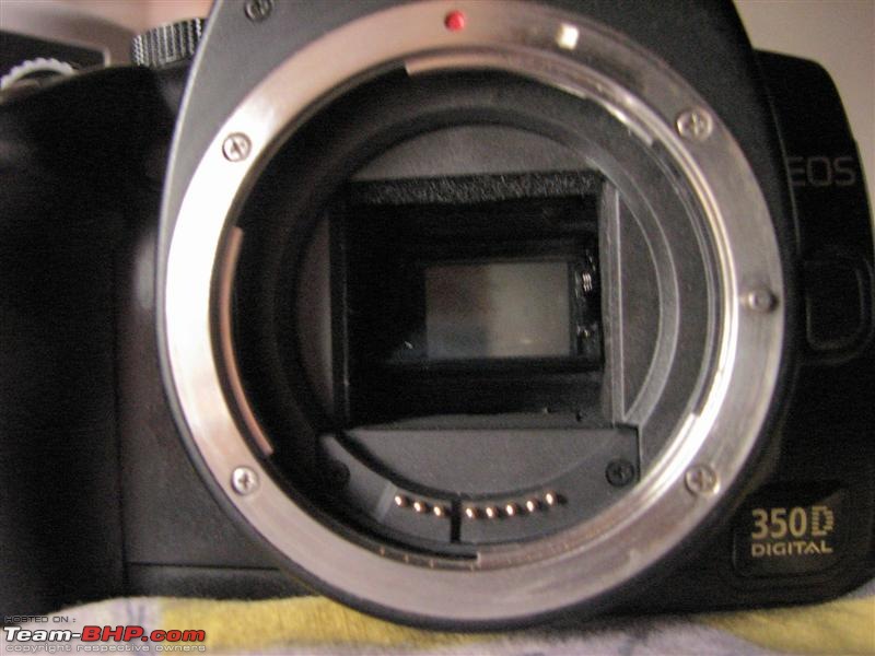

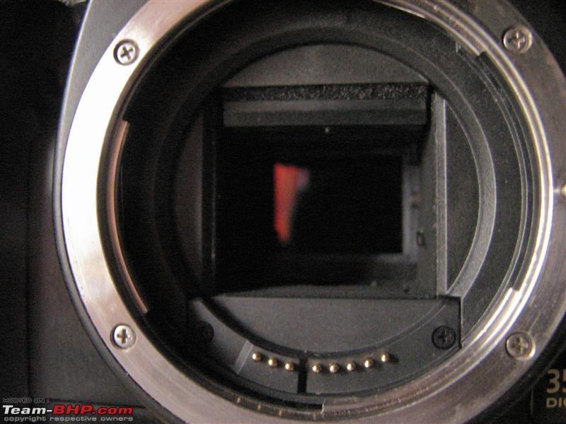

If you read my post carefully I mentioned that the mirror will lockup when sensor cleaning mode is enabled, exposing the sensor (this shud be done with the lens removed). If the camera is not in sensor cleaning mode the mirror blocks the sensor hiding it behind..Here are some pics for you to show what I mean..
