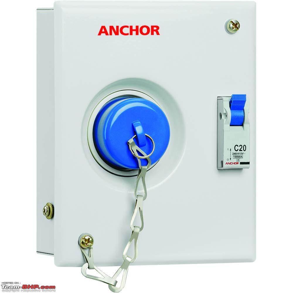

Originally Posted by Sebring (Post 4594976)
Meltdown, really? Do you have a picture of these metal jackets? I'm really curious. Even Google isn't of much help here.
I have had a few burnt sockets and plugs. Fortunately by the time the wires started smoking, I was around to stop. This happened even with my earlier 3 KVA UPS. Then I replaced every 15 A sockets with full metal jackets.
I am showing images sourced from the internet as I can't locate my own images.
The second image shows the metal wall socket.
The home / office air-conditioner thread-burntplugandsocket.jpg
The home / office air-conditioner thread-51izwyertl._sl1000_.jpg
I used this a lot in past
Thanks! Ah, this is what they use abroad, but in India, they take a lot of liberties. Do you suggest using this for all geysers (as well) right?
No, I don't think so. Thing is that the pug/socket combo being spoken of is rated at 20 (?) amp --- higher than the small or large 3-pin stuff in the rest of the house. In my relatively limited experience, these things are routinely used for AC units in India. It's not as if they are expensive even.
I hate them! They are sooo fiddly to wire up. And it just doesn't make sense to me that these plugs for highish-current devices should be made out of metal.
But they seem to be the thing for the job.
@ARoy; there are some plugs with solid brass pins where there is no problem. Also, Northwest has introduced a 25A plug (same matrix as 15A but longer pins). I think the main issue is the quality of pins in the plug.
The metal plug/socket is usually rated at 30 A. They have adequate space between terminals.
With conventional plu/socket - the heat builds up when there is poor connection (contact surface) between the plug and the socket. When it heats up the insulation in the wire melts and the plastic socket starts breaking down starting a chain of events.
With metal plug/socket - it doesn't happen because it is generously rated and have more brass/copper contact surface. The metal enclosure also acts as a heat sink in limited capacity.
Instead of plastic, these sockets have porcelain which is another factor against burning.
