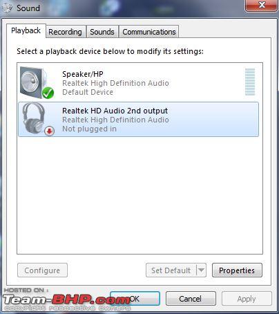

Old 29th August 2018, 00:27   #36
condor's Avatar
Location: Speed-brkr City
Posts: 16,242
Thanked: 16,902 Times
re: Bluetooth Headphones and Earpods
Chetan, thanks for those points, however the question I have is:
Bluetooth headphone is NOT listed here. How do I get it to show up ?
Another option I am trying is this, but I am not able to see the option for Audio Input / Output
condor is offline
Right click on the default playback device in the screen you posted, and check if your headphones are listed under either disabled or disconnected devices. If yes and the option to enable/connect is available, try that.
Chetan_Rao is offline
Old 29th August 2018, 11:09   #40
condor's Avatar
Posts: 16,242
Chetan, yes - done that. It's not there. Already using that option of showing disabled devices. I installed new Realtek drivers, but no go. I tried to install another BT driver, but laptop says I am not authorized to install ( looks like some privilges are blocked on our windows image).
I am wondering if a USB Bluetooth adapter will help here. Or would this also need additional permissions the system to allow audio signals to the BT dongle

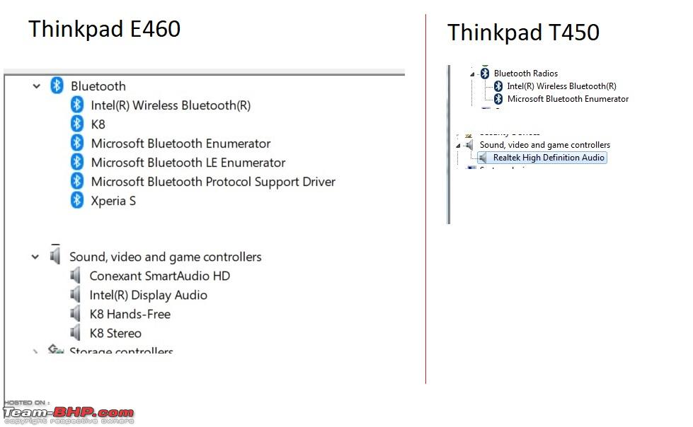

Old 30th August 2018, 09:41   #42
condor's Avatar
Posts: 16,242
Chetan, I tried to uninstall / re-install the drivers on the T450. I uninstalled both the BT and the OEM Audio drivers. On rebooting, the following drivers got auto-installed. Note that both the A2DP and Handsfree are installed
For comparison between the T450 where it does not work, and the E460 where it works, the listing in Device Manager:
The T450 currently shows the following Playback devices. Also, I am not able to get the 2nd one to work ( it is not disabled). The status remains same even though the BT headset is connected and services allow for streaming.
E460 - Win 10, OEM image
T450 - Win 7, office image
condor is offline

Old 30th August 2018, 15:16   #44
Chetan_Rao's Avatar
Join Date: Jul 2010
Posts: 6,800
Thanked: 28,339 Times
One more thing I can think of. If you try using Skype or WebEx for a VoIP call, does this headset show up in audio configuration on the specific apps?
I've had this issue in the past, companies restricting audio streaming to VoIP apps only, and disabling it otherwise. My headset would work on Skype/WebEx, but won't work for music on that specific Win 7 laptop.
Another thing to try if not done already:
In Device Manager > Bluetooth Radios > MS BT Enumerator > right-click and choose update driver software > let me pick from list of device drivers from my computer > Generic BT Adapter (if available).
A bit of research shows Win 7 has driver issues with lots of brands, and using the generic Windows BT stack instead of device-specific drivers helps resolve some conflicts.
