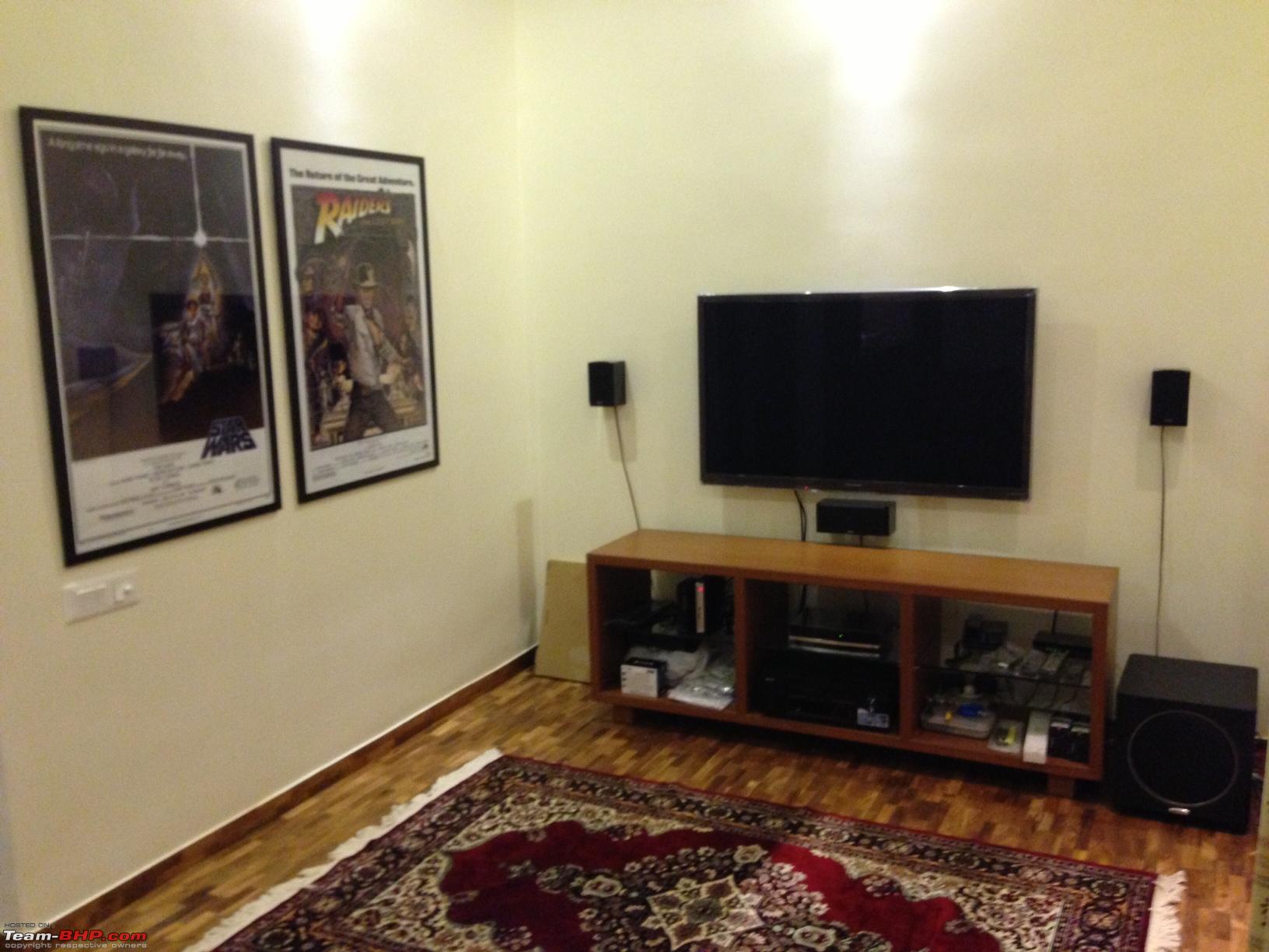

Finally setup the HT and thought I would share some pictures. Some casing work for the speaker cables is yet to be completed as is a DVD shelf and a comfortable couch but I am done for the most part.
Modest setup includes:
Here are a couple of pictures:
Cheers!

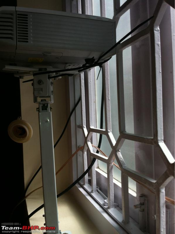

I have my projector sitting on my ceiling mount (mount is upside down) on my window ledge aligned with a bottle opener on one side:)
I did not screw this in permanently yet but have secured it with plastic ties.
This projects above my HT theatre setup on the wall opposite my bed. The projector just peeps over the headboard of my bed.
The projector is 5 years old and so far no bulb issues, touch wood!
