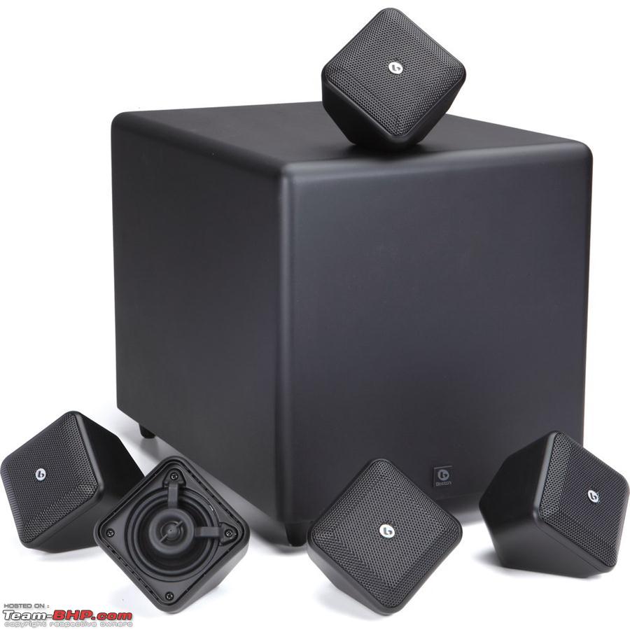

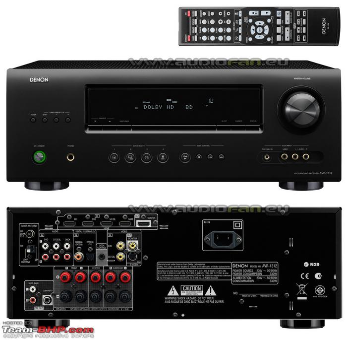

Have had a Denon 1312 with Boston Acoustic: SoundWareXS -Jewel Cube speakers for over a year coupled to my 46 inch LCD. Though am not a pro and have kept it on the stock settings, its does work well and give an awesome experience...
Anyone has any suggestions for tampering with the settings of the receiver for a better experience?
