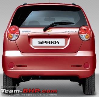

Chevy Spark earlier had the reverse lights on the bumper (2 round ones).
This caused issues of the visibility of the light to the car in the rear if he were in close proximity (I cannot see the lights low on the bumper of the car in front if I am too close to him).
Therefore, they went on to integrate the reverse lights in the tail lamp cluster (changed from previous mickey mouse lights to currently redesgned ones.)
Purely for safety & visibility issues
