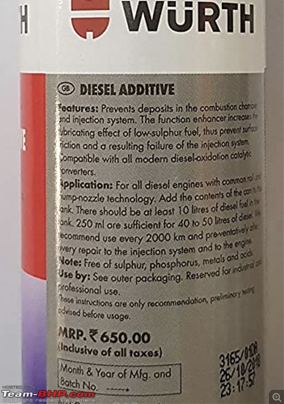

Has anyone tried the Wurth Diesel Additive? It seems it is designed for low-sulphur fuel. Can this benefit BS4 Diesel engines as against BS6 low sulphur fuel?
