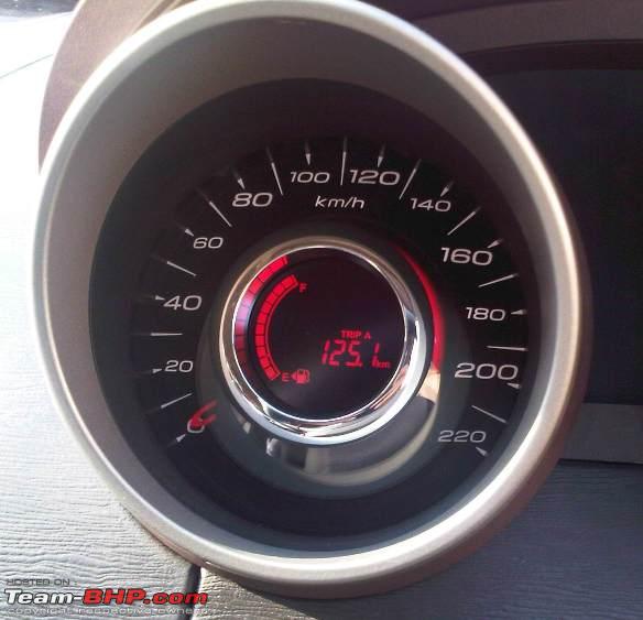

Here's a picture I clicked 1 week after resetting the trip-A (which was done at the time of filling up the tank).
The "Duma" comes home - Our Tuscan Red Mahindra XUV 5OO W8 - EDIT - 10 years and  1.12 Lakh kms-img00235201301220934.jpg
The car has closed 125kms and the fuel-level indicator has not moved even by one notch!
The XUV has a tank capacity of 70 liters and there are 10 squares/LEDs in the fuel-level indicator. So each LED should correspond to approximately 7 liters.
The Info screen was showing a mileage of 12.8kmpl till yesterday and yes, it was also reset when I filled the tank last time. The fueling was stopped at auto-cut-off.
If the car is giving 12.8kmpl and it has covered 125kms, it has consumed around 9.8 liters of diesel. With one LED corresponding to 7 liters, at least the top LED should not have been lit up.
Car manufacturers give a rosy picture when calculating the mileage as well. So if I take the indicated 12.8kmpl with a pinch of salt and say that the actual mileage is 11.5kmpl, the consumed fuel works out to be 10.8 liters. Again at least 1 (if not 2) LEDs should have gone off.
In fact, the fuel-level-indicator kept on showing me equivalent of FULL till about 145kms! So I believe it is showing a rosy picture.
Now let's look at what happens when the tank is about to get empty. When the fuel-level indicator started showing only the last 2 LEDs lit (10 days back), the DTE was showing as 65kms. Assuming that the DTE is correct, and assuming the FE as 11.5kmpl, 65kms would translate to 5.6 liters of diesel left in the tank at that point. With each LED corresponding to 7 liters, only one LED should be lit and not 2. So, I believe the fuel-level-indicator is showing an incorrect and rosy picture (claiming more than actual fuel level) at the bottom end as well.
Any views? Any other owners observed this?
same thing happened with me in my wagonR. Some times a particular bar of the indicator(digital) lasts for around 100 kms while some times it reduces in around 35-40 kms. Have observed the 6th bar generally goes down after a longer distance.
The only reason I can think is that the shape of the tank is not uniform all the way and hence the area also not over a particular plane. The sensor(don't know what type is used, maybe a simple float), I think measures the height or something similar and dooes not take the shape into consideration. That might be a reason that in the manaual they write that at different inclines, the fuel level might not be shown exact.
carzone is offline   (2) Thanks

First of all there are a lot of assumptions in your calculations. The first one being that all 10 LEDs are equal. The top most LED can't go over the top if you overfill b a few Ltrs. Secondly the last indicator blinks and it's a reserve it could indicate more Lts to be on a safer side, no?
So, the 145KM that it went on first LED could be because the tank was overfilled by a few Ltrs. Secondly I have driven my car( not suggested) in a situation when DTE was zero and my drive to the nearest bunk was around 25 KM. There was not even a blinking LED when i reached there.
There's a reserve and margin of error always factored into while calibrating the mileage and fuel indication, because exact "tankful" in Ltrs cant be same each time, for each person, at any of the petrol pumps.
Let me add that I saw the reading of ECM, it reads in 0.1 variance (that is per 100 ml). So the sensors are correct but in daily use other variables are not.

This is precisely what I am talking about. I feel like being lied to and that's not a pleasant feeling. If it is not even decently accurate, what's the point providing it?
So, the 145KM that it went on first LED could be because the tank was overfilled by a few Ltrs. ...
Rohit, I am not claiming the calculations to be accurate. All I am saying is that the fuel-level-indicator's error margin is HUGE.
I did stop fueling at the auto-cut-off. So I doubt if the tank was overfilled.
During the analog needle days, I could live with the non-linear fuel-level-indicator. In the digital-age, using a non-linear scale is just laziness (or lack of skills) on the part of the designers (at best) OR a deliberate attempt to mislead the customer (at worst).
... Secondly I have driven my car( not suggested) in a situation when DTE was zero and my drive to the nearest bunk was around 25 KM. There was not even a blinking LED when i reached there.
Your and Debuda's experience of driving when DTE was showing zero, actually throws light on another aspect. Is the XUV's tank capacity really 70 liters?
The example I have given where my car was showing 65KMs as DTE and as per your experience I can drive another 20-25kms even after zero DTE, I would say the car had at least 7 liters in the tank. I filled up till auto-cut-off and I paid for additional 68 liters. So looks like the tank can take 75 liters even when not overfilled.

Yes, I remember at least two instances when I have tankfull'ed 72 Ltrs. It's quite normal. The capacity of the tank indicates when it's detached, there's fuel in the fuel lines too.
So the DTE or the indicator in most cars are calibrated with positive bias. Just imagine a situation when DTE shows 15KM, but car stops because of empty tank.
Personally I rarely used DTE for any reference so I can't comment on its accuracy. My comments are only based on my experience with the fuel indicator and yes the topmost LED takes time to go
