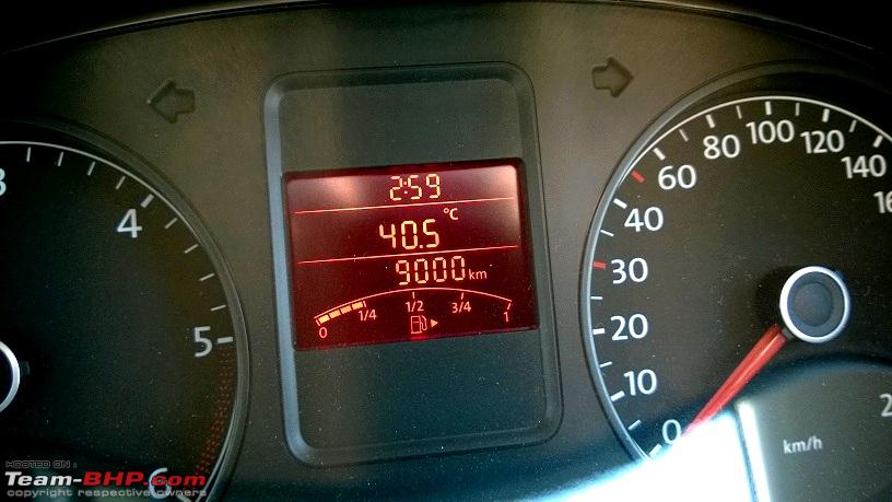

Parents left for home last week *sob sob* after staying with me for a week. We went to Valsad and Ahmedabad. Needless to say, they loved the roads here and were all praise for the infrastructure here compared to the ones we have down South. The dreaded Kuthiran stretch during monsoons and Walayar-L&T bypass anyone?
Clocked 9000 during the process:
VW Polo GT TDI ownership log EDIT: 9 years and 178,000 km later...-wp_20140426_15_02_46_pro.jpg
Notice the outdoor temperature! Summers have set in here and the temperatures have shot up. The AC has performed up to the mark and the cooling has been very effective.
6k to 9k and April isn't over yet! This has been the best month for the car. And the driver!

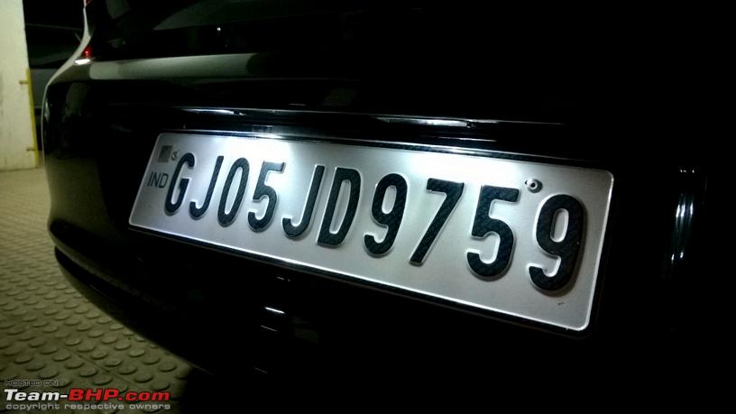

Was tinkering around with the car and figured out that the license plate lights are held in place with plastic locks that can be simply pulled out with bare hands!
They seem to be different compared to the ones we have on the Vento. BHP'ian el lobo 6061 has some snaps of the license plate lamps used on the Vento here - Link
Took them out of the bumper, pulled the harness off and found out that they were completely laden with dust (no pics). Cleaned them with a used toothbrush and since I had a pair of cheap white W5W LEDs lying around, I decided to swap the halogen ones with these. The results were pretty good. But I couldn't figure out how the bulbs could be accessed. The natural instinct is to pry open the plastic diffuser lens but turns out, it isn't that way! Simply twist the male connector on the lamp and it comes off the housing.

LED replacements are a straight fit:
VW Polo GT TDI ownership log EDIT: 9 years and 178,000 km later...-wp_20140517_22_27_00_pro.jpg
VW Polo GT TDI ownership log EDIT: 9 years and 178,000 km later...-wp_20140517_22_32_41_pro.jpg
VW Polo GT TDI ownership log EDIT: 9 years and 178,000 km later...-wp_20140517_22_32_48_pro.jpg
These LEDs observe polarity so if it doesn't work the first time, simply swap their terminals.
