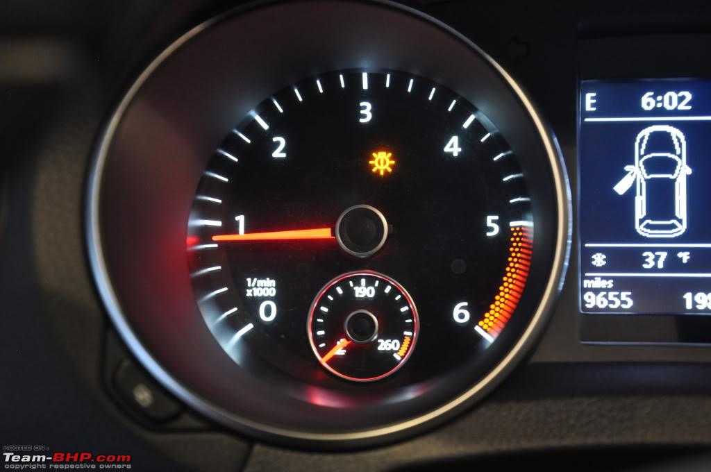

Not entirely. No fancy electronic warnings, but, at least with the indicators.
Just the indicators hyperflashing when one of the bulbs fuse out. What about the rest of the bulbs?
I was referring to this warning light:
VW Polo GT TDI ownership log EDIT: 9 years and 178,000 km later...-dsc_0250.jpg
Source: Google images
The Punto has a much better system in that sense. The cluster displays a bulb-out error plus if one of the rear indicator bulbs fail, the brake + stop lights work as the indicator in place of the fused bulb. Better than having no light at all! Who'd have thought?
Wow! What's the Italian for Vorsprung durch Technik?
