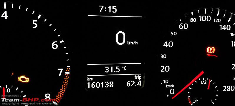

  • With almost no long drives or scheduled road trips during the last year, my car saw the least running in a year and the odo gradually trickled towards 158,000 km last week.

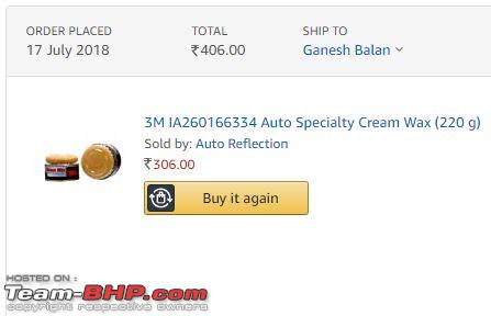

    Gave her a nice wash and decided to try my hands at waxing for the first time! I had a tin of 3M’s wax which believe it or not, is over 2 years old and has not been opened once!
    VW Polo GT TDI ownership log EDIT: 9 years and 178,000 km later...-cww2a.jpg
    Always loved the idea of waxing but the sheer efforts that it needed put me off and I’d simply drop the car at my trusted detailer’s place for a round of detailing. This time however I decided to give it a try and the results were pretty tempting! I used the supplied sponge to apply the wax, waited for a few minutes and buffed it using folded microfiber towels. It left a pleasant, mirror-like gloss on the panels. I did not quite use a masking tape to cover the window beadings and it took a while to get the wax off the rubber beadings.

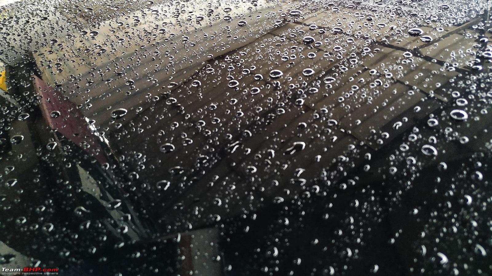

    Nice water beading effect too from a cheap wax:
    VW Polo GT TDI ownership log EDIT: 9 years and 178,000 km later...-cww6.jpg
    And that’s when I realised why some of them are so passionate in doing this and even quit their desk jobs to start work on this line. I packed up all the stuff and took me a good 10-15 minutes to wind up and store everything in its rightful place. Had lunch and took a short nap as I was exhausted. After an hour, I woke up with a terrible body pain and discomfort in the shoulders, biceps and arms! Jesus Christ, I just couldn’t stretch my arms! It was THAT painful. Probably all these days of no body movement during the lockdown and when the muscles were subjected to such an intensive workout resulted in the pain. I simply took rest that evening and luckily, the pain was gone by the next morn. I recalled this epic thread on the forums. Please be sure to read it! A good rotary polisher and some buffing foam/wool pads are definitely on my to-buy list now.

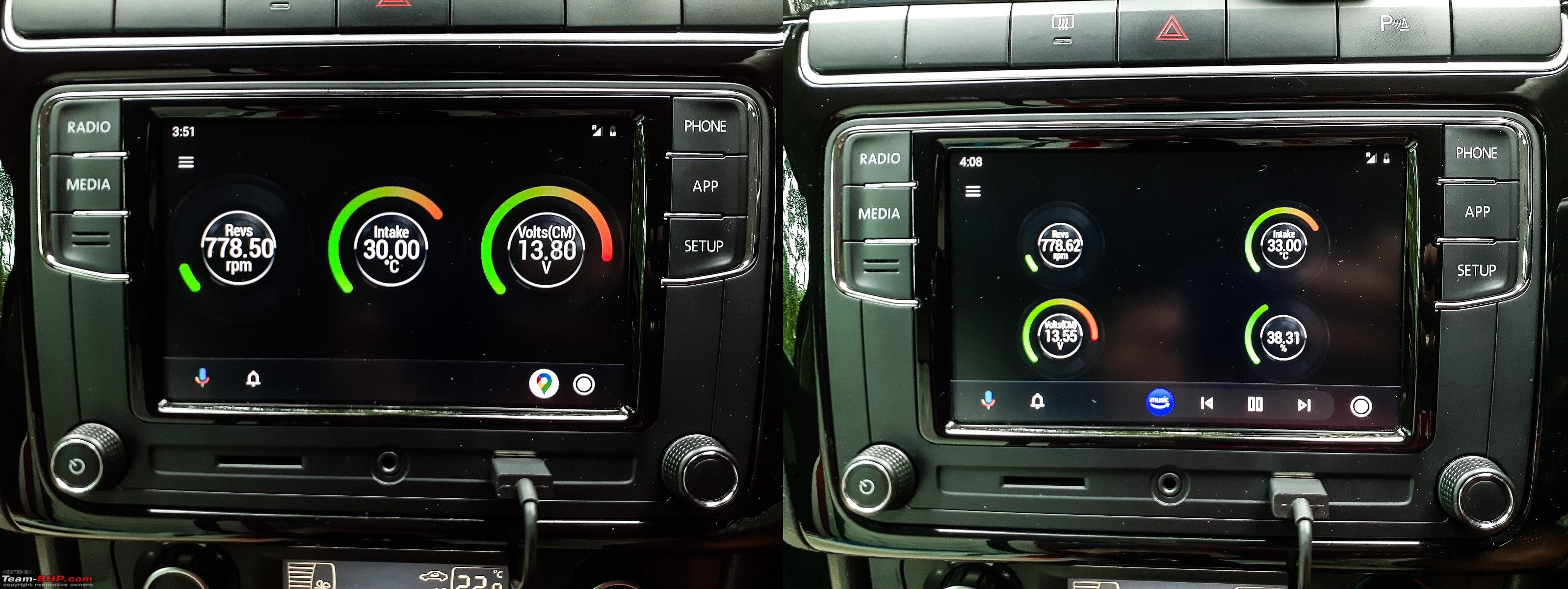

    The OBD2AA app (plugin in the truest sense) pulls data from the ELM327 bluetooth adapter plugged into the OBD port of the car through the Torque Pro app. Pressing the OBD2AA icon from the Android Auto launcher, launches the display which shows various gauges depending on how the app is configured in the phone.
    VW Polo GT TDI ownership log EDIT: 9 years and 178,000 km later...-obd2aa.jpg
    The sheer number of customisations the app offers is mind blowing! These are some of the screenshots from the app installed in the phone:
    VW Polo GT TDI ownership log EDIT: 9 years and 178,000 km later...-obd2aa1.png
    There’s a problem however - the app. is a bit iffy with some smartphones and the app. developer does mention it explicitly. For instance, he says the app is not compatible with Xiaomi but I have an MI A2 and it works 7 out of 10 times without crashing (unplugging and plugging the USB cable works all the time). I get this sometimes.

    This works with all the cars and not just the VW Cars. Try it out, its fun. But don’t lose sight of the road if you’re testing it while the car is in motion!
    Performance Monitor:
    So, another developer who goes by the ID Chillout (nice name pal!) has developed a free app called Performance Monitor which doesn’t require the OBD2 BT adapter and it pulls data from the car’s BCM. Unfortunately, not much for the Polo but I think it could display a whole lot of data for the Jetta and Passat owners. Not the most stable app/plugin because it crashes if I select the home (AA launcher) and then select the app again. Maybe the developer could help - I am trying to contact him and pass on the feedback. He drives a Golf GTE in Albania! Anyways scratch that, check out the snaps from the unit:
    VW Polo GT TDI ownership log EDIT: 9 years and 178,000 km later...-pm.jpg
    Looks cool! Check out the short 3-minute clip which shows the app in action and how it crashes:

    Connect the phone to the head unit and you should see the Performance Monitor app and the OBD2AA app there. Enjoy fiddling with it! Oh and it works with other cars too, not just VW or Skoda since the app pulls the data from the OBD2 dongle! Why should the MQB boys have all the fun?!

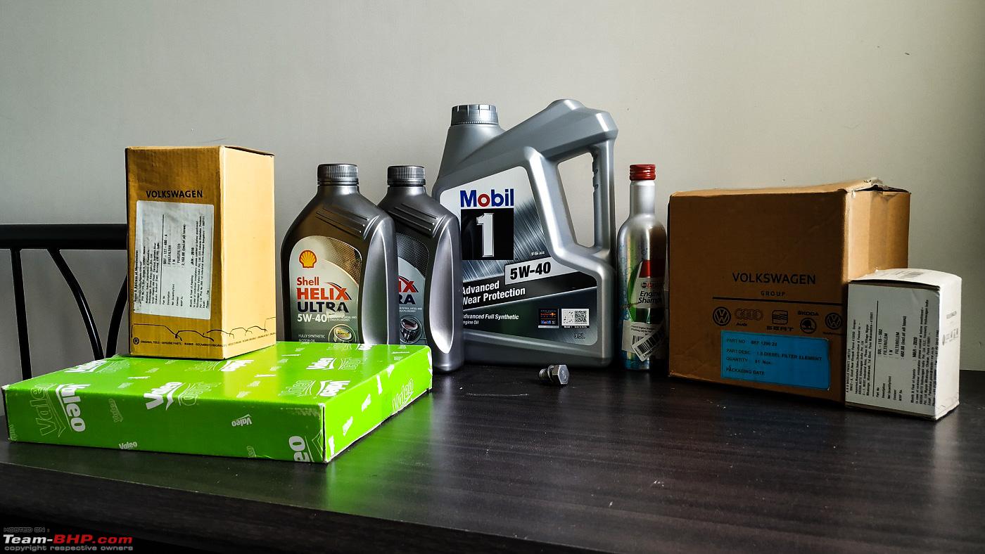

  • The next oil-change service is overdue. Since the running last year was low, I’ve decided to push her a bit longer (probably until 160,000 km) before I do the service.

  • 160,000 km up!
    VW Polo GT TDI ownership log EDIT: 9 years and 178,000 km later...-odo.jpg
    This has been a S - L - O - W year for me. Lockdown + no drives mostly. I am so eagerly waiting for the TN and KL governments to do away with the quarantine norms!

    All the parts pose for a photoshoot:
    VW Polo GT TDI ownership log EDIT: 9 years and 178,000 km later...-15.jpg

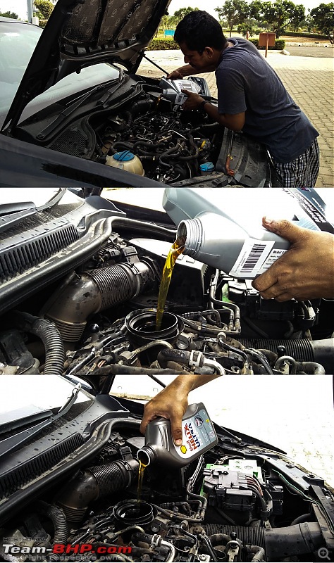

    Pouring the new oil:
    VW Polo GT TDI ownership log EDIT: 9 years and 178,000 km later...-8.jpg
    Yep, I did mix Shell with Mobil 1. Unfortunately, Mobil 1 did not have a 1L pack of 5W40 so I had to use a 1L bottle to top up the quantity to 4.2L. This was the only solution I had in mind. Another can of 3.5L would have been a waste.

    A breakdown of the expenses:
    Mobil 1 5W40 3.5L can - Rs. 2364
    Shell Helix Ultra 1L can - Rs. 1100
    Castrol Engine Shampoo - Rs. 400
    Oil filter - Rs. 483
    Cabin air filter - Rs. 383
    Fuel filter - Rs. 1900
    Air filter - Rs. 400
