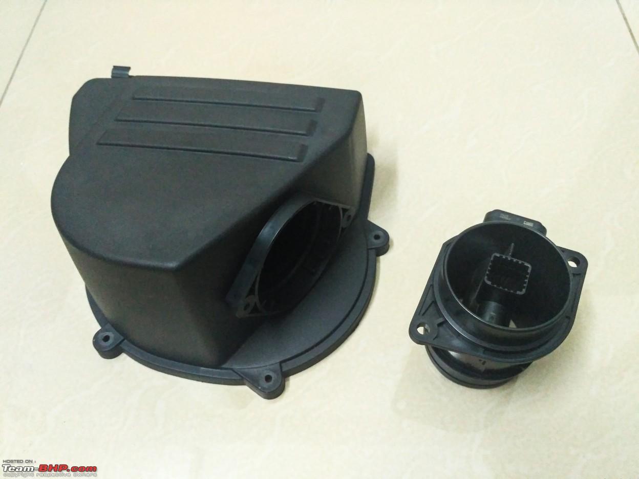

Over the New Year's weekend, I undertook two major activities - the MAF sensor cleaning and the 120k km service. Technically, this is the 8th scheduled oil change service. They've been explained in detail below. The pics are not the best!
MAF sensor cleaning:
After delaying this activity forever and ever, I finally got to clean the MAF sensor, a day before the air filter was changed. The MAF sensor was never cleaned to this day in the last 4 years and 3 months of ownership. The process was very simple and straightforward.
Unplugged the connector to the sensor, removed the air filter box’s top cover out of the assembly, twisted and removed the air filter and, using a pair of hose clip pliers, the plastic hose was disconnected from the sensor outlet:

This is the hose clip pliers - an incredibly helpful tool for loosening spring clips and holding it under tension, unlike the combination pliers which can slip:

2 Torx screws hold the sensor to the filter box cover. Unscrewed them to get the sensor off the box:
VW Polo GT TDI ownership log EDIT: 9 years and 178,000 km later...-img_20171230_220538.jpg
Used a bottle of IPA (iso-propyl alcohol) and a CRC spray can to clean the sensor and the innards:

The 2 ends of the sensor assy. were closed using lids of Johnson's buds plastic jar after IPA was poured and shaken thoroughly to dislodge any dirt stuck to the sensor element (which BTW, wasn't visible to the naked eye!). A discarded toothbrush was used to clean the innards and other hard-to-reach areas.
VW Polo GT TDI ownership log EDIT: 9 years and 178,000 km later...-img_20171230_224010.jpg
The filter box was also cleaned:
VW Polo GT TDI ownership log EDIT: 9 years and 178,000 km later...-img_20171230_224111.jpg
The sensor was screwed back to the filter box cover. The assembly was left overnight for any alcohol to dry off before it was screwed to the air filter box.
