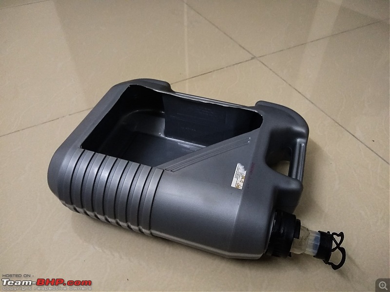

The makeshift oil catch pan:

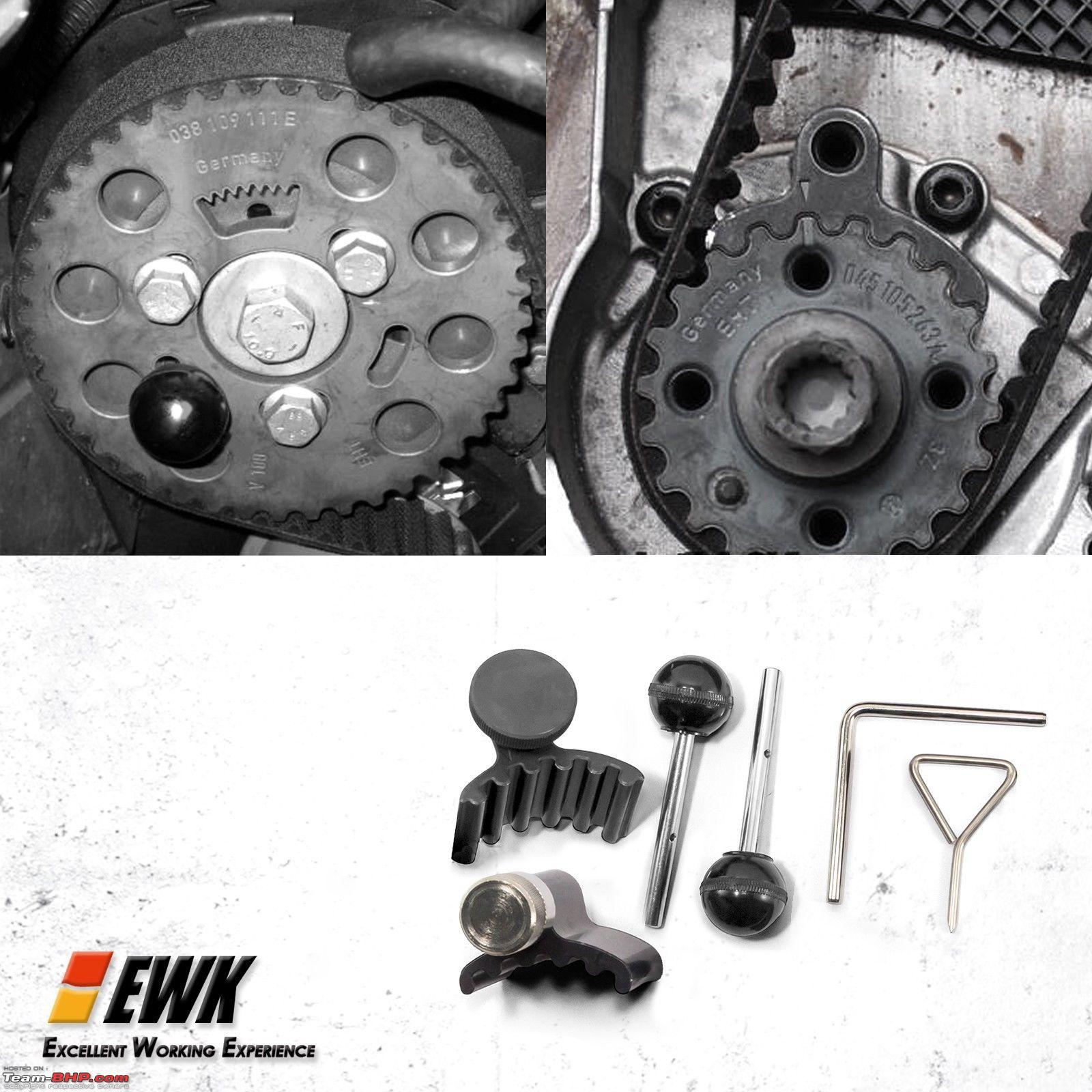

The timing belt was changed at an FNG here owned and operated by Jai Prakash. In addition to the timing belt system replacement, the V belt along with tensioner and idler pulley that drives the alternator and AC compressor was also changed. |
I see that the crank was not locked, only the cam was with a 6mm hex key.
I have seen so many VW TDI timing belt jobs go wrong just because you don't use the relatively cheap cam and crank locks.
BTW this tool set costs approx 3k in the local tool store.
This is the right way to do the Timing belt :

Thanks! I am hoping the FNG tech Jaiprakash did a proper job without skimping on the tools or efforts. Only time will tell.
