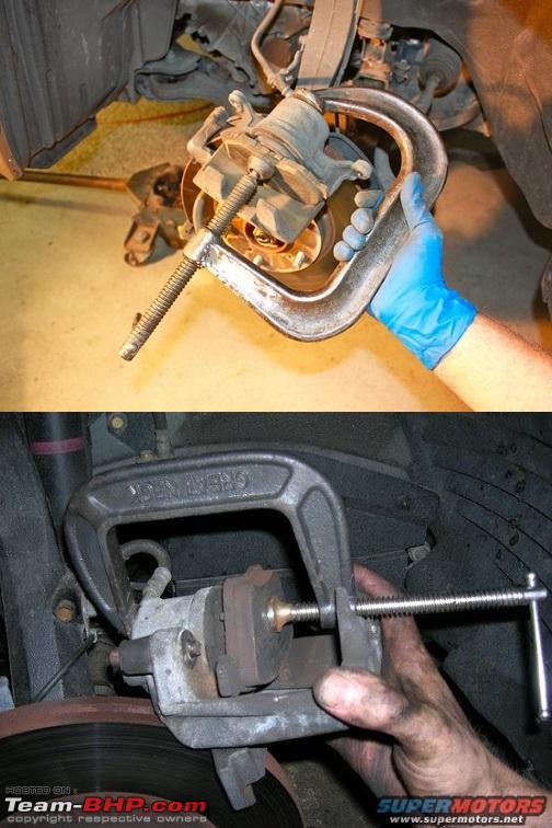

7. Use the flat-head screwdriver on the inside brake pad to push the piston back to the outermost position. Insert the screw driver here and push the piston back:
VW Polo GT TDI ownership log EDIT: 9 years and 178,000 km later...-8.png
Or you can use the 6”/120 mm C-clamp and the old brake pad to compress the piston. /Lesson learnt #1.
When the piston is compressed, the brake fluid in the reservoir rises. When you do it for the other wheel too, it may spill out a bit so keep some rag clothes around the reservoir cap as brake fluid is highly corrosive.
Here’s how it is done with the C-clamp and the old brake pad:
VW Polo GT TDI ownership log EDIT: 9 years and 178,000 km later...-9.jpeg
VW Polo GT TDI ownership log EDIT: 9 years and 178,000 km later...-10.jpg

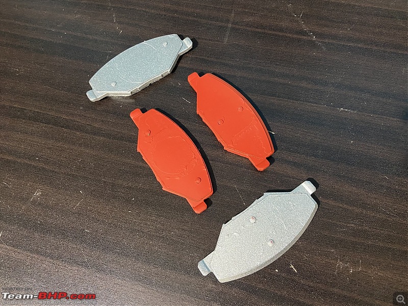

13. Insert the brake pads into the sliding clips on both sides of the disc. IMPORTANT - While inserting the brake pads, observe the INSIDE and OUTSIDE markings on the pads! Some set of brake pads have rivets on the inside while some have it on the outer ends. Where the rivets are located close to each other, these are the pads meant for the outside and where the rivets are located far away, these are the pads meant for the inside i.e. the piston side. The piston head has to mate flush with the metal surface of the pads. /Lesson learnt #2.
(Image courtesy - Boodmo)
Whereas some pads have no such distinction and they can be interchanged. Take a look at this set from Motherson:
VW Polo GT TDI ownership log EDIT: 9 years and 178,000 km later...-21.jpg
You can see that the rivets are located at the extreme ends and does not come in way of the piston head.

Originally Posted by Gannu_1 (Post 5058203)
Use the flat-head screwdriver on the inside brake pad to push the piston back to the outermost position. Insert the screw driver here and push the piston back. Or you can use the 6”/120 mm C-clamp and the old brake pad to compress the piston. /Lesson learnt #1.
Pay attention to the INSIDE/OUTSIDE markings on the pads when you replace it on the calliper
Great job there @Gannu_1. There is another risk associated with using a screwdriver to push the piston back - if it slips for some reason, the rubber bellow over the piston gets cut, and that leaves an opening for water to get in and cause pitting on the piston over time. The piston would get jammed and cause steering wobble. I've experienced this issue twice in my Grand Vitara, and eventually got a new piston. Please get the discs skimmed at a machinist at the earliest.
Just looking over the pictures of the pads I had replace I noticed two additional approaches that were followed.
1. Rivets that were flush with the metal face of the pad
2. Indentations in the face of the pad were the rivets were.
I also get brake shims when buying pads from Bosch. In this case grease is not needed. The shims are a kind of synthetic material that you can stick on.
