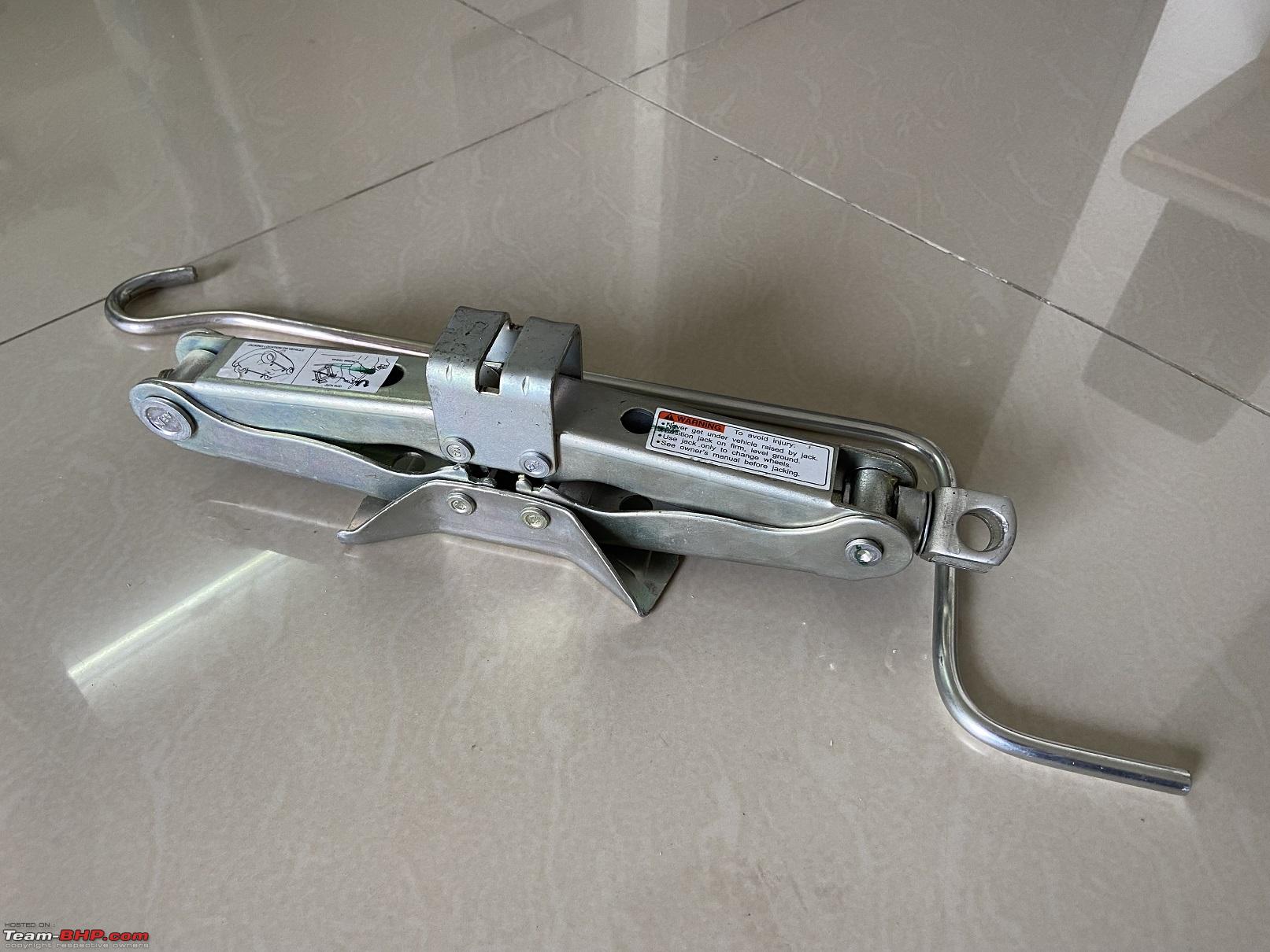

Great job there @Gannu_1. There is another risk associated with using a screwdriver to push the piston back - if it slips for some reason, the rubber bellow over the piston gets cut, and that leaves an opening for water to get in and cause pitting on the piston over time. The piston would get jammed and cause steering wobble. I've experienced this issue twice in my Grand Vitara, and eventually got a new piston.
Thanks! Will keep this in mind. We racked our brains to find a workaround in the absence of a proper C-clamp. So much so that the first thing I did after reaching home was to order a pair of larger C-clamps. Here they are with the 2" one:

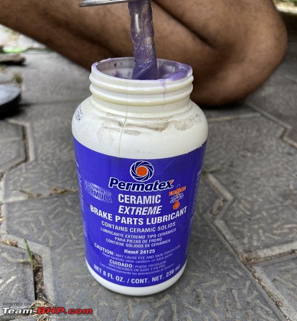

By any chance have you used Permatex Purple Brake Grease? Would be great if you could evaluate the performance of your rubber boots after a few days or months of driving, if you're using this grease for the first time.
Yep, Permatex Ceramic Extreme and this is incidentally the first time I am using it since I am working on the brakes after the 75k km mark.
VW Polo GT TDI ownership log EDIT: 9 years and 178,000 km later...-jpeg-image-18.jpeg
Shall report back with my findings after a few months.

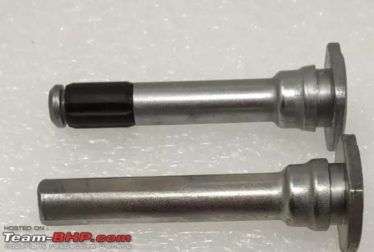

Also, did one of your calliper pins not have a small rubber ring? I have seen it on many other Polos which have this same brake system.
You mean a rubber sleeve? From the pair, one of the pins had it (the top sliding pin IIRC) but not the bottom one if you're referring to this:

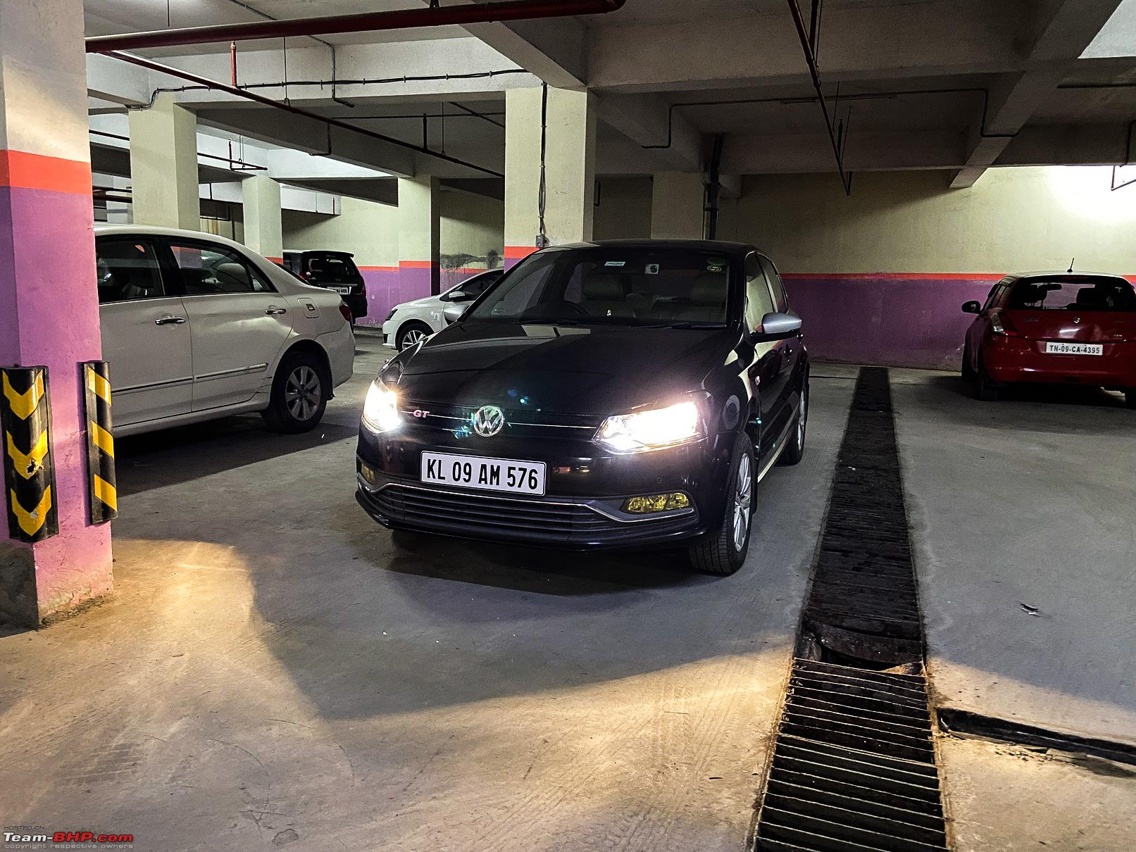

Hey guys, dropping some updates on the ride. Trust all of you are keeping well during these times and hope the worst is behind us. I managed to dodge the virus thus far due to sheer luck and the usual precautions. I was fortunate enough to receive the first shot of vaccination here at Chennai which may not have been possible if I had spent the last lockdown at Palakkad. Anyways, moving on to the updates in no particular order.
Sorting out the High Beam issue:
Originally Posted by Gannu_1 (Post 5058203)
I am figuring out some high beam issue on my headlamps as we speak. Shall post about that separately.
Finally, after a lot of sweat, the high beam issue was resolved. Just a heads-up though – the next few posts will be helluva long! I’ve described the whole ordeal with several snaps. But this one issue had a lot of learnings involved.
Long story short - one fine day, the high beams stopped working and there was no indication of the high beam symbol on the instrument cluster. Removed the xenon headlamp assemblies, plugged the H4 bulbs into the sockets and realised that the co-driver side high beam wasn’t turning on. Both the low beams were working fine and the driver-side high beam was working. After a LOT of troubleshooting, the issue was narrowed down to a disconnect somewhere in the factory wiring harness and with the help of my FNG technician, the issue was resolved. This also led me to retire the xenon headlight assemblies for good having served the last 6+ years faithfully and reverted to a set of new single barrel headlights with 90/100W bulbs and a relay harness. The whole process is described below in detail.
VW Polo GT TDI ownership log EDIT: 9 years and 178,000 km later...-1.jpg
Some of you would know, I had a Morimoto Mini D2S based HID setup retrofitted to the stock single barrel headlights since October ‘14. The entire DIY process has been documented here. The cut-off from the projectors wasn’t the best out there but there was a massive improvement over the stock H4 55/60W bulbs. This setup worked well to this day without any troubles.
Before the last lockdown, I was heading to work as usual and when I pulled the LHS stalk for flashing/passing, I noticed the high beam indication symbol on the cluster missing! This had never happened before. I wondered if the SMD LED for the warning symbol soldered to the instrument cluster’s PCB had conked out! While returning home in the evening, I realised the high beams were not working - not while flashing or if they were engaged. Bigger problems! I decided to sort this out over the weekend. Soon enough, the driver side headlight low beam gave up! This was becoming troublesome and embarrassing now. I wouldn’t drive around with just one headlight which looks very odd like a pirate’s eye patch. It wasn’t too dark in the evenings so I would turn off the headlights and drive back home with the fog lamps. With no high beams and with the driver-side headlight out of order completely, my guess was on the Morimoto relay harness now.
There were 3 problems now:
1. High beams don’t work.
2. There is no indication of the high beam on the instrument cluster.
3. The driver-side low beam also doesn’t work.
At the apartment basement…
That weekend, armed with the required tools, I headed to the basement parking lot. Unplugged both the headlight assemblies and swapped them. i.e. the driver side headlight assy. to the co-driver side ballast + socket and vice-versa. Sure enough, the now driver side headlight assy. wouldn’t turn on while the co-driver side headlight works. So defective bulbs were ruled out; probably, ballast was the culprit. The only missing link is the D2S bulb socket or a loose contact somewhere in the circuit. I fiddled with the sockets and it would intermittently work on and off. So the socket or the short harness from the ballast to the D2S socket on the driver-side had a problem.
I lugged both the headlight assemblies along with the ballasts and the Morimoto relay harness to my apartment. The whole thing was very exhausting back at the basement with no light or proper ventilation and I was in no mood to fiddle around any further. Lo and behold, TN went into a complete lockdown. Which meant my car was going to be parked in the basement with no headlights for days together and this would draw some unwanted attention from the security staff going on rounds and owners of other cars parked in the vicinity. Never mind.
Back to my apartment…

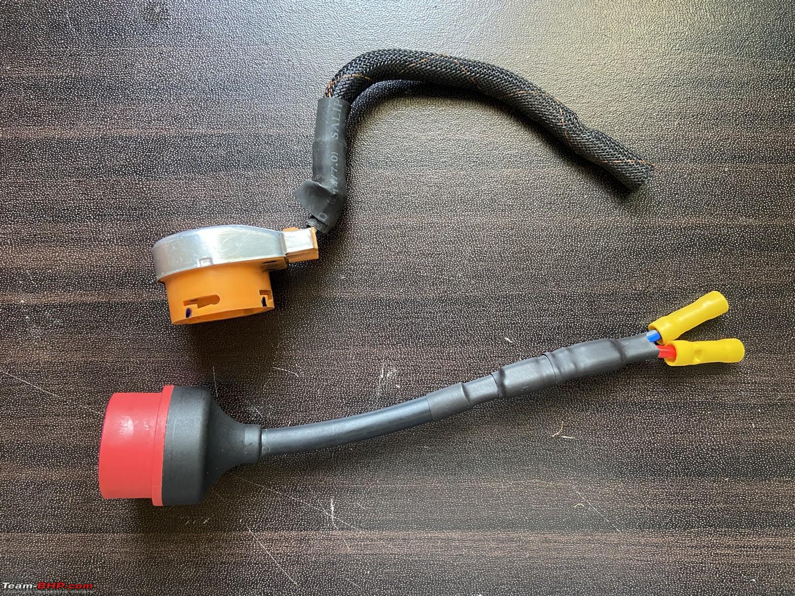

The sockets that shipped with the ballasts in the Morimoto kit back in 2014, came with a right-angled D2S igniter/connector perma-wired to the ballast:
VW Polo GT TDI ownership log EDIT: 9 years and 178,000 km later...-2.png
When this is plugged to the bulb in the headlight assy, the cable was taking a sharp bend at the socket and part of the insulation from the cables had worn out exactly at the bend.
VW Polo GT TDI ownership log EDIT: 9 years and 178,000 km later...-3.jpg
(Image clicked after the cable was cut from the ballast)
VW Polo GT TDI ownership log EDIT: 9 years and 178,000 km later...-4.jpg
Morimoto never had those straight D2S connectors around that time; they do have them now however. Probably, there was some feedback from existing customers on these right-angled connectors. Because in some headlight assemblies, there is no provision to bend the cable and it has to exit straight from the end.
To resolve the sharp bends on the D2S connectors, I had sourced a pair of D2S sockets with straight leads from Aliexpress (the good ol’ days sigh!):
VW Polo GT TDI ownership log EDIT: 9 years and 178,000 km later...-5.jpg
These were purchased way back in Mar ’19:
VW Polo GT TDI ownership log EDIT: 9 years and 178,000 km later...-6.png
Check out the differences between the two connectors (Aliexpress one on the left and Morimoto one on the right):
VW Polo GT TDI ownership log EDIT: 9 years and 178,000 km later...-7.jpg
I decided to replace the Morimoto’s connector with the straight connector:
VW Polo GT TDI ownership log EDIT: 9 years and 178,000 km later...-8.jpg
VW Polo GT TDI ownership log EDIT: 9 years and 178,000 km later...-9.jpg
The connector on one headlight assembly was replaced and I threw away the old Morimoto connector to the bin. Big mistake! Why? You’ll find out. I guess life teaches us lessons the hard way sometimes.

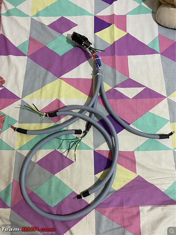

Instead of using the butt crimp connectors for the ballast’s AC output cables to the igniter, I soldered the two cables together and used two rounds of heatshrink sleeves to insulate the soldered joints. Retested with the bench power supply and the light worked 8 out of 10 times. Randomly, it wouldn’t turn on. I decided to leave this for the time being and concentrated on the co-driver headlight assy.
Additionally, I wanted to replace Morimoto’s relay harness and decided to fabricate my own harness for the assembly. The Morimoto harness worked just fine but what’s that saying again? An idle brain is a devil’s workshop?
I got these parts from GP Road, Chennai – considered to be the Mecca of all things automotive:
- SPST (single pole single throw) relays 12V 40A - 2 nos.,
- SPST relay sockets with leads - 4 nos. (2 for backup; dirt cheap anyway)
- Fuse sockets - 2 nos.
- Fuses 12V 30A - 2 nos.
- Ground terminal lugs - 5 nos.

Completed rest of the wiring with the connectors for the solenoids and ballasts, corrugated protective tubing for the cables, zip-tied the bunch.
VW Polo GT TDI ownership log EDIT: 9 years and 178,000 km later...-31.jpg
Tested the harness with the actual headlights and that’s when I observed one of the headlights was not turning on occasionally. This was the one with the straight D2S igniter from Aliexpress. And I had thrown away the old Morimoto igniter in the bin which my maid promptly emptied! This turned out to be a big, expensive blunder from my side. I should have preserved the Morimoto D2S igniter!
I opened up the Aliexpress straight igniter and it was a shoddy part:
VW Polo GT TDI ownership log EDIT: 9 years and 178,000 km later...-32.jpg
VW Polo GT TDI ownership log EDIT: 9 years and 178,000 km later...-33.jpg
At this point, I was very frustrated! I thought enough is enough, slept on it that night and went ahead with the decision to swap them out with a set of new, stock headlights. The xenon setup had served me faithfully all this while for the last 6+ years with so many night drives I had undertaken from Chennai to Palakkad and back. This was also our first intense DIY that my good friend Moorthy and I did, which lasted close to two weeks. Man, I was definitely going to miss that nice, sharp cut-off with the blue hue and the fun of flicking the high beams like the camera flashes. It used to turn so many heads when the coming-home and leaving-home lights would turn on at the parking. But as they say, all good things must come to an end and thus, I chose to gracefully retire the bi-xenon setup.
So what went wrong really?
1. The Morimoto ballast on my setup had the output AC cable permanently connected to the ballast.
VW Polo GT TDI ownership log EDIT: 9 years and 178,000 km later...-34.png
The later units from Morimoto came with removable input and output connectors for the ballast like this:
VW Polo GT TDI ownership log EDIT: 9 years and 178,000 km later...-35.jpg
So replacing the bent igniter cable with a straight one wasn’t possible without splicing the AC output cable.
2. The Aliexpress’ straight D2S igniter cable failed to work properly. Guess one can only expect so much from a cheap cable.

Ordered a cheap pair of Philips 55/60 W bulbs from Amazon for testing and sorting the high beam issue. So the new set of headlights are here. What remained to be sorted was the [/b]high beam issue[/b].
Inserted the bulbs into the stock bulb holders. Turned the rotary switch on for the low beams - both the low beams work properly.
VW Polo GT TDI ownership log EDIT: 9 years and 178,000 km later...-40.jpg
(Please excuse the dirty engine bay; I was in no mood to clean the car without resolving this issue first!)
Flicked the stalk for the high beam - only the driver-side high beam turned on. Status quo.
VW Polo GT TDI ownership log EDIT: 9 years and 178,000 km later...-41.jpg

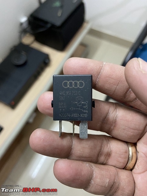

Step 2 - check the relays. The pre-facelift Polo with the single barrel headlight setup has a SPST relay for the low beam but none for the high beam. So this was technically a moot point but to eliminate the issue, I decide to test the relay anyway. This is the relevant relay for the headlights:
VW Polo GT TDI ownership log EDIT: 9 years and 178,000 km later...-42.png
I got home the relay and it was clicking with a +12V supply. I swapped it with the adjacent 646 relay from the relay holder and it was working fine.
VW Polo GT TDI ownership log EDIT: 9 years and 178,000 km later...-43.jpg
VW Polo GT TDI ownership log EDIT: 9 years and 178,000 km later...-44.jpg
The issue persisted. So a defective relay was also ruled out.

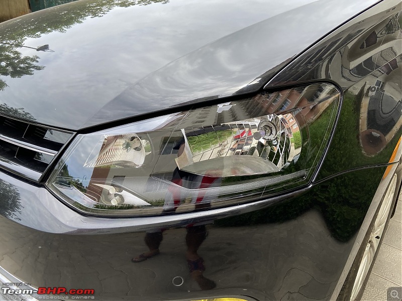

Now that a new set of stock single barrel headlamps were installed, I wanted to improve the performance of the lighting. The cheapest way to do this would be to install a good quality relay harness and 90/100W bulbs. 100/130W would be an overkill and there’s a likelihood of the reflectors going bad over time. The usual contenders for the relay harness were Philips and Hella. There was an Indian company which went by the name Thimson based out of Mysore. Their harness had very good reviews on Amazon! I decided to try my luck with this one. The quality of the cables (Finolex grade with varying gauges), ceramic bulb holders, plastic holders for the fuses, corrugated tubing, heatshrink sleeves was very good. Have to see how well the relay holds up over the years.
VW Polo GT TDI ownership log EDIT: 9 years and 178,000 km later...-6.jpg
VW Polo GT TDI ownership log EDIT: 9 years and 178,000 km later...-10.jpg
As for bulbs, I picked up a pair of Osram All Season 90/100W bulbs. These seem to have good reviews on Amazon. The HIDs on my previous setup had Osram D2S 35W bulbs and they worked well so that sort of bolstered the faith in Osram once more. Bonus – the bulbs were made in Germany! Come on, don’t we all love car parts made in the Europe? On Amazon, some folks have super high expectations from the product anyway and tend to leave negative reviews. I wasn’t swayed by those anyway and went ahead with the Osram.

Scissor jack:
VW had bundled this tire jack (not sure if they still do) with the car:
VW Polo GT TDI ownership log EDIT: 9 years and 178,000 km later...-24a.jpg
In VW communities and fora, it is also referred to as the widowmaker jack due to the accidents users have faced while jacking up their cars. A classic case of a German, over-engineered product! Ever since I’ve shifted the heavy 3-ton hydraulic jack back to my hometown, I wanted something easier and user-friendly to jack the car for doing the services and odd jobs. I bought this screw jack with the handle from Boodmo which is bundled with many Maruti cars:
VW Polo GT TDI ownership log EDIT: 9 years and 178,000 km later...-25.jpg
Simple, works well and is cheap at Rs. 680. Part number for the jack is 89910M75J00 and for the handle is 09824M00017.

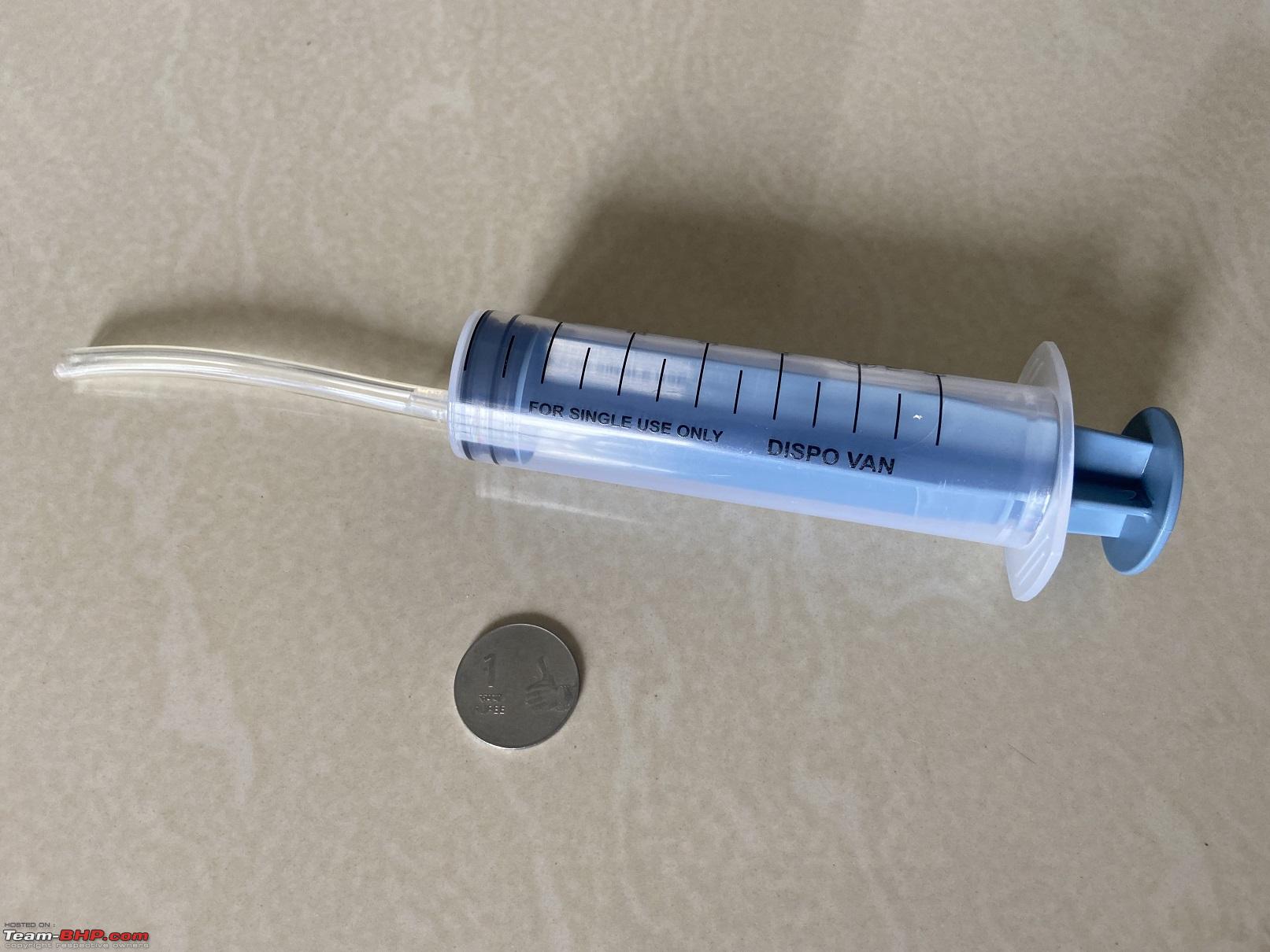

Syringe:
When I changed the brake pads last time, there’s a step which involves pushing the pistons on both the calipers to fit the new pads. At this point, some brake fluid overflowed from the inlet of the reservoir. Since I have to remove the rotors for skimming, I’ll end up facing the same situation. I sourced this 50 mL syringe (looks scary!) to suck some fluid from the reservoir before attempting the job. Got this from the Apollo247 app for Rs 42, delivered the same day. Wasn’t available at the local pharmacy outlet (1 Re. coin for reference).
VW Polo GT TDI ownership log EDIT: 9 years and 178,000 km later...-27.jpg

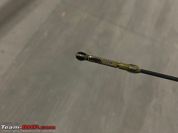

Topping up Engine Oil:
If you own a VAG car, you know it is customary to check the engine oil levels from time to time. I measured the engine oil level recently and found it to be on the lower side.
Topped it up with the leftover quantity from the 1 litre bottle of Shell Helix Ultra 5W40. This should do until the next service, which is due this August.

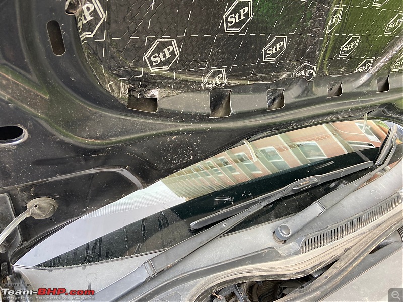

Replacing the front windshield wash tubing:
While using the front windshield wash, some water used to trickle down the bonnet and through the front grill. The spray was also ineffective. Check out these clips:
https://youtu.be/P7Dpf2qm-ao
https://youtu.be/5sWyWOTlmZ0
If the car was being driven, the stray water leaked from the bonnet would spray onto the windshield. This was irritating and embarrassing! I would be engaging the wiper continuously on a bright sunny day until all the stray water was cleared. Clearly there was a leak somewhere in the line inside the bonnet. The last lockdown was the perfect time to fix these minor niggles.
I removed the nozzles from the bonnet and figured out the leak on the co-driver side elbow which connects the nozzle with the stock corrugated tubing. The elbow has a locking mechanism which holds the nozzle in place – undo the black tab and the nozzle comes off.
VW Polo GT TDI ownership log EDIT: 9 years and 178,000 km later...-1a.jpg
You can see the scales and deposits from the water on the left one. The co-driver side elbow was much cleaner in comparison and there was no leak. To reconfirm the leak, I tested this elbow at home by connecting it to a 1/4" RO tube outlet stupid: and indeed it leaked:
VW Polo GT TDI ownership log EDIT: 9 years and 178,000 km later...-2a.jpg
Searched for a replacement elbow from VW’s parts catalog online and it was retailing at Rs 275 per unit (from (Boodmo; no one seems to have ordered this part before as Boodmo shows the snaps of the part on its link if it has been ordered before by a customer) and there were 3 units in this system (one at the pump and one for each nozzle). Part no. 16 in the image below:
VW Polo GT TDI ownership log EDIT: 9 years and 178,000 km later...-3.png
This somehow didn’t make sense as it was prone to leakage later. Plus, the car was close to 8 years old. I decided to replace the entire front windshield wash tubing for good. From the reservoir to the nozzles but with no unwanted parts like these elbows. It did seem like a bit of an over-engineered part to me.

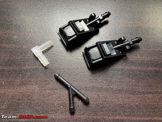

Ordered the replacement tubing from Boodmo but opted for a Toyota branded tubing! What do they say? Toyota = reliability? Can this VW have some Toyota love please? :D Although this isn't the first time, a Toyota part is used in the car though. A Toyota check valve (non-return valve) was installed in the same system sometime back (post from the ownership thread; scroll down a bit). Going by the parts catalog, this tubing is used in a lot of Toyota and Lexus vehicles – Corolla, Fortuner, Land Cruisers, Prius, Camry, Highlander, FJ Cruiser etc.
While at it, I also ordered a pair of new nozzles from Boodmo along with a Y connector to split the main outlet tubing. Cheap anyway. I am a big fan of Boodmo now! I spend a lot of time scouring through their parts for sale, get some info on the part costs, zoom into the pics of the random parts, packaging stickers and get info on the country of origin, batch, year of manufacture etc. Some weird pastime if you ask me!
The Toyota tubing, 3 ft x 2 nos.:
VW Polo GT TDI ownership log EDIT: 9 years and 178,000 km later...-4a.jpg
VW Polo GT TDI ownership log EDIT: 9 years and 178,000 km later...-5a.jpg
The new nozzles, Y-connector (from Hyundai! Because Maruti had a cheaper part but the cost of shipping was exorbitant!) and a 90-degree elbow (from Aliexpress which was sourced long back for some odd DIY):

The stock nozzles and the replacements:
VW Polo GT TDI ownership log EDIT: 9 years and 178,000 km later...-15.jpg
Inserted the tubing into both the nozzles:

To access the wash fluid reservoir, the driver side wheel has to be removed and part of the wheel-well liner has to be removed. Removing the wheel is a pain! Luckily, the lug wrench extension pipe helped. The stock piping was removed from the pump. It has the same elbow at the end with the lock. Inserted the new tubing into the outlet of the pump, connected the check valve and the other end from the tubing to the check valve:
VW Polo GT TDI ownership log EDIT: 9 years and 178,000 km later...-21.jpg
VW Polo GT TDI ownership log EDIT: 9 years and 178,000 km later...-22.jpg
That completes the whole process. Front windshield wash system restoration partly brought to you by Toyota! A VW-Toyota partnership.
Is there any way I can reuse the bi-xenon headlight assembly? Yes, with a new ballast unit. I’ll save it for later in case I change my mind. Unlikely but still an option. The headlight assembles were safely packed in the boxes. Never going to part with those and maybe, just maybe, I will fix them up some day. :’)
So what next? I had to invest in a new set of headlamps.
