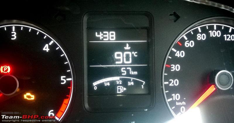

I have a question regarding the GTI instrument cluster: How did you interface it with the car, since it has an analogue fuel gauge whereas the Indian Polo's stock cluster has a digital fuel gauge. Also, the stock cluster does not have an engine temperature gauge whereas the GTI does. Is it simply plug-and-play or is some additional coding or wiring required?
Originally Posted by TheGearBox
(Post 4891160)
I have a question regarding the GTI instrument cluster: How did you interface it with the car, since it has an analogue fuel gauge whereas the Indian Polo's stock cluster has a digital fuel gauge. |
Analog or digital displays on the cluster doesn't matter. The fuel gauge sender outputs the info to the cluster and the cluster displays it. Fuel levels are calculated on the basis of resistance; higher the fuel in the tank, lesser the resistance and conversely, if the tank is empty, you'll get a high resistance reading. Since the GTI has the same tank capacity at 45L, I did not have to do any calibrations using VCDS. Since the Vento has a larger fuel tank, the fuel gauge may not accurately display the fuel level unless it is calibrated.
(Post 4891160)
Also, the stock cluster does not have an engine temperature gauge whereas the GTI does. |
Correct but the coolant temperature is sensor is present in the circuit which monitors the temperature. In the pre-facelift cars with the red backlit MID, there was a high coolant temperature warning on the cluster but no coolant temperature info. In the facelift cars which came with the white backlit MID, there is a coolant temperature info on the MID if you cycle through the options.
(Post 4891160)
Is it simply plug-and-play or is some additional coding or wiring required? |
Plug and play. Additional wiring was required for the pre-facelift cars since there was no coolant level sensor in the coolant expansion tank. The facelift cars have the level sensor.
Originally Posted by Gannu_1
(Post 4891247)
In the pre-facelift cars with the red backlit MID, there was a high coolant temperature warning on the cluster but no coolant temperature info. |
I see. I have a Polo 1.6 MPI (with the red MID) and I've (thankfully) never encountered this warning, so I had no idea about it.
