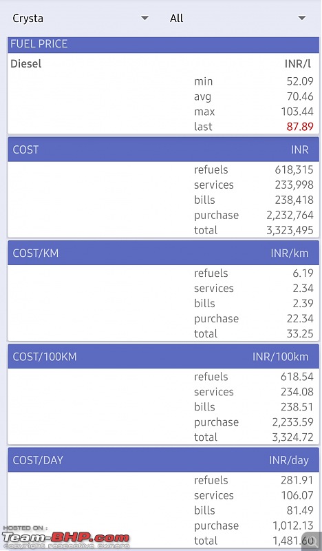

Ownership costs
Toyota Innova Crysta ownership report. EDIT: Engine replaced (page 9)-screenshot_20220708142225_my-cars.jpg
Toyota Innova Crysta ownership report. EDIT: Engine replaced (page 9)-screenshot_20220708133909_my-cars.jpg
Toyota Innova Crysta ownership report. EDIT: Engine replaced (page 9)-screenshot_20220708133914_my-cars.jpg

On the whole, I would give it a 6.5 out of 10
This is on the same scale as used for the earlier Innova, which I had for 10 years and 250k km, which I would rate a 10/10.
I paid 9.75 lacs for that. This, I paid 24 lacs
Other than regular maintenance & fuel I spent nothing else on that car. In this I have had issues, both major and minor.
