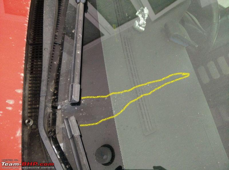

On the topic of wipers, its sad to see bosch and hella all get wiper sizes wrong for our cars.
As per bosch catalog :
In reality, you need 24/18 wipers. Or 24/19.
Even with 24/18, There was a small triangle left out between the blades that would irritate me every time I used the wipers.
Used scales and apiece of cable tie to check what size wipers will I need to ensure no triangle.
Turns out I need 26/18. I wanted to push my luck and see if 26/19 would work. I don't want to buy expensive wipers like Clear Advantage without knowing for sure they'd work or not - solution came with Amazon; there was a sale on wipers that day, frameless 26/19 wipers for XUV5OO were Rs 184 shipped!

First tried just the driver side wiper. This is how it looks with 26/18. Looks like it might get the job done.
What about 26/19?
Does it work? Oh yeah! No more irritating triangle!
I'll keep these cheap wipers till they start to streak. Once they do, will switch to Bosch Clear Advantages of the same size.

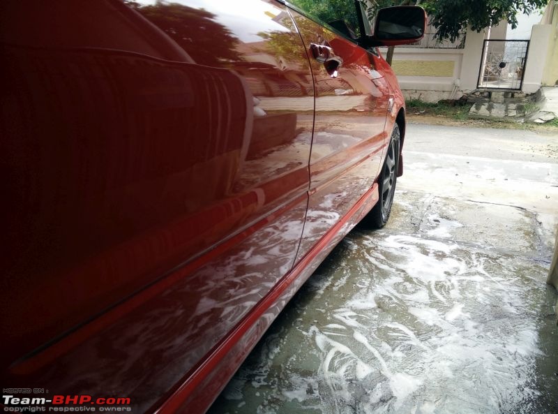

For the festivities this week, pampered my car and bikes for some snowfoam action!
Car looks good despite 1 year and 4 months of previous detailing.
