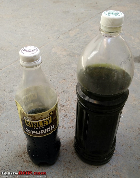

Changed Brake/Clutch fluid via pressure bleeding.
Old brake fluid. It was murky with lot of suspended particles. Brake fluid used was Petronas Tutela Top 4.

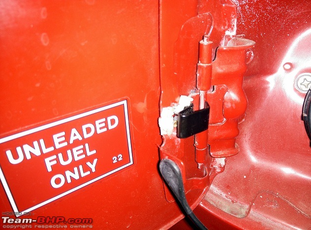

Broken fuel lid spring fixed with cable ties

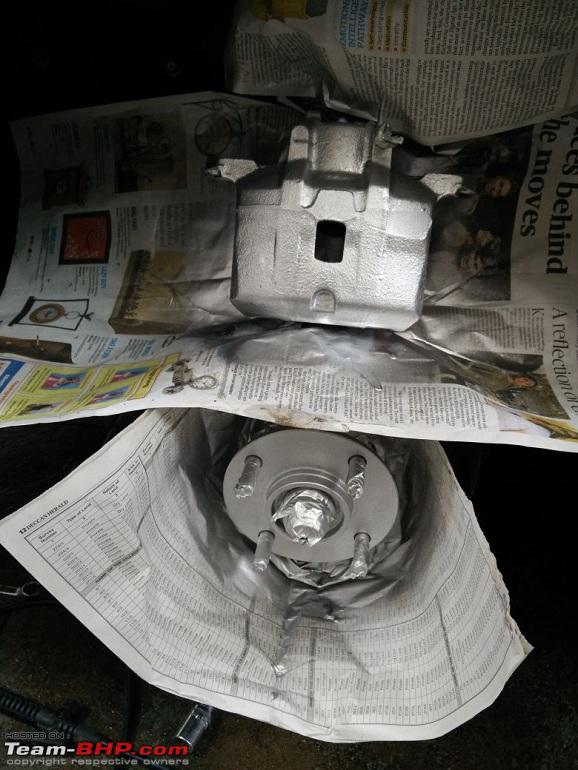

Carrier and rear of the rotor painted and left to dry
Caliper and hub painted too
