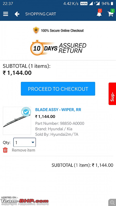

>>> Rear Wiper Replacement - Jugaad!!
The rear wiper blade was beginning to show it's age and wasn't wiping correctly so decided to replace it.
Checked the price for the rear wiper blade @ Boodmo and wasn't happy to see the pricing of it. Ditched the idea of replacement.:Frustrati
Hyundai Creta 1.6L CRDi SX(O) - An Ownership Log - Update: 1,00,000 km up!-screenshot_20190701223729.jpg
Thanks to BHPian interc00led, he got a nice idea for jugaad to replace the blade only of the rear wiper. As I had recently changed the front wipers from Bosch ECO to DHC frameless ones, I had the Bosch wipers (16") lying in the boot.
Opened the rear wiper arm, removed the rubber blade from that plastic housing and the same time opened the rubber blade from the Bosch wiper's metal housing and cut it to the same size as the OEM rear wiper blade and re-fit the same into the plastic housing of the rear wiper.
All is good and saved around ₹1,100. The rear wiper is 12" so from here on will buy a 12" regular wiper and fit the same into the rear wiper arm by opening it.
That's quite a steep price tag for just a wiper blade, it just doesn't make sense to pay that much for a rear wiper blade. However, I got mine replaced a few days ago on our 2015 Hyundai Elite i20 with a genuine one and I paid just INR 189 excluding Labour Charge:). I don't understand why this much difference is there when the rear blades of both the cars just look the same (don't know precisely about their sizes though).
