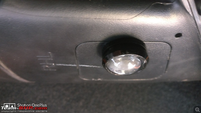

MODIFICATION #27: Puddle Lamps
Been thinking of doing this modification since long and finally, it did happen.
Ordered the Puddle Lamps along with the Anti-glare ORVM and both were delivered the same day. We did perform 50% of the DIY day before yesterday but didn't update the thread as I didn't have the videos and a few images. Thanks to BHPian interc00led who did accompany me on this DIY and also we did the same on his Fiesta too so it was a simultaneous job. :D
Plus half of the wiring related job was done when Footwell Lighting was done so this MOD was more or less easy.

After the hole was drilled, Puddle lamp fixed and how it looks outside
Hyundai Creta 1.6L CRDi SX(O) - An Ownership Log - Update: 1,00,000 km up!-6.-puddle-lamp-fixed-base-cap-outside-view.jpg
Held together tight with the nut
Hyundai Creta 1.6L CRDi SX(O) - An Ownership Log - Update: 1,00,000 km up!-7.-puddle-lamp-fixed-base-cap-inside-view.jpg

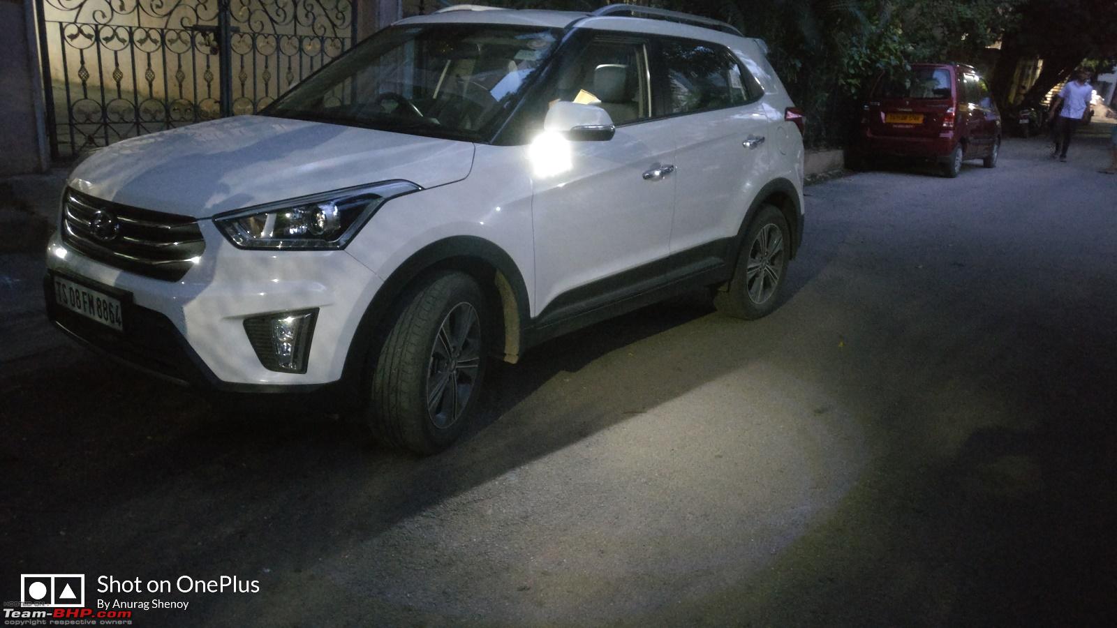

Light spread - Front 3 quarter view
Hyundai Creta 1.6L CRDi SX(O) - An Ownership Log - Update: 1,00,000 km up!-10.-light-spread-front-view.jpg
Light spread - Rear 3 quarter view
Hyundai Creta 1.6L CRDi SX(O) - An Ownership Log - Update: 1,00,000 km up!-11.-light-spread-rear-view.jpg

PS: Overall not too happy with the MOD since the lamp is too close to the door and 50% of the light is being blocked by the door itself and not reaching the floor. There is hardly any space inside the ORVM where this could be mounted and moreover, the base part is a single piece so anything goes wrong the whole unit would need a change as seen in the parts catalogue on Boodmo. Wish there was a child part for the base plastic of the ORVM and some space inside, we would have mounted it towards the outer end of the ORVM.
PPS: Shall upload better quality images and videos of the Puddle lamps functioning. It wasn't completely dark when the images and video were taken to show the lighting output.
Looks great Anurag. For the puddle lamps, you could stick a plastic part to block the light going towards the door. This would also guide more light towards the ground.
I guess you should move it out a bit further. Thanks to the curved bodyline, a lot of light is reflected back onto the ORVM itself.

Two clear images showing the light spread currently.

Visiting my FNG today for some jugaad to get the light focus more on the road than on the door.
Shall update when done.
If you open the door, the puddle light will move away with the door. That leaves the area right under the door in darkness.
Personally, i feel the puddle light is more effective when fitted under the door edge.

Hey Anurag, any update on the puddle lamps?
Were you able to solve the reflection problem?
Have you tried removing the clear lens cover that is there over the lights.
The ones that I have installed on my Ertiga have a flood type light, that is why it doesn't spread much on the body but falls completely down.
None so far. Have left it at that.
Awaiting delivery of another set of puddle lamps that I had ordered earlier and was cancelled due to shipping issues but now I see that it has been shipped (getting it at 25% price than original) so will remove the current ones and fit these when delivered.
A close friend and BHPian gave me the feedback that it is sticking out like a sore thumb which I agree hence shall get a smaller one in a size that sits slightly more flush than this. When I install these new ones, will modify in such a way that they throw light more on the road. Will keep you updated.
