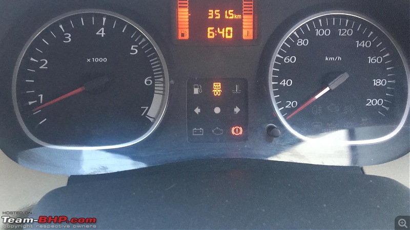

I was driving on the e-way on a Sunday and realized that I haven't given the car an Italian Tune-up in a long while. Also wanted to check whether the tyres need a balancing or not. Carefully placing myself in open sections without traffic I started gunning it. in the third pass, this happened. and I lost Cruise Control.
Was quite troubled as I didn't know what to do or why it happened. Stopped in the service lane. Shut down the car after idling for a minute. Opened the bonnet and checked the coolant flash tank which had the correct level. Checked the engine oil, which was also at the right level. Saw some oil on the intercooler which is a result of the intercooler hose design. A lot of cars have this problem and it seemed normal. Checked the air filter and it also seemed to be intact. Got back in the car and drove for another 2 hours to reach the destination. There was no difference in the way the car performed, no limp mode or abnormal noises. Just that Cruise Control was not functioning. Hence kept driving cautiously and eventually settle into the natural driving rhythm.
Before beginning the return journey, I checked the manual which said that the light was glowing Amber and there was no need to stop driving. It needs to be driven to the nearest ASC for a check-up. Couldn't do that on the way back as Renault-Etawah was closed that day. Lived with the anxiety for the next week or so and ordered a OBD-II scanner for the first time. This is the fault code summary I got off the first scan report of the vehicle.
Was able to clear the code and it hasn't showed up again. Will get it checked at the ASC in the next visit. I am guessing it is something to do with EGR or MAF sensor. The EGR valve might be needing a clean-up.

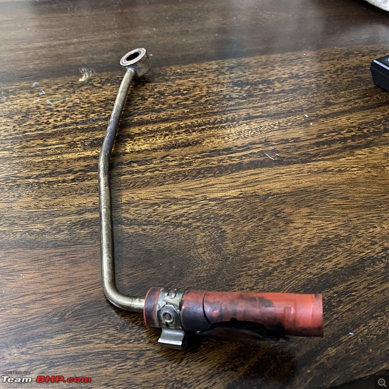

As we were approaching Bharatpur, there was a pop we heard from the engine bay and immediately after that there was a gas leak noise every time the accelerator was pressed. Stopped and checked that it was from the engine bay. Even located it to be originating from somewhere on the driver side between the engine and the firewall. I felt I could continue driving since there wasn't any warning light on the dashboard and I felt a leak is still better than some air getting sucked in the engine without passing through the filter. Was only concerned about something else getting really hot by the leaking air and hence kept the revs below 2K for the remaining journey till Agra.
Got on the Agra-Lucknow E-way and contacted Renault Etawah to intimate them to wait for me as I wanted to get it checked at an accessible town just in case I needed to leave the car, I could call a friend who would only be an hour away. The axle bind had gone for now. Drove into the service bay at 6 PM and their technician quickly poked his phone behind the engine and clicked the following picture.
Two Renault Dusters that once shared a Garage @ 3,75,000 km-ce3ee11bbab8400eaf72b53e850c0a0d.jpg
They didn't have the part required to be replaced so I had to drive back home to Auraiya. Once at ease I enquired about the part on the WA group and the Facebook group. It has been a common part that fails on the 110 PS cars. Everyone suggested to get the rubber sleeve (Red) replaced which would mean reusing the clips that hold it in place. The Service centre guys were suggesting a replacement of the whole tube + sensor as per their knowledge. I wanted a cost effective fix if the child part was available. Here's what I found out.
P/N: 223211229R - SLEEVE - EXH GAS TUB | INR 715/-
P/N: 223211824R - TUBE - EXH GAS PR | INR 1,639/-
P/N: N.A. - The tube + the sensor it leads up to. | INR 4,500/- approx.
Etawah had the Rubber sleeve in stock but were apprehensive about getting the tube to seal with the steel tube after re-using the clip. Kanpur had the rubber + steel tube in stock, which is what I went for. Got it replaced yesterday. After driving 350 odd kms below 2K rpm, gunning it on the highway after the replacement felt like I had gotten a remap.
The blown tube which was replaced.
So that's one more thing sorted leading up to the expensive 120K service which is due in 2,000 km / February 2021. It calls for replacement of the belt kits, coolant, brake fluid, EGR cleaning. I'll add the differential oil, the brake pads, wheel balancing and alignment too. Have begun saving up for it. Let's hope a wheel bearing or a sack absorber doesn't give-up in the mean time.
