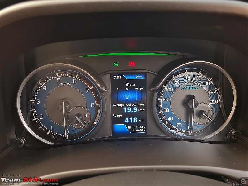

Normal life resumes for the XL6: After remaining mostly idle and barely covering 200 km in past couple of months due to illness and subsequent recovery phase, I took the car out today and did a round trip of ~270 km. Had reset the mileage figures before embarking on the journey since it was showing 13.9kmpl due to extended periods of idling in the parking.
Also, crossed 11k on the odo. This 1000 km took more than 2 months to complete. As usual, there is nothing to report and the ride is as fuss free as ever!
My first car: 2020 Maruti Suzuki XL6 Alpha MT Review-20210604_141511.jpg

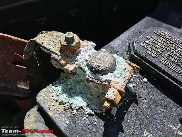

Battery terminal corrosion is a common thing over the years of a car’s life. This spray/coating acts as an inhibitor of battery terminal corrosion.
Recently, my Punto battery terminal has become like this. Pic source: Google as my car is lying at home.
Attachment 2160720
Have you over filled the distilled water by chance? That usually causes this kind of residue buildup due to corrosion.

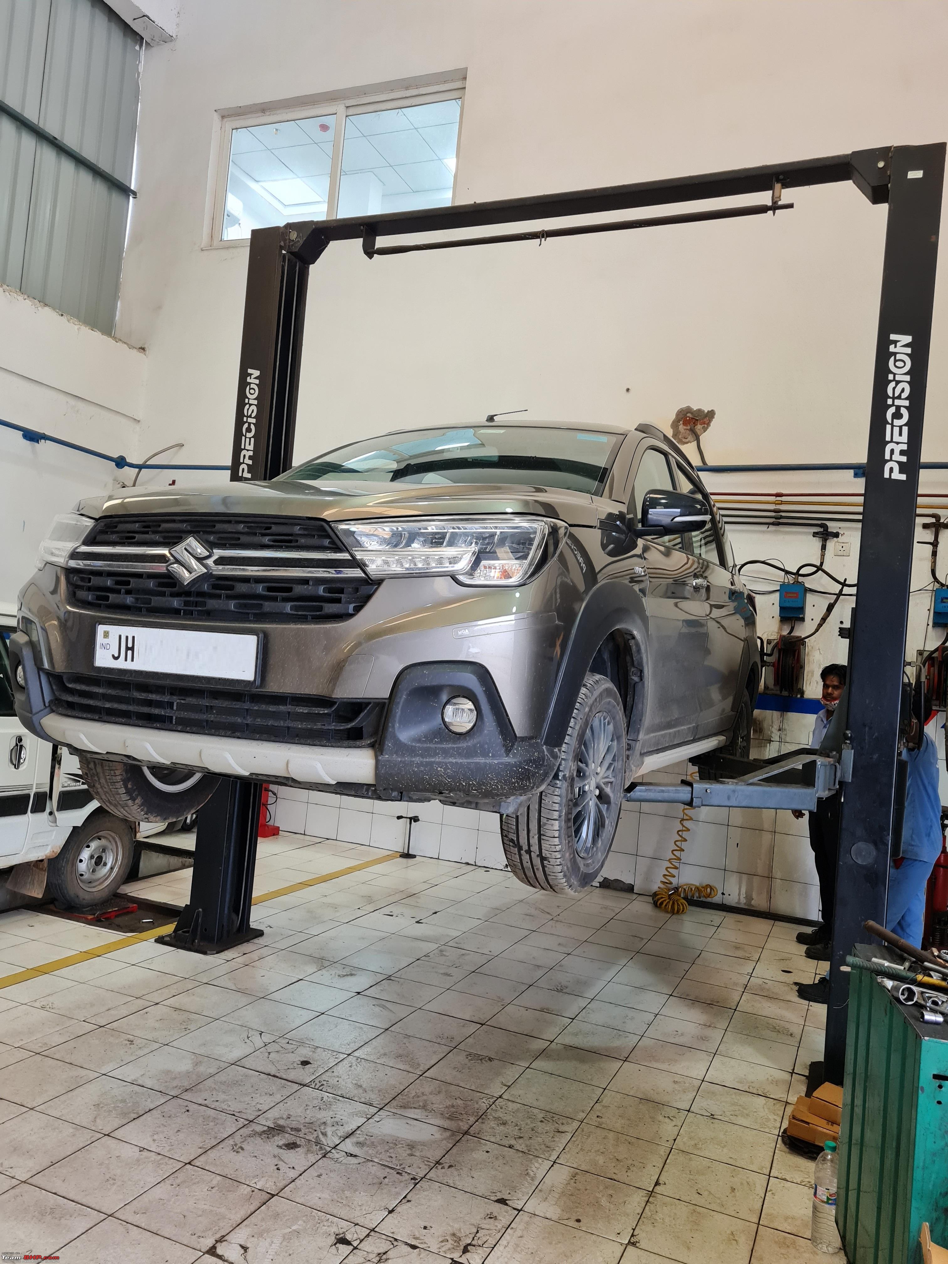

Attention all 2nd Gen Ertiga and XL6 owners: There is a recall, based on complaint, for changing rear axle. This isn't a mass recall, but only for those who have issues.
Symptoms: It isn't a mass recall, it's for those customers who face uneven wear issues on rear tyre. I know some owners who have reported this. For their case, Maruti has provided a service circular to all dealers dated 6th January 2021. There is a chassis number cutoff provided, all cars manufactured before LK(October 2020). I don't remember the exact VIN, you can get those details by getting in touch with your Workshop Manager(WM). My XL6's VIN has LF(June 2020 make) so I am eligible.
What the circular says: If there is complain of uneven tyre wear, if the car falls in the given VIN Range, they have to confirm first which part number the axle carries. If it's 46500M72R10, it has to be replaced with 46500M72R11(updated part). Again, do note that this isn't a mass recall, decision has to be taken only if your car has symptoms.
How to find the part number: They lifted my car up, and the axle carries a sticker towards the front face on the right side with barcode and last few bits. In my case it was 72R10. So it was the axle which may be faulty.
My first car: 2020 Maruti Suzuki XL6 Alpha MT Review-20210616_125116.jpg
What was done in my case: Since I rotate the wheels every 5,000 km myself, there was NO uneven wear in my case on any tyre. The WM advised not to change the axle blindly, but to observe for 10,000 kms and take a call accordingly.
I was in and out of workshop within 15 minutes:
My first car: 2020 Maruti Suzuki XL6 Alpha MT Review-20210616_124817.jpg
My first car: 2020 Maruti Suzuki XL6 Alpha MT Review-20210616_124945.jpg
My first car: 2020 Maruti Suzuki XL6 Alpha MT Review-20210616_125529.jpg
