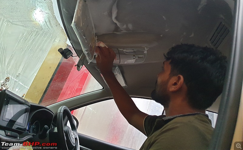

Finally, the much awaited post on Sound Insulation of my XL6. This post got delayed due to multiple reasons. Firstly my Phone got damaged and barely managed to recover the pics. Secondly, it was done in two stages. Stage I involved insulating the Doors, A Pillars and Roof. This was done last year, in August 2020 I guess. Stage II took care of Floor and Rear Quarter panels which was done in October 2021. Thus I'll be posting two back to back posts, one for each stage.
Stage I: Insulating the doors and roof.
Objectives and Problem areas:
-The Damping part will arrest the vibrations of panels, plus help in preventing dings which Maruti cars are infamous for since they provide mechanical rigidity to the panels from behind. This is why it was in first priority.
-Arresting vibrations at high volumes even with stock speakers.
-The irritating Tabla on roof during rains.
Process: Now this wasn't just going to be a mindless application of damping sheets and feeling smug about it. I also had to ensure proper waterproofing and making sure the damping sheets or insulation stuff doesn't come in contact/hold water at any location. Also, use of different materials at different places ensured optimum absorbtion of frequencies/noise/rattles. A friend who is a NVH Simulation engineer with a leading OEM was my guide, and anything done was after detailed discussion with him.

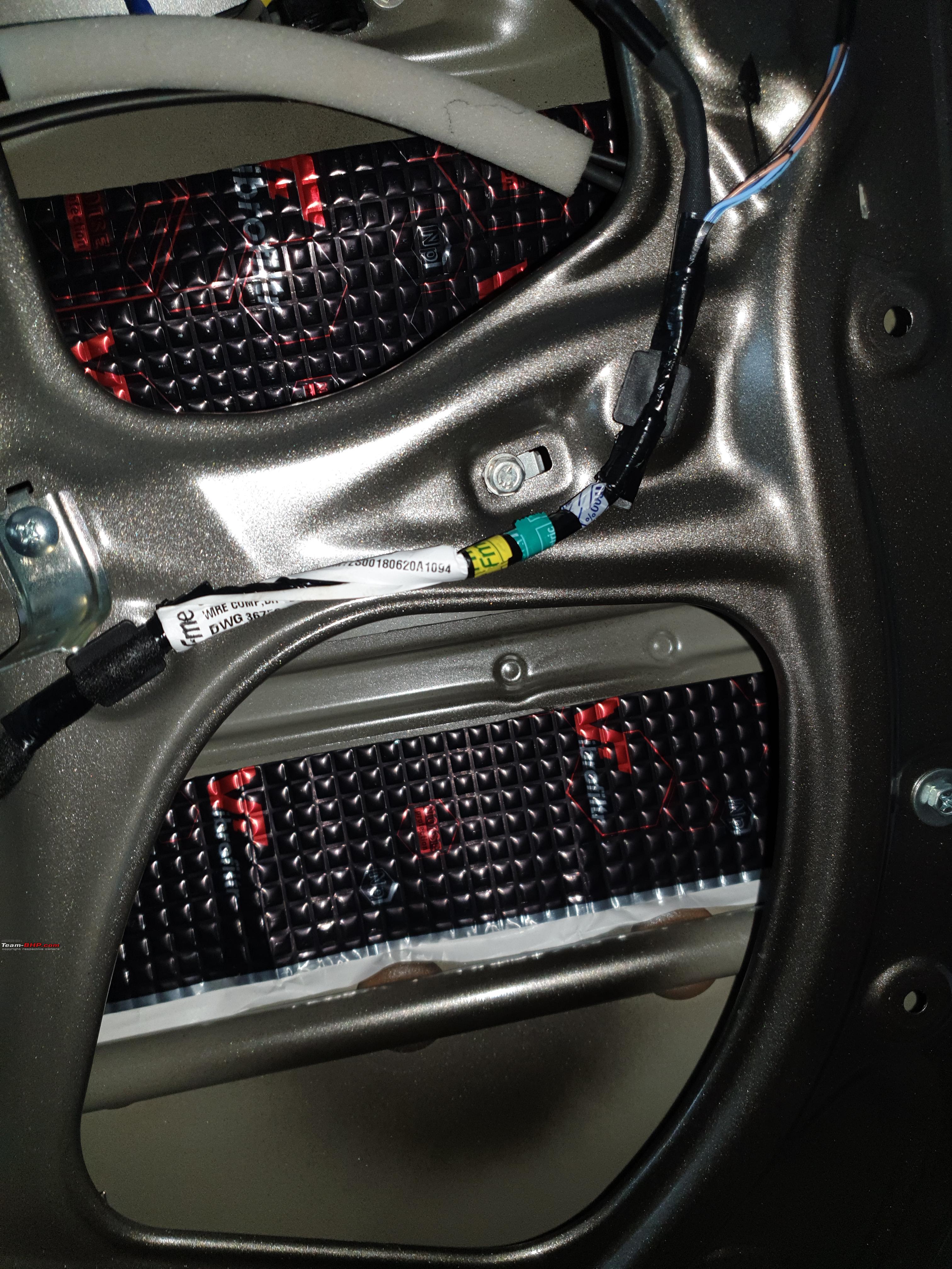

1. Alubutyl Sheets(S1): 1.8mm, Vibrofiltr Brand. I am a fan of STP and CTK brands, but this first stage was done during lockdown last year, so those brands weren't available. Vibrofiltr is also quite reputed, so opted for this. A pack was ordered which came with 15 sheets.
My first car: 2020 Maruti Suzuki XL6 Alpha MT Review-20200721_162308.jpg
My first car: 2020 Maruti Suzuki XL6 Alpha MT Review-20200721_210749.jpg
My first car: 2020 Maruti Suzuki XL6 Alpha MT Review-20200721_210953.jpg
2. Closed Cell foam loaded Alubutyl Sheets(S2): This provides weight of Alubutyl, plus has a closed cell dense foam layering on top, for excellent noise absorption. iCopper was a brand available on Amazon, ordered a pack of 5 sheets.
My first car: 2020 Maruti Suzuki XL6 Alpha MT Review-20200723_140617.jpg
My first car: 2020 Maruti Suzuki XL6 Alpha MT Review-20200723_140643.jpg

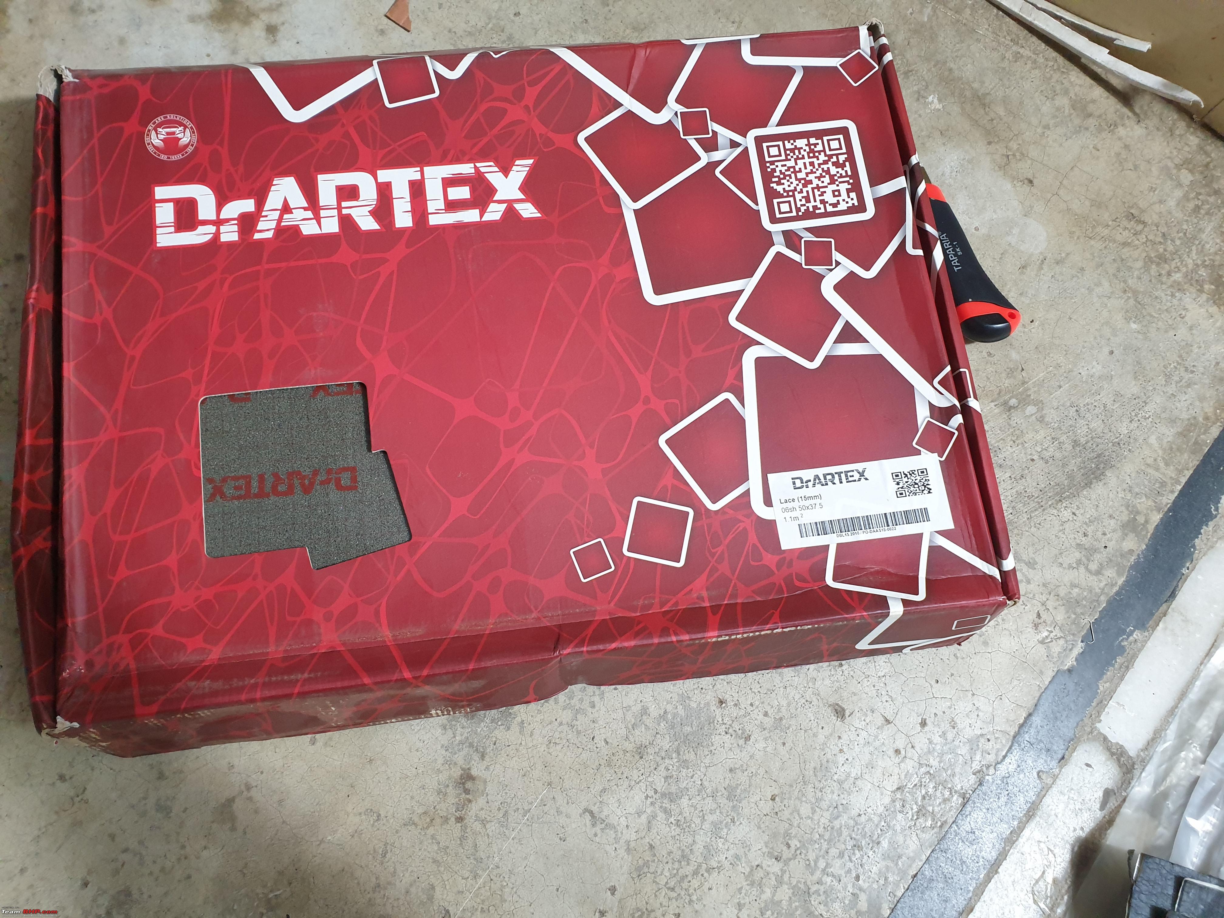

3. Dr. Artex Lace(S3): This is a sound absorbing open cell foam, which can be easily compressed and being flexible, can be used on any type of contoured surface. Ordered 10 Sheets.
My first car: 2020 Maruti Suzuki XL6 Alpha MT Review-20200805_124751.jpg
My first car: 2020 Maruti Suzuki XL6 Alpha MT Review-20200805_124820.jpg
My first car: 2020 Maruti Suzuki XL6 Alpha MT Review-dra_base_lace_8__78997.1537331822.1280.1280.jpg
4. Dr. Artex Baffle Plus(S4): While this is a good sound insulator, it excels in heat insulation too. Ordered 4 Sheets.

Tackling the doors: We divide the door into three parts. 1. Inner part of outer skin. 2. Outer part of Inner skin 3. Door pad
1. Inner part of Outer skin:
-We first cleaned the door's inner section with IPA to remove any dust and wax/oil.
-Pasted the 3M stiffeners(S5) at regular intervals.
My first car: 2020 Maruti Suzuki XL6 Alpha MT Review-20200902_200542.jpg
-Pasted strips of Alubutyl Sheet S1, ensuring zero overlap or pocket formation where water can sit. Do note that water flows from inside, so there shouldn't be any hindrance to that movement. This was rolled down aggressively with a roller to ensure maximum adhesion.
My first car: 2020 Maruti Suzuki XL6 Alpha MT Review-20200901_200016.jpg
-Sprayed Hinge Wax all around the lip of these sheets. This makes the surroundings water proof, once the wax solidifies. This becomes equal to the hot wax which is applied from factory.
My first car: 2020 Maruti Suzuki XL6 Alpha MT Review-20200901_202104.jpg

After this DIY, got the roof liner thoroughly cleaned at 3M Ranchi
My first car: 2020 Maruti Suzuki XL6 Alpha MT Review-20200907_154917.jpg
