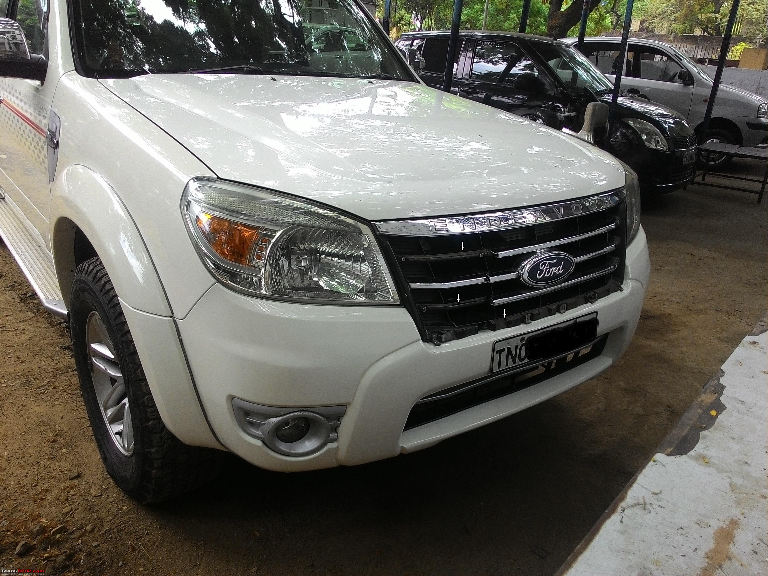

That was the time this stretch of road at Teynampet just ahead of the Gemini flyover in Chennai was partly closed for the Metro work and temporary concrete separators had been placed to separate the up and down traffic. My friend did not notice a separator at a curve, and ended up ramming the Endeavour into one such separator. The front beam took the hit. The impact "t-boned" the grille and the bumper (which also flared wide open at both ends) but nothing happened to the intercooler, radiator and AC condenser.
On enquiry at Ford, the grille was quoted at INR 35,000 and my friend did have the option of claiming insurance. I, however, stepped in and told him that even if he claimed insurance, he would get only 50% of the cost of the grille covered. I asked that I try something novel out to which he agreed.
The damaged grille was straightened and the beam repaired at the paint workshop. The front bumper was also heated back to shape and re-painted. This cost INR 15,000. Now it was time to figure out something for the grille. It suddenly dawned on me that the broken chrome on the Endeavour grille was all that needed to be filled, and while examining options like the Celerio grille for the chrome bits, I realized that the Indica bonnet lip would be a good fit.
