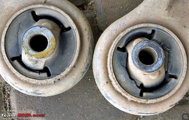

Asked them to check the lower arm bushes again, it has been almost 10K since the last check where the cracks were discovered. The left lower arm bush is now properly cracked, while the crack in the right one is still manageable. The SA showed it to the DGM and he suggested to replace it. So I have put an order for a new lower left arm.

Replace both arms instead of only one.

Hmm, I guess you are right. The SA was trying to save me some money, but he is only postponing the expense.

@160000kms and after two trips of Rann the left track control arm starting making wee bit of noise again. This would be the second arm that's is going bust.

I think you will hit 200K before I reach 50k. Just got a call from the SA again, the lower arms have arrived, again. Hopefully this one is for the GV. But I am in Bangalore, it will be another 800-1000kms before I can take it to the workshop.
Today the GV was picked up from my office by Abharan motors at 11:30AM and delivered back by 4:30PM. Both the lower arms, 4 spark plugs and the air filter was replaced. All these parts were not available in stock during the last service.
Each lower arm cost me Rs.6411/- and the total bill today came to Rs.17,244/-
I really wanted to look at the condition of the arm bushes, but they haven't sent it. I asked them to send it tomorrow.
When you get them share the pics please. Usually it is the embedded/moulded rubber bush on the chassis side of the arm that wears off.
The parts were delivered by the dealer to my office two days later. Today I got down to looking at them.
The lower arms.
Closer look. The bush is cracked in one, totally broken in the other.
I have been driving around with cracked lower arm bushes since August 2010, when it was discovered. That was 10 months and 10K kms back.

And I have been driving with totally broken left lower arm bush since 50 days and 1000kms while waiting for the parts. Never felt any diminished handling or suspension action. After replacement the minor sound has vanished and I feel a little more spring in the suspension action.
