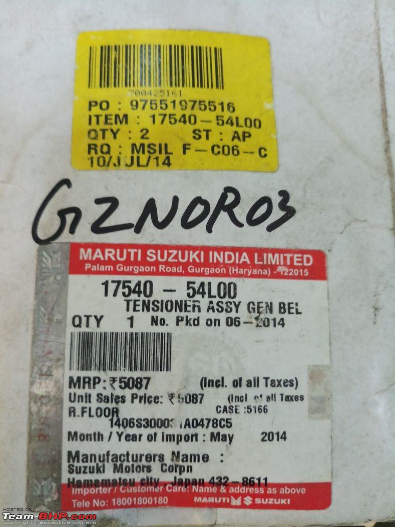

So the pulley is becoming a complicated find. The part which was available in other dealership is also same as the wrong part we found. The pulley wheel is large sized which would not fit. Similarly there is a difference in the body also.
This is what we need for 2.4L AT engine, i can see this in ebay et all. Funny thing, it is same part number. Smaller dia pulley with tapered insides, and that black hook thingie on the side.
Any leads on local procurement would be appreciated.
A quick search on Parrsouq threw up a part no as: 17540-54L01.
The corresponding belt no. is 17521-54L31.
Your photo is for part no 17540-54L00. So maybe a search with the new number may help.

Trying all permutations and combinations but the correct part number from maruti software Vs real part is a mismatch.
17540-54L00-RX0
# 17540-54L00
#17540-78K00
#17540-54L00-000
All these are same part as per another site :Frustrati The diameter difference is about 1/2 inch.
