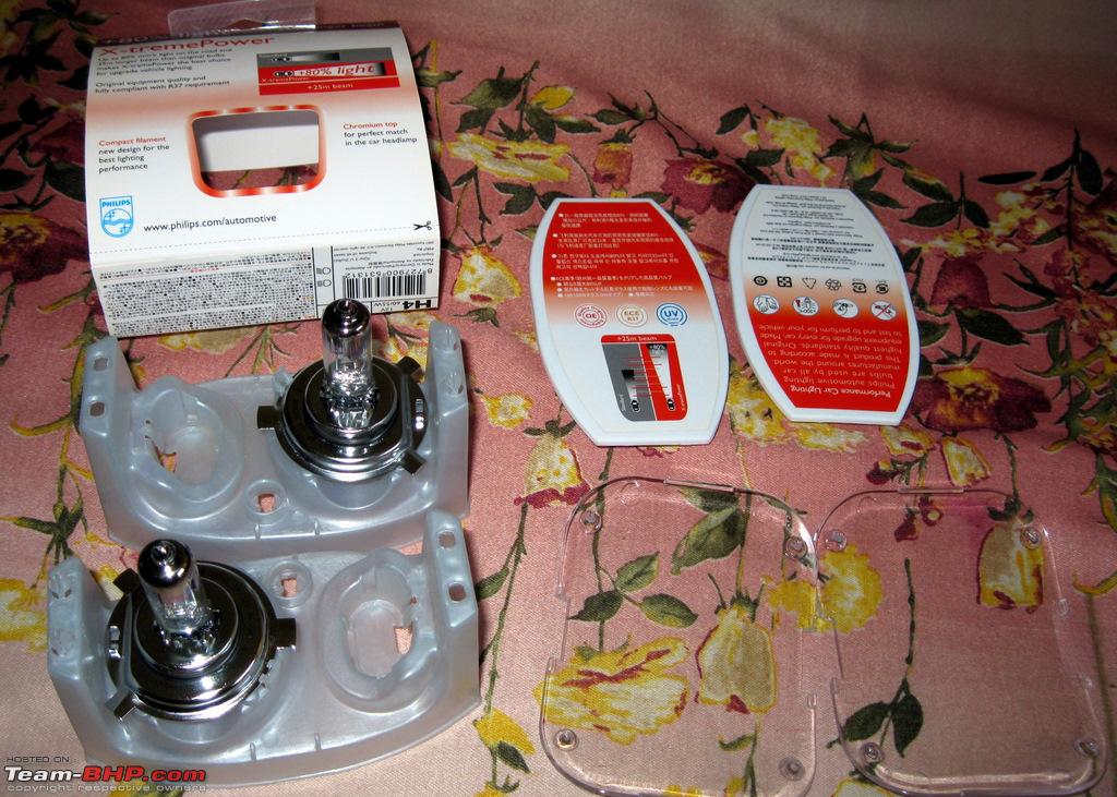

Headlight upgrade
Replaced the stock headlamp w/ Philps XP today. Managed to procure a pair for 900/- (poor bargaining skills ) .
The itch was to DIY. Opened the hood and inspected the area. Read the manual and referred to Dadu's post on HL leveling twice, after that, mustered enough courage to pry out the "seal" with a screw driver. Once the back cover was removed- picture was clear. It is a very easy mechanism and replacing both bulbs took less than 10 minutes. Just press the base of the bulb with one hand and use other to pull out the cable socket/grommet. Then remove the "spring" like tiny wire- which holds the bulb base back to the reflector assembly- and take out the bulb holding at the base. Take care not to touch the glass shell. Reverse steps for putting back new bulbs. Good design Tata . Found that stock lamps too were Philips.
Went for a drive to Sunny's on NH4 in the evening. Pleased with low beam visibility. High beam has also improved. Overall very satisfied with the upgrade. Just a bit of anxiety though- I have removed those green "sealed" stickers from both the covers- hope it doesn't tick off TASS.
Posting some pics below.
