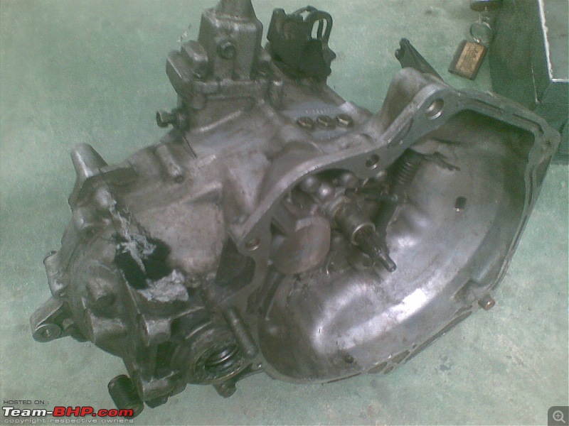

Got a JDM Suzuki Cultus Gti close-ratio gearbox. WOW!! Bang for the buck mod is this!
Pill post some pics videos and review soon .

Here are some pics .. of the Impreza 380cc Injectors , The cultus gearbox , SGP wheel bearings.
