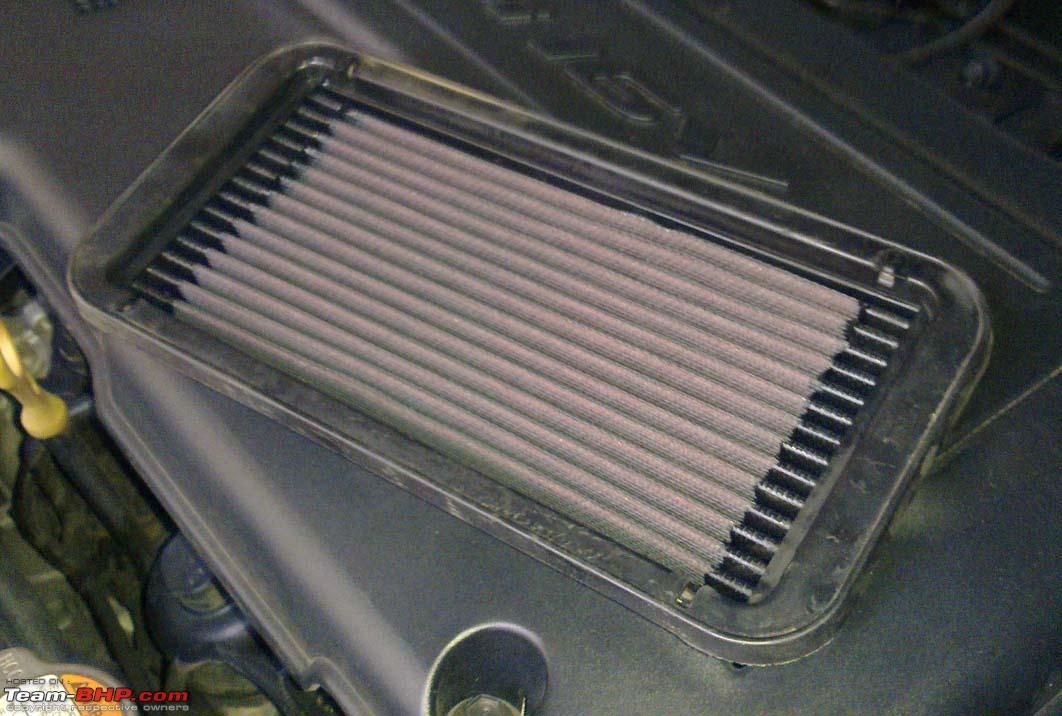

Prajesh, this one is for you :)
Though it's been about 3000 KM since I cleaned the air filter, it looks pretty much ok - guess I am not driving in that dusty an environment.
Letz Getz Started (Hyundai Getz CRDi)- UPDATE: 40000, new alloys, tires!!! (page 30)-kn-top.jpg
Letz Getz Started (Hyundai Getz CRDi)- UPDATE: 40000, new alloys, tires!!! (page 30)-kn-bottom.jpg
Letz Getz Started (Hyundai Getz CRDi)- UPDATE: 40000, new alloys, tires!!! (page 30)-kn-side-1.jpg
Letz Getz Started (Hyundai Getz CRDi)- UPDATE: 40000, new alloys, tires!!! (page 30)-kn-side-2.jpg
Thanks a ton for the pics !!
Interesting, the design of Green & K&N filter is quite different.
Wonder which design does a better job
I guess we gotta swap our air filters and see if the K&N gets as clogged as the Green Cotton for your driving condition, and if the Green Cotton is as not-so-clogged as the K&N in my driving conditions. What say?!! :)
