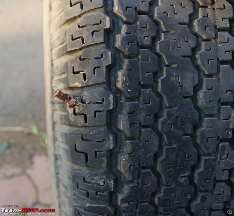

I lost 2 tyres (both OE) during this trip. The first one was at Pune. I'd run out of repair plugs, and wanted a puncture fixed, so went to a roadside tyrewallah. Rs.60 and a plug later, the tyre suddenly developed a weird bulge on one side of the tread surface.
Hawk-On-Fours® (H-4®) with a tail - Scorpio mHawk 4WD EDIT: Sold!-dsc03978k300.jpg
Hawk-On-Fours® (H-4®) with a tail - Scorpio mHawk 4WD EDIT: Sold!-dsc03984k300.jpg
Hawk-On-Fours® (H-4®) with a tail - Scorpio mHawk 4WD EDIT: Sold!-dsc03986k300.jpg
Hawk-On-Fours® (H-4®) with a tail - Scorpio mHawk 4WD EDIT: Sold!-dsc03982k300.jpg
Obviously, I'd lost this tyre. But I didn't quite understand why this happened. So I shot off an email on a Friday evening to Bridgestone Pune, asking them to help. Wonder of wonders (and I am seriously impressed with Bridgestone's customer-friendliness), I get a call on Monday morning at 9am, asking me to come over so they can take a look at what's wrong.
The issue was ply separation. The nail went in obliquely, and the fellow plugged the leak vertically. Air pressure and flexing of the shoulder, led to the air getting in between the tread and the belting, separating out the bond - and this was the result. My tyre was dated 3609, so warranty didn't apply anyway (despite a lot of tread still being there), and I bought a similar Dueler HT for Rs.7300.
The second tyre I lost was during our return journey, about an hour out of Rajkot, heading to Ahmedabad. A metal protrusion on a culvert got the rear right tyre. I noticed the metal bit and dodged, the front tyre missed, and the rear tyre deflated with a boom. It was flat in 10 seconds, but by that time the TPMS had already put up its alert, and I had pulled over and stopped - thus saving the TPMS sender unit from self-destructing.
Take a look at the hole that was punched through-and through in the middle of the tread.
Hawk-On-Fours® (H-4®) with a tail - Scorpio mHawk 4WD EDIT: Sold!-dsc00652k300.jpg
Hawk-On-Fours® (H-4®) with a tail - Scorpio mHawk 4WD EDIT: Sold!-dsc00653k300.jpg
Hawk-On-Fours® (H-4®) with a tail - Scorpio mHawk 4WD EDIT: Sold!-dsc00657k300.jpg
The nearest I could hope to find a decent tyre shop was at Ahmedabad, and I found one finally. Unfortunately, he didn't have Bridgestones in stock, but has Continental CrossContacts, Apollo Hawkz, and a new tyre I'd never heard of before - something called the Ceat Czar HT. He offered the Ceat at Rs.6000, it looked pretty okay, and Ceat is offering an unconditional replacement warranty (even due to accidental damage) up to 2-years / 50% tread wear. I didn't have the energy to hunt around for an outlet stocking Bridgestones, I had another 950 km to get home, and I did need a spare tyre for the drive through the night - it was already past 6pm at Ahmedabad.
So I am running on 3 old Dueler HTs and one brand new one, with a brand new spare Ceat Czar HT tyre now. Anybody has any idea about how good / bad the Ceat Czar HT is? Your opinions would be welcome.
