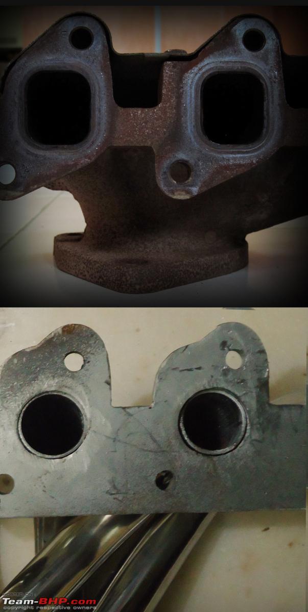

In the following pictures, the top picture is of stock one, the bottom one is AM FFE.
Building a Harder, Better, Faster Chevy Spark | Includes Automech FFE Review-dsc044591001.jpg
Stock Manifold inlets vs AM FFE Header Inlets

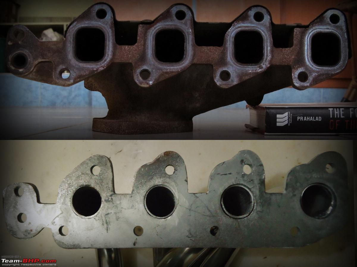

Building a Harder, Better, Faster Chevy Spark | Includes Automech FFE Review-dsc044592001.jpg
Stock Manifold inlets vs AM FFE Header Inlets(Closer Look)

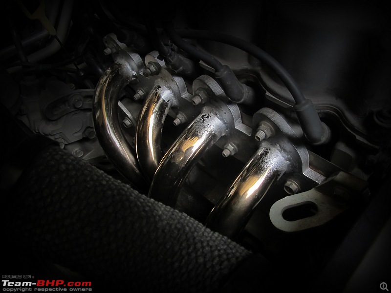

Building a Harder, Better, Faster Chevy Spark | Includes Automech FFE Review-dsc04462001.jpg
RHS View of Headers, O2 Sensor at the Right

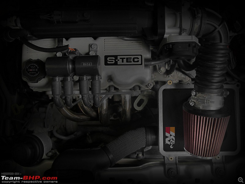

Building a Harder, Better, Faster Chevy Spark | Includes Automech FFE Review-img_1567-copy001.jpg
A very happy engine
Attachment 1106422
Attachment 1106423
Man, from the pics it looks like the exhaust ports on the head are square, but its not a problem if the round header flange entries cover the square ports. However in the photos it looks like (based on the OEM manifold entry size) the round header entries are significantly smaller than the ports. That is not ideal.
Thanks a lot man! I felt something fishy while joining that pictures, but I was in some "nasha" of the performance boost. I've put up a mail to Vivek Bhat regarding this. Hope he clarifies.:thumbs up
By the way, what if the outlet on the engine cast is circular? I hope it is!

Got a reply from automech:
Originally Posted by VivekBhat@Automech
Dear xxxxx
The diameter of the ports in the header is desgined according to the size of pipe to be used. The engine is not harmed by this factor.

Well, I asked Mr.VivekBhat on how the diameter is calculated and he said they have a formula(which he apparently cannot share) depending on Engine Displacement.
