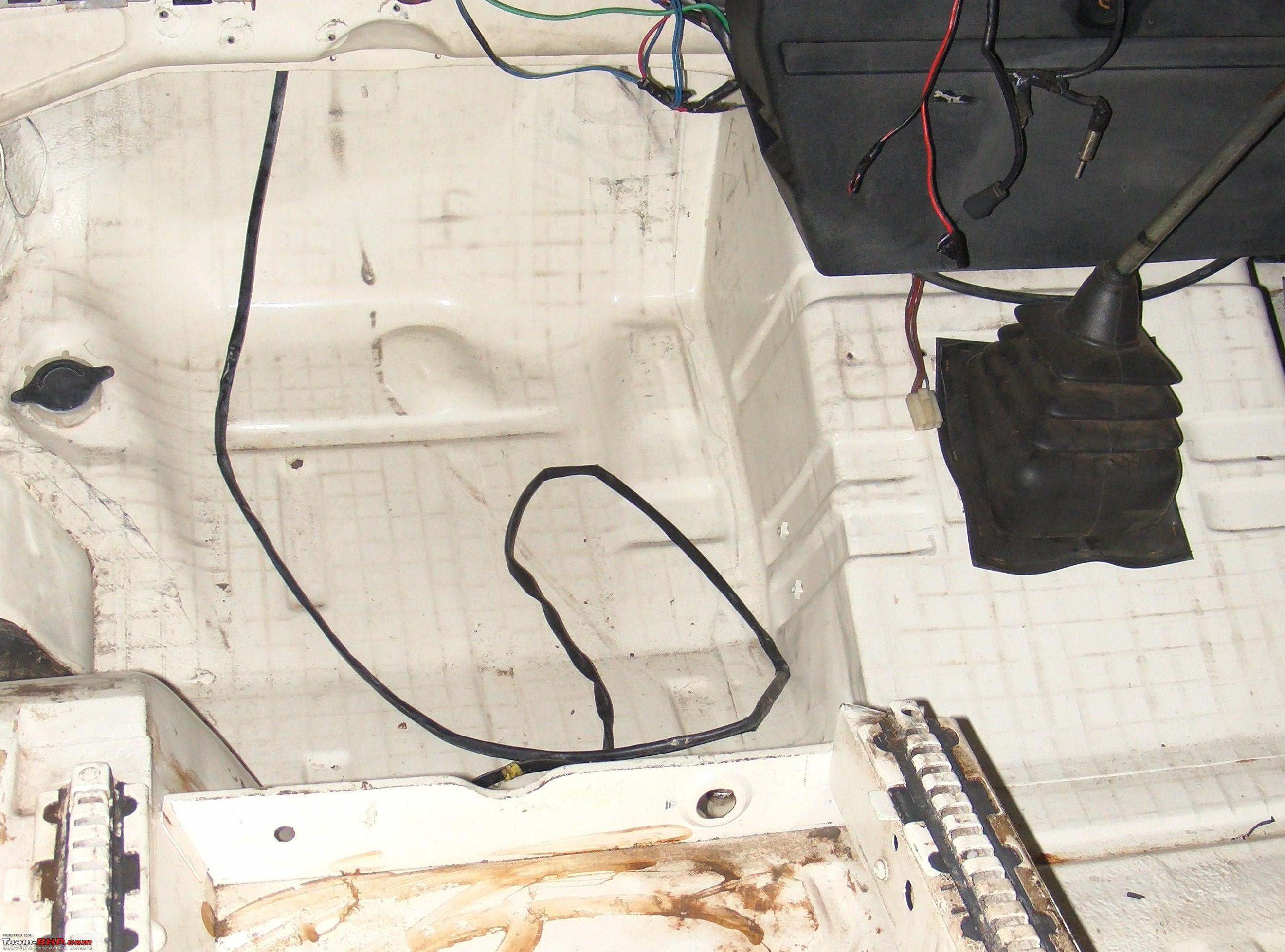

Front floor no rust.
Complete floor no rust.Brown color is sticking gum

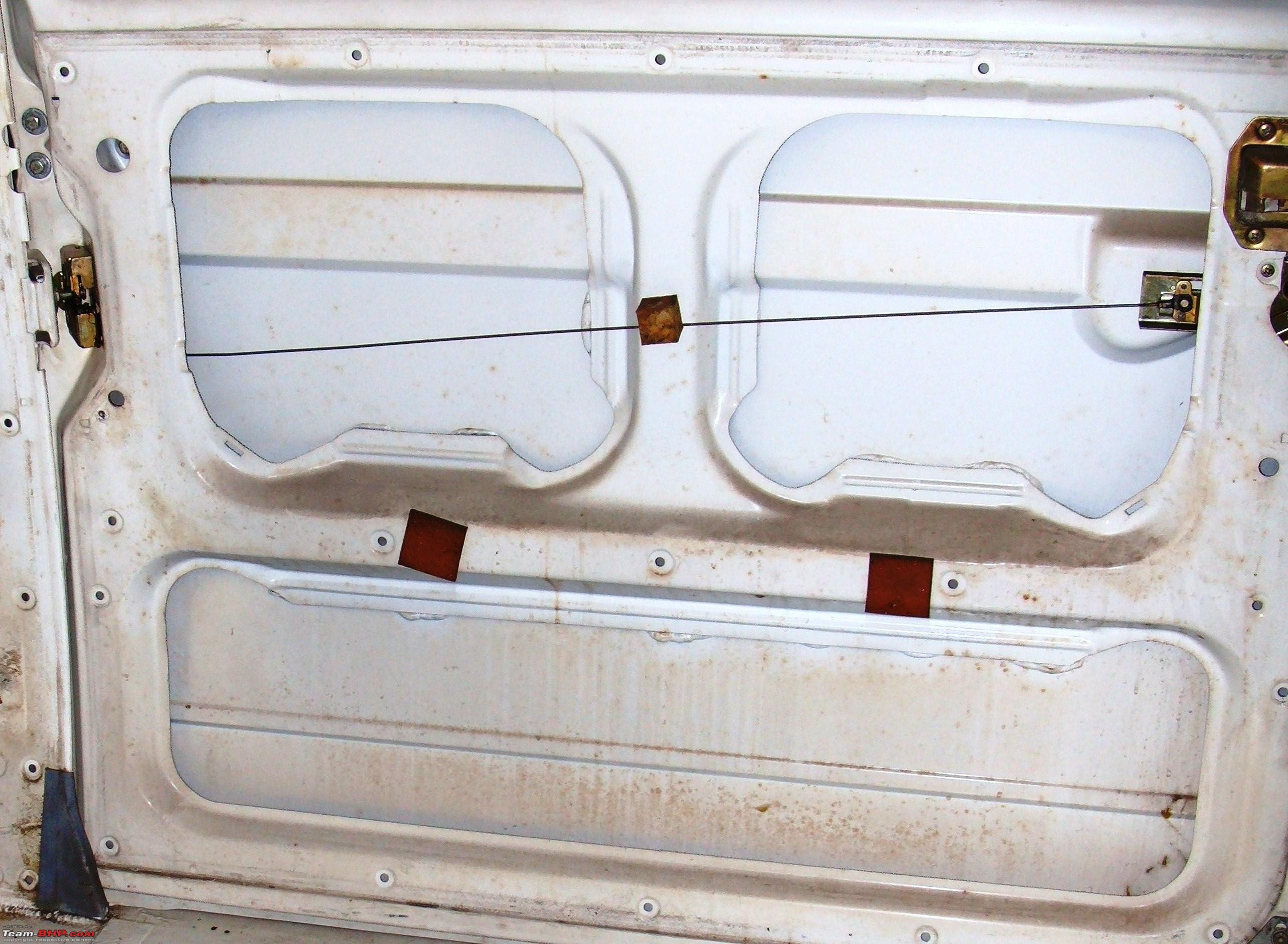

Sliding door
