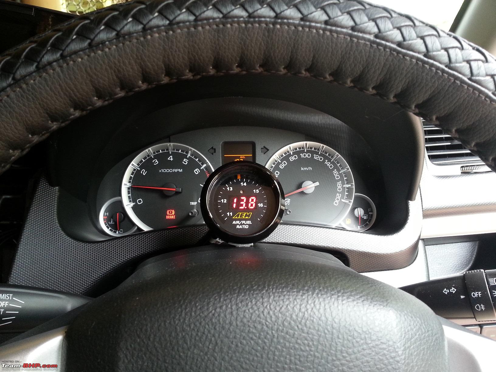

Wideband install:
Today I installed an AEM UEGO wideband controller gauge today. Had made the provision on the stock manifold to take an extra sensor before i got the manifold installed last week. The wideband reached me yesterday and so installed it today. The most difficult part of the install was to take the wire from the engine bay into the cabin through the main grommet in the firewall, the one behind the airbox. It was very difficult as the wire was getting blocked somewhere so took a break and but there was joy in the second attempt after lunch Once the wire came through it was really a simple job of providing ground, power and plugging in the connectors. Yet to buy a gauge pod.

Gauge. Reading- this is the first cold start of the engine after the install.
Maruti Swift "Special" - 1.4L VVT, Unichip Tuned, 112 BHP!-20131002_141601.jpg

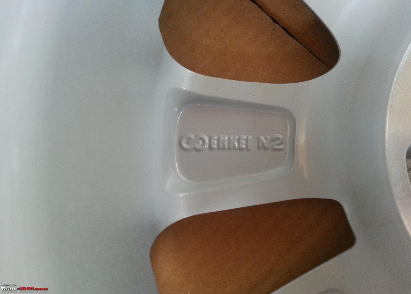

  • Bought and installed a set of Ritz ZXI's alloy wheels, noticed that these alloys are made by ENKEI. Great.
