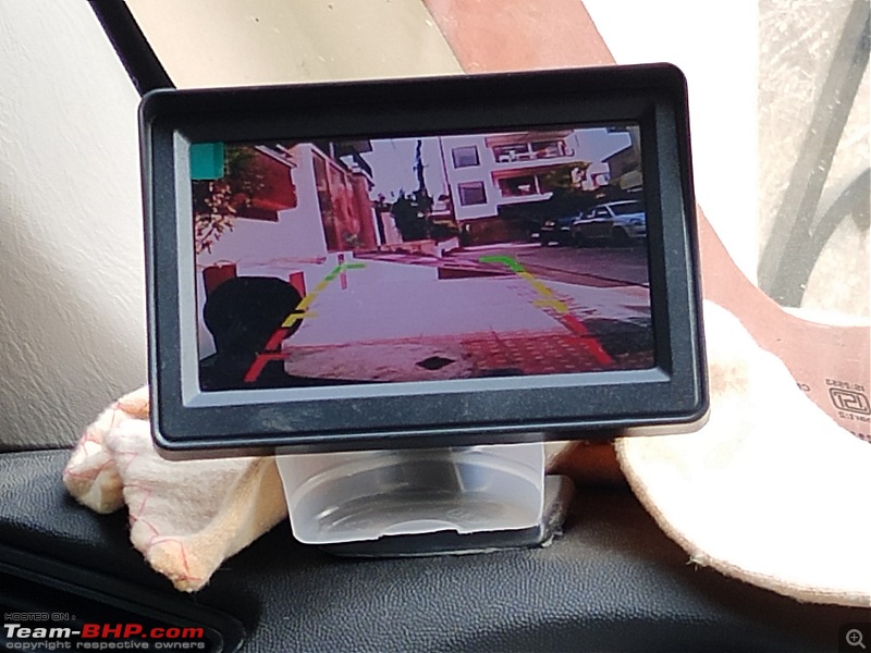

Here are the pics:
The display mounted on the left hand side of the Dashboard with 3M double sided tape. The pic also shows the rear view. The display can be adjusted vertically but the screw tends to get loose. So, I put a plastic stopper for that.

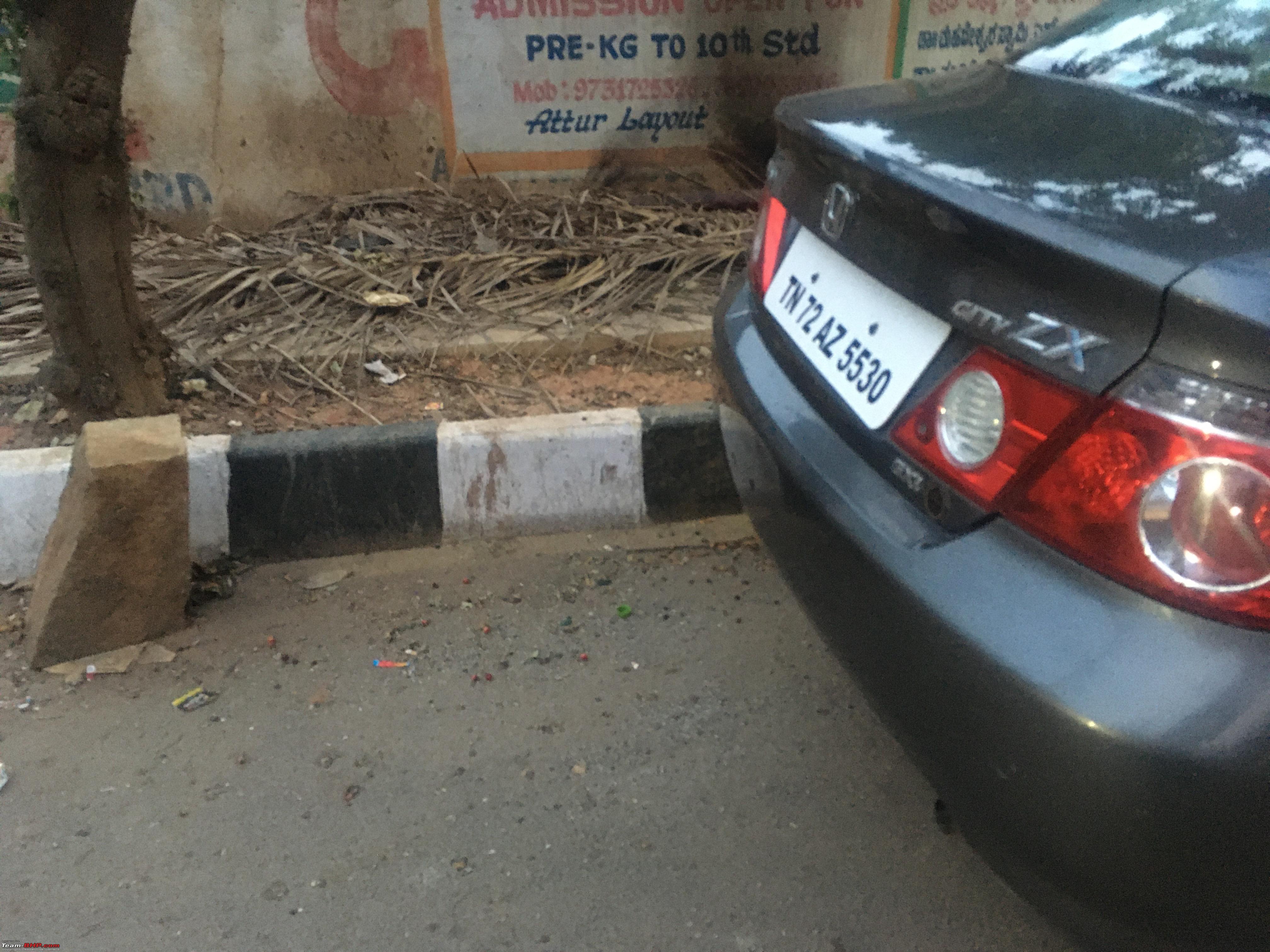

One issue with the bumper camera that I have installed is that it gives a very zoomed in picture. In the images below, The stone which is in the edge of the camera view is actually 5 feet behind. Is there any adjustment or is it a fault of the camera?
The reversing camera & parking sensor thread-4d63f337d3cb4cc885601fb15807e5ec.jpeg
The quality is camera is bad. Get a good quality reverse camera. Blaupunkt DH02 is very good. It's got nice wide angle and good night vision as well. I am using it on my car. Get this and you will thank me later. It's well worth the premium price. All others are generic Chinese rebranded ones. I wasted my money on three of these Chinese products before I bought the Blaupunkt one. I will go further and say that this is the best aftermarket reverse camera you can get in India as of today

Yes, the wiring is the same as the other cameras. So you need to just replace the camera in the bumper and connect it to the existing harness.
From my experience, all these rebranded sub 1000 rupees chinese camera are crap. None of these are true wide angle.
myTVS rear camera are good. One of the better quality rebranded chinese ones. Even the Blaupunkt one is made in China. Quality is better and is a true wide angle. Covers almost the whole rear bumper width

My problem is that when object is closer than the red grid line, there is still 5 feet space. In a number plate camera in another car, similar view there is about 6 inches space. I hope this Zooming effect will not be there in the Balupunkt.
Also please confirm that the yellow RCA connector is compatible with the connector with 2 red wires once connected to the rear light and another in the stereo. This acts as a trigger when reverse is engaged.
No zooming effect on the Blaupunkt. It is like a fisheye lens
Yes, your connection works with this camera as well
