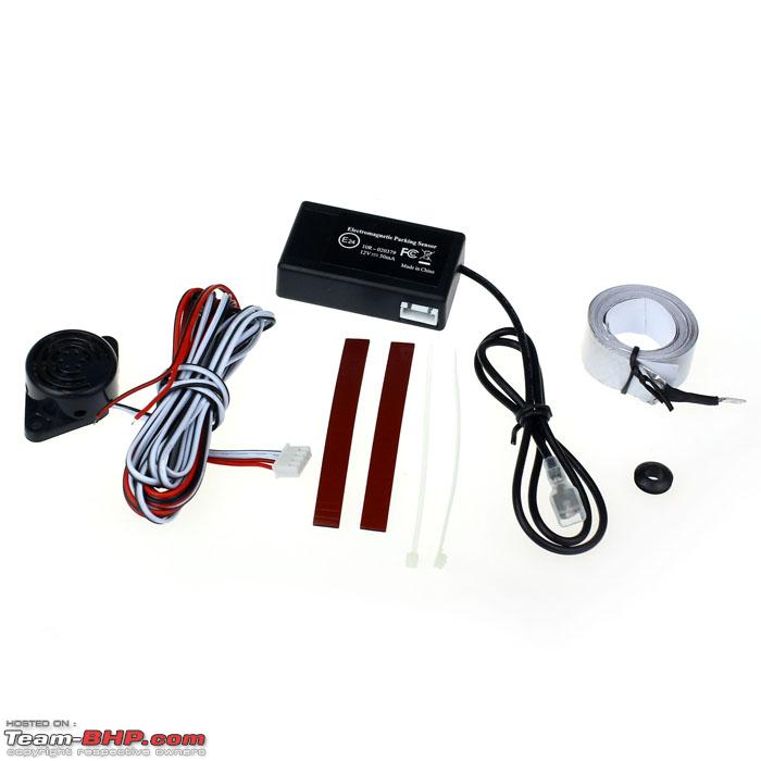

Attachment 1463667
I have found this "Electromagnetic Reverse Sensor" on ebay. No holes have to be drilled in the bumper for this.
I want to know if anybody has any usage feedback, before I order it.
How is this 'Electromagnetic Sensor' different from the standard ones available on the market ?

The electromagnetic parking system generates an elliptical field that covers sides of the car as well as the rear. And since it's just a strip attached to the inside of the bumper, no drilling is needed. Maintains the stock look of car.
In some cars, the bumpers might have crash protection elements which may hamper conventional ultrasonic sensor. Also, the electromagnetic ones don't get affected by dirt and grime as they are fitted inside.

How effective is this compared to the usual sensors? Have you tried it/seen in person?
