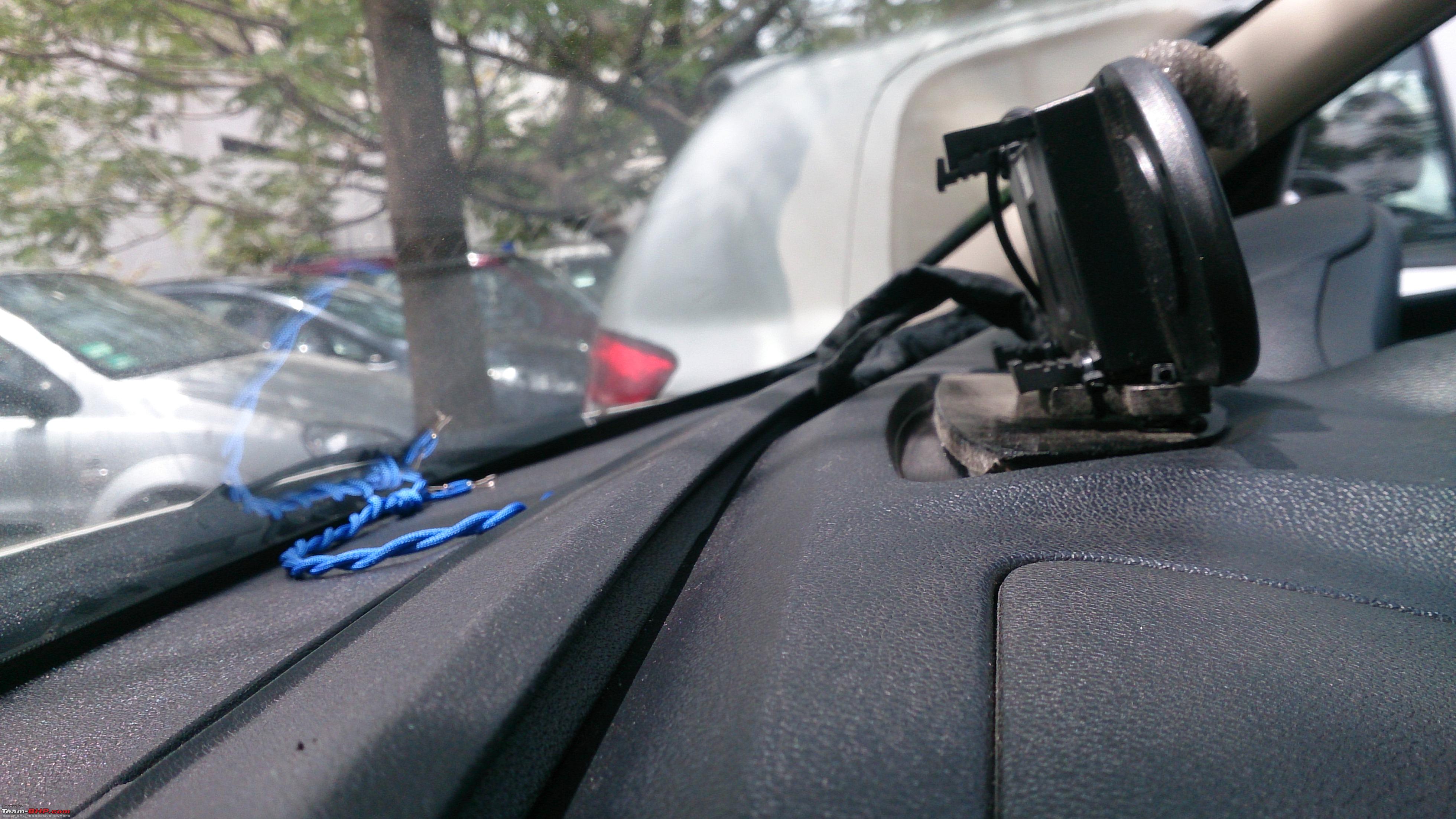

Hi again Ramit, seeing how eager you were for my pics I went down to my car park during my lunch break. I also found the pics I took during my fabrication attempt in August last year, in my HDD, so am adding them here.
1. Cutting the wood base to match the depression in the centre of the dash (I was really good in my woodworking class in school 39 years ago. Have had this fretsaw with me since then).
2. The components painted black: wood base chamfered to shape, hinges, scraps of wood shaped to fit on hinges, tie-wraps.
3. Hinges screwed into wood base, wooden scraps tie-wrapped to hinges, mirror tie-wrapped to scraps.
4. The contraption in lie-flat position.
5. Another view showing two sets of black tie-wraps per hinge.
6. Front view showing the hinges and the wooden scraps
7 Base was covered in double-sided tape. This didn’t last very long due to the residual polish on the dashboard, so I used Philips head cleaner on the depression in the dash, added Fevibond to the double sided tape, weighed it down overnight and its stayed put ever since.
8. Lying flat on the dashboard. The ugly grey foam was a temporary fix to prevent the mirror from bouncing and vibrating on the dash as well as to counter a little error in judging its lie-flat position. I also stitched a long, narrow sleeve out of black cloth to camouflage the cable and its connectors. It lies across the dashboard but is unobtrusive and somewhat protects the cable from the sun. The cable goes into the liner of the RHS A-pillar at its bottom end.
9. Pop-up position.
10. View from the side.

re: The reversing camera & parking sensor thread
That is super awesome, Thanks a zillion !!
I have one question. I see a cable coming from the ceiling upholstery. If I attempt to place the screen elsewhere, how do I manage that as it will be seen hanging loose
Ramit is offline
Old 17th June 2016, 11:41   #625
FarPatel's Avatar
Posts: 260
Thanked: 362 Times
What cable do you mean? I don't have anything hanging from the ceiling to the dashboard. If you mean that blue string, that's something I've hooked to the vent holes in the dash for another of my crazy ideas, but that's another story. That other big brown vertical line is a tree in front of my car
The cable from this mirror just goes along a groove in the dash, to the bottom of the right A-pillar, after which it goes invisible behind the lining
Let me know if you have any doubts.
FarPatel is offline

I will click a photo and share it here...What I mean is that there is a cable coming from top which connects to hat TFT screen may be to provide power, I will get more clarity when I take a closer look in the evening and share a picture here
Thanks !
Ramit is offline
Old 17th June 2016, 13:34   #627
FarPatel's Avatar
Posts: 260
Thanked: 362 Times
Oh, I get it. You're referring to your own car. Yes your cable would have been routed along the inside of your headliner. So was mine, and all I had to do was peel it out, unclip the panelling of the A pillar and reroute my cable.
