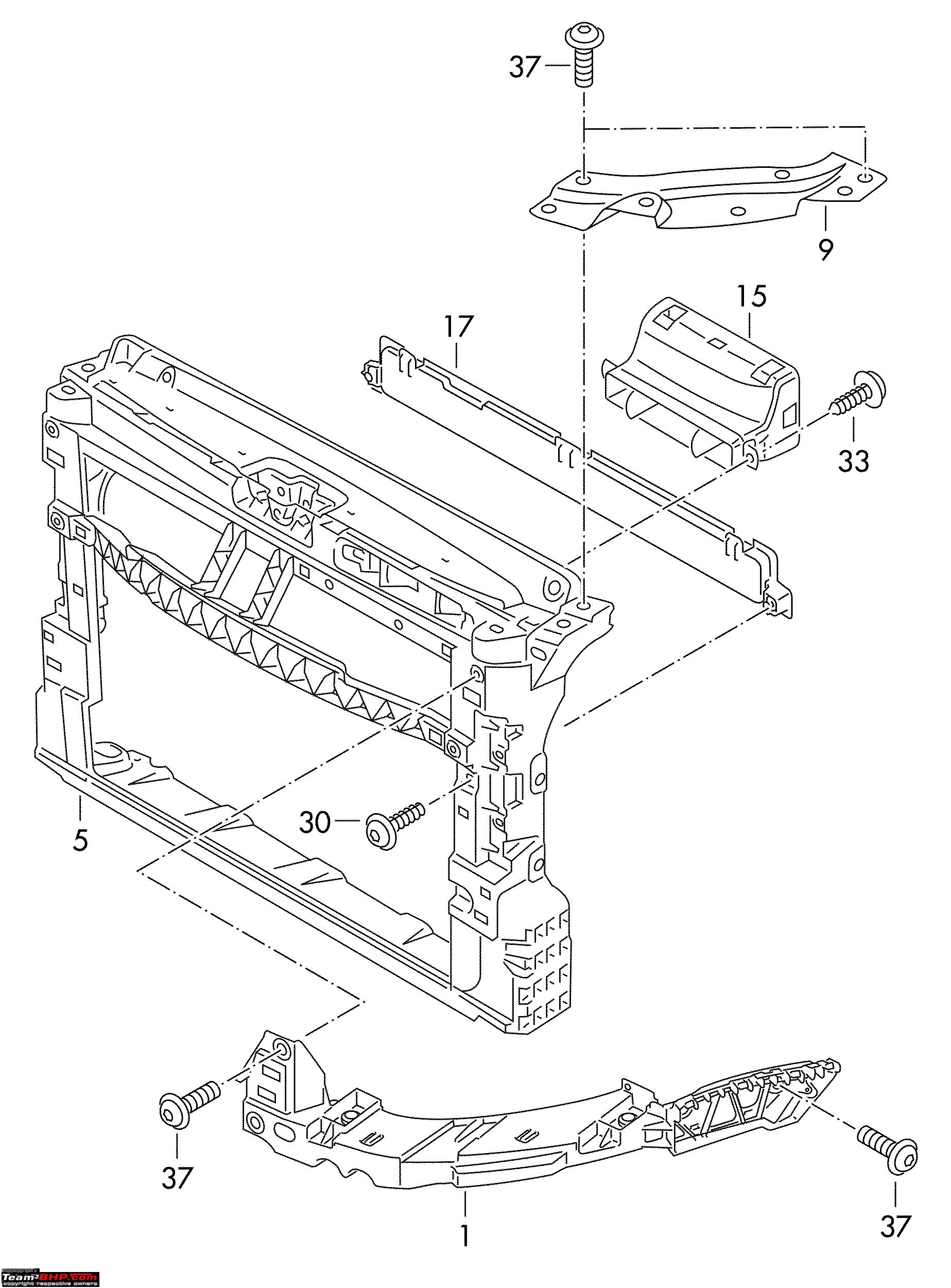

Opened up the front and sealed the side. This should work till the euro part comes (if it ever will) from germany :-| Also noticed that the front opening has more area compared to the side opening. Which is good. Btw if someone is doing this, do not cut off that separators in front.
VW Polo 1.5L GT TDI - Bay6 Downpipe & Code6 Remap EDIT: Now sold!-20150509_181535.jpg
VW Polo 1.5L GT TDI - Bay6 Downpipe & Code6 Remap EDIT: Now sold!-20150509_181543.jpg
Apparently the Euro part has opening at the back, so chances of hydrolock are nil due to that alone. In the Euro part the air goes in front and escapes from behind, the intake duct sitting higher would suck up from that stream of outside air.
Nicely done Sankar. Used the dremel?
Have you ordered it? If it was from the eBay link, did the seller agree to ship it across?
Why? Increased volume of air entering? Would it make a huge difference?
Why so? Those act like stiffeners to avoid bending?
Didn't use the Dremel, all the proper bits have been used up so didn't have any handy. So used a sharp flat bladed screwdriver to chisel out the outline and then used knife to smoothen it out.
Ordered a new one from a German parts catalogue site for 39Euros inclusinve of shipping. Paypalled the the money have not received any confirmation. Will wait for a month and if no sign then i will raise a dispute. Ebay guy was charging 50Euros for shipping alone. so didn't buy.
The area opened up is the original size of the opening VW intended when they decided to make the duct. Difference may be minimal but every bit helps. Lower IAT=lower EGT. No point in going for K&N and similar filters before fixing hot air issue. OEM air filter is not lacking at present.
The splitters on the air intake helps reduce turbulence. It also functions as a stiffener but if it was just a stiffener then the edges of the splitters didn't have to start about a CM further away from the intake opening. The splitter starts out nice and tapered and then cross section increases a bit going inside.

Euro spec Air guide channel - Opens to the front
Attachment 1368254
Attachment 1368255
The part no of the Euro spec air channel guide is - 1T0805971
Although i did not receive any confirmation from the vendor they did ship it and i received it couple of days ago. But India Post did its thing once again and the item was damaged. Top corner was broken :(
