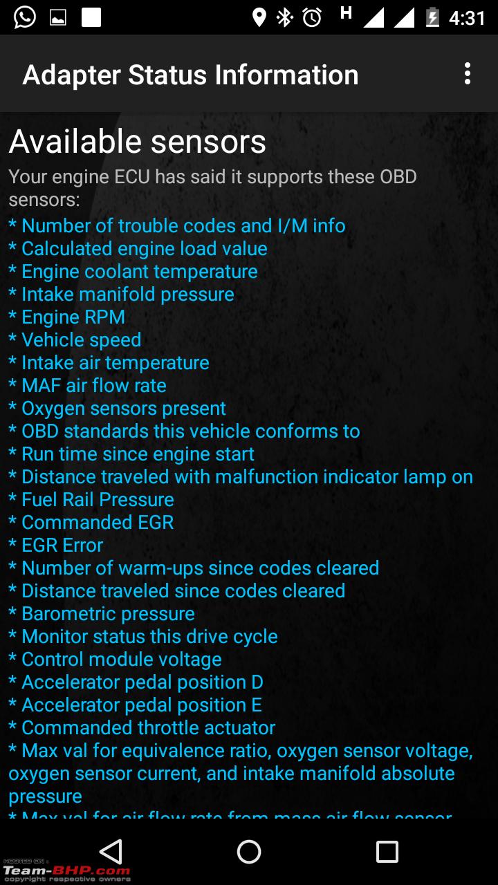

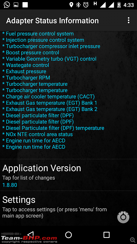

Have a OBD2 adapter for quite some time, but started taking interest very recently.
One query: If I go to 'Adapter Status' and check 'Available Sensors' while connected to my car, it shows a bunch of sensors the data from which I would love to track and log. But, while adding a dial or while selecting a PID to log, I don't see these sensors listed at all.
What can be done to get those missing feeds?
e.g. I see a sensor for turbocharger RPM available on my car, but cant seem to find a way to add a dial/display corresponding to that or even log that data.
Can the experts help?
Though I haven't got time to spend in the XUV but when I did get, I hooked it to the OBD to see this RPM sensor.
There is no way to add a dial but I can only see the reading when I scanned the sensor list.
Couldn't take a picture of the scanned data though.
