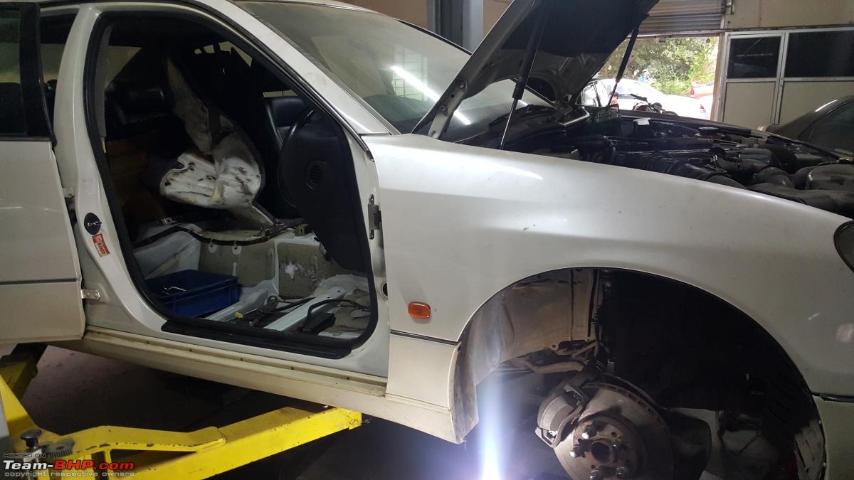

I'd like to cover an interesting chapter of my tuning career with a very interesting build after my SOHC Honda exploits, something never done in our country. So its a Toyota/Lexus GS300 with a 2JZ-GTE Auto transmission JDM Vortex edition with rear wheel steering - with the same mental engine from the legendary Toyota Supra Mark 4 Twin turbo. The world is still so mad about this inline 6 monster after being off production for almost a decade. The world's best Inline 6 engine and the best sounding too. After having built another Import, a Mitsubishi EVO 4 4G63T to make over 400 horses, this is our latest pet project besides an Integra DC2 Type R and a few other race Honda SOHC and DOHC projects.
A good friend, from down south approached us to build his dream project and it was this - A high horsepower Lexus GS300 with a Supra package underneath in all its glory with an under-stated sheep clothing of a plush luxury Lexus on the outside. A total JDM sleeper was the plan.
Shaheen planned his dream and found a mint 2001 Lexus GS300 to his luck. After a quick restoration he sent the car over to us and in the process we managed to spot and quickly import a very rare Supra Getrag 6-speed transmission, which is quite rare a find. We also managed to bring down all the related bits and pieces to put together the manual conversion puzzle. A few hardcore enthusiasts abroad have converted the GS300 into nice drift machines with the manual conversion, but it needs some serious dedication and is an extremely difficult task. A big task for even people abroad with all the resources right around them, so let alone just such a job in India. After the manual conversion, the target was to strip down the engine and then go all-out. We wont speak any numbers now, but its going to be a serious build. The gearbox is good to handle a very modest 1000hp atleast. So after extensive research we decided to start the tear down process to first complete the manual transmission conversion. The engine bay and everything is so tightly spaced that its hard to even fit a finger anywhere underneath.
The stock Lexus GS300 is quite a slouch in stock form. Very lazy acceleration and the auto transmission makes you really wonder if it really packs over 250hp with a twin turbo VVT engine which is otherwise a mayhem in a supra with a manual box. The car is super heavy and is loaded with futuristic electronics and gizmo, very clearly the car was designed and built well ahead of its time.
So here is our build story. Will put down all pics and updates as and when we progress over the next few months.

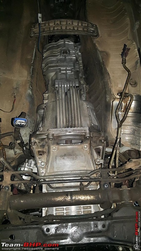

We took down the stock Auto-box. And fabricated brackets and mounts to attach the Supra 6-speed transmission. Later we had to massage the gearbox tunnel to fit the now larger gearbox housing and find the right location for the gear lever and also now fabricate a new hand brake mechanism.

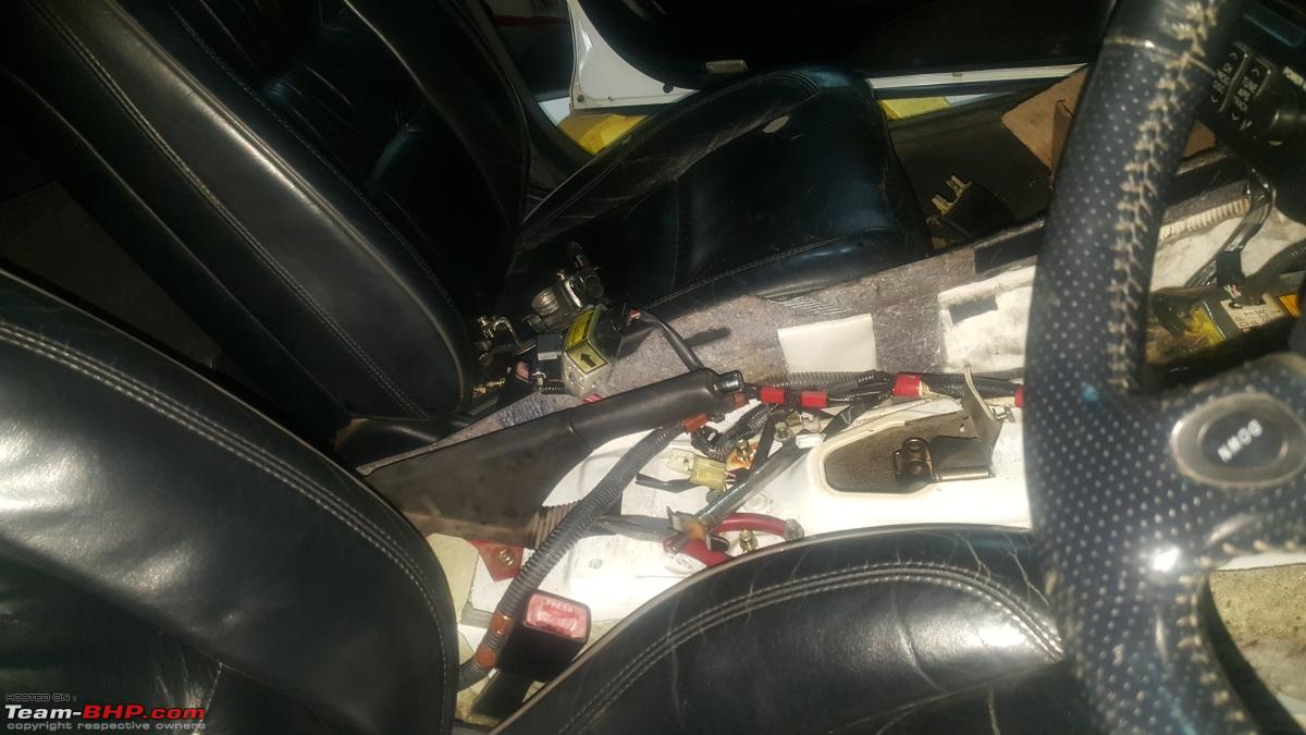

The next tedious task was to install a clutch pedal. The space under the dashboard to accommodate a clutch pedal is nearly impossible to find. With a lot of relocation and getting rid of the AC piping, we managed to slot in a Supra pedal set with extensive fabrication which took near two days. Also fabricated custom aluminum pedals to get the right width and feel. Then came the trouble of finding space to accommodate the external clutch master cylinder and do the rest. That also was finally done over time.
We have now converted this to a fully functional 6 speed manual transmission Lexus GS300. Only need to integrate the related electronics and then go for a fully standalone ECU module and get the rest of the car fully functional to make it a perfect 6 speed 280hp sleeper.
Post which we will strip down the car and go all-out with the engine. With all the right parts one can imagine to fire up that 2JZ-GTE monster engine.
A few pics will now do the talking and will update the thread as and when we progress.
