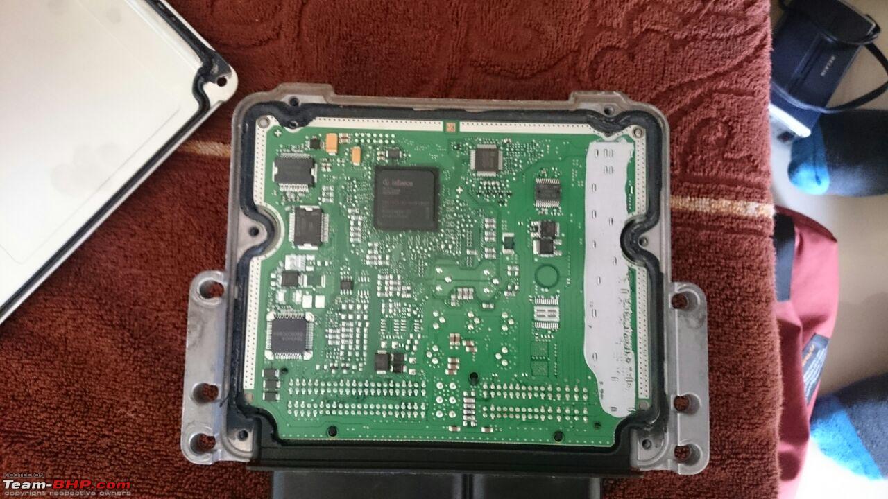

After quick 0-100 runs, Remap process was initiated. ECU is located under wiper compartment. Vivek got the ECU out in just 10 minutes. It was a Bosch EDC17, made in Hungary ECU. Vivek opened the ECU carefully. This was the first time I saw ECU dissection. I was little scared because if the tool goes an inch more inside, ECU board would be damaged. Vivek did a good job and ECU was opened in 10 minutes.
Maruti S-Cross 1.6L : Remapped by Tune-O-Tronics. EDIT: Issues on page 6-img20160907wa0010.jpg
Maruti S-Cross 1.6L : Remapped by Tune-O-Tronics. EDIT: Issues on page 6-img20160907wa0002.jpg
TOT doesn't solder on ECU board - Spring loaded connectors are used

TOT had got their Master tool to read and write the files. Tool software will show the picture of ECU, how to make connections etc. Vivek found minor difference in my ECU compared to the one listed in software. Tool was not able to identify my ECU and the read was not possible with existing protocol listed for S-Cross 1.6. He tried using different protocols and nothing worked.
It was beyond their limit now. It's upto tool manufacturer to develop the protocol. A tuner cannot do anything if he is not able to read/write the file.
Vivek got in touch with Sid and other support guys and started to work to sort out the issue. Vivek decided to remap my friend's polo. It took just 45 minutes and that car is one beast now. Post remap, car is doing 130 BHP (That's a huge gain from stock 90 BHP). For those who plan to remap, it doesn't make any sense to buy 1.5 GT TDI. Both regular and GT TDI could be taken to same power figures post remap. VW is charging a premium only for different ECU map. My friend was very happy. I tried doing 0-100 run in his remapped Polo and got 10.2 seconds. I was not happy with the run as I made few mistakes. It should be within 10 seconds for sure. Autocar claims around 13 seconds for 1.5 Polo TDI (90 HP). Oh boy, now his remapped Polo is faster than my Stock S-Cross.
We got back to S-Cross. After 2 hours, we had an update. We got a full read of EEPROM but there was a checksum error. Vivek assured nothing would have happened to ECU as it's only reading the file. Checksum error while writing might brick the ECU and car wouldn't even start. We connected the ECU back and the car did start, relieved!!. Tool manufacturer has to develop a proper protocol, correct the checksum etc. We knew it would take time. It was around 10 PM and did not receive any updates. Vivek was ready to stay back and remap the car next day. He was positive and said they would definitely do something as they have got the read of my ECU. But I was busy for next few days, So Vivek had to head back to Bangalore.
Most of the tuners would look if the said car is supported in their tool and would say it could be remapped. But for S-Cross, tool wouldn't be even able to read the file with existing protocol. Now I know, why Petes were not fully confident. They would have tried on 1.6 S-Cross before and Yes, they did tell that only few 1.6 S-Cross could be remapped.
I called Vivek next day and was happy to hear that TOT has sorted out the issue. I was very excited and remap was scheduled after 4 days. I badly wanted a remap for 1.6 S-Cross after driving my friend's remapped Polo and couldn't digest the fact that he was faster than stock 1.6 S-Cross.
