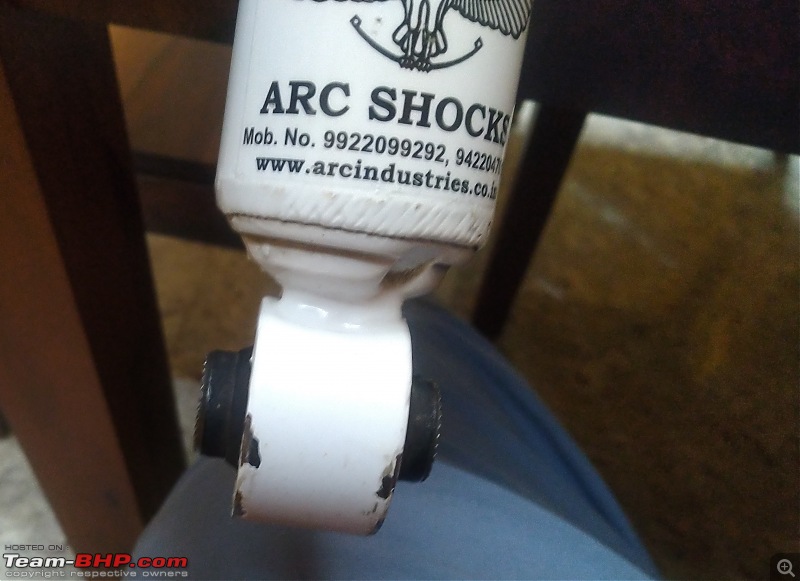

Went to a FNG to get them fit and had the first shock. The top mount of the shock would not fit into the chassis slot. The top mount of the shock was a tad too wide compared to OEM. Checked this with a Vernier scale and compared with the OEM shock absorbers. Contacted the representative and he insisted that the mechanic is not fitting it properly. He had a talk with the mechanic and agreed to send a replacement set matching the OEM mount dimensions. Later, I realized that they had sent the set for Verna and not i20. Even the invoice that I got mentioned shock absorber for Verna and not i20. They shipped a replacement set for i20 which I received a week later and this set fit correctly. Installed them in the first week of June 2020.
Pathetic experience with ARC shock absorbers / dampers-1first-time-installed-left.jpg
Pathetic experience with ARC shock absorbers / dampers-2arc-right.jpg
