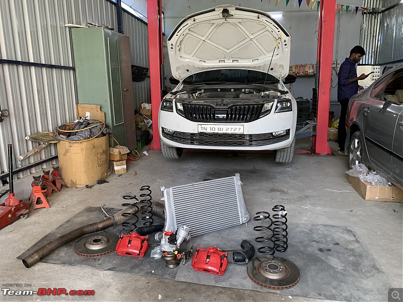

The research for the IS20 build started. I had the turbo below my bed for a month and was not confident to use it until I find myself a reliable tune. The DQ200 is among the fastest gearboxes but as documented elsewhere, it’s not a strong one. A bad tune will certainly slip the clutch and in no time I will be left with a failed gearbox. I spoke to many people with similar builds, tuned by some famous tuners and almost all of them had clutch slip issues. Over last few years I have made some friends over in Russia and as we know, Russians are far ahead insofar as car modifications are concerned. Some of them have perfected the tune for the IS20 turbo + DQ200 gearbox package. More on this later.
Parts I bought for the build:
  • IHI IS20 turbo
  • Go Fast Bits diverter valve
  • Integrated-Engineering intercooler

Now with all the necessary mods it was the time to start the build. Many discouraged us from doing this build ourselves and told us that an established and experienced tuning garage is required for such a build. From here on, I had decided to take this upon myself and gained knowledge through videos and literature that I had completely immersed myself into for days and nights on end! From what I absorbed by watching videos and reading all the material available to me, I was confident that it is not too difficult to do it myself. A group of friends and my mechanic teamed up to start the build.
My Skoda Octavia 1.8 TSI | Upgraded turbo, intercooler, suspension, brakes & more-6.jpg
Being the first build for us, we took eight hours to complete it while having fun along the way. Once the turbo, downpipe and intercooler was installed we flashed the TCU and ECU. I had requested my tuner to flash the most conservative map possible and I wasn't after numbers, as Octavia is a front wheel drive car and too much power will probably land me in a soup. It took him 30 minutes to complete the mapping process.

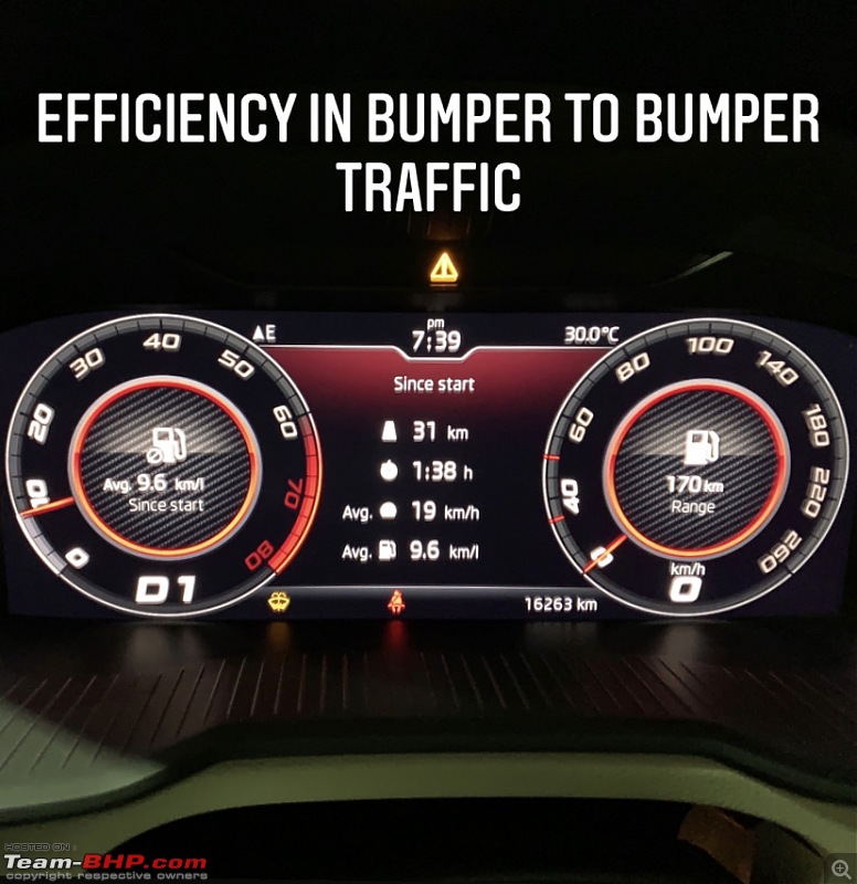

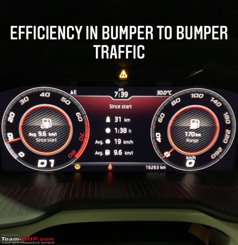

Post 500 km after remap, the fuel efficiency is much better than what I had got in a stock car when driven normally. However, it drops only when pushed a bit more than usual. The car feels just like a stock car when driven normally. The only give away is the sounds from the diverter valve. The engine is very smooth and gearshifts are like butter. Under heavy acceleration, the gear shift feels sloppy but only on occasion. This is thanks to the flex from the engine and gearbox which the dog bone and pendulum mounts can solve. However, installing these mounts would increase the NVH and hence decided to live with the flex.
