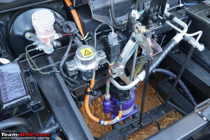

You can't run the air conditioner from a solar panel or battery because it consists of two components:
1) The blower fan = This is electric, and can be run even when the engine is off.
2) The compressor = This is powered via a belt from the engine crankshaft. So only operates when the engine is running.
A typical car AC compressor - it gets bolted to the engine block and driven by a belt:
How to run the aircon when engine is off? I want to sleep in my car-accarcompressorforhyundai500x500500x500.jpg
However, for the sake of discussion, there is a (complicated) workaround.
You could switch your engine-driven compressor to one that is electric.
The same way as hydraulic / engine-driven power steering pumps got replaced by electrical units, there are some options for electrically driven compressors, albeit for electric cars.
Take the Mahindra Reva e2o for example. Being electric, it has to have an electric compressor for the functioning of the AC.
Hidden away on the e2o:
How to run the aircon when engine is off? I want to sleep in my car-02-img_1011.jpg
Much more visible on the e2o Plus (the purple unit):
How to run the aircon when engine is off? I want to sleep in my car-mahindrae2oplus04.jpg
The compressor unit:
How to run the aircon when engine is off? I want to sleep in my car-img_1019.jpg
Part number, in case you actually want to do this!:
How to run the aircon when engine is off? I want to sleep in my car-img_1020.jpg
