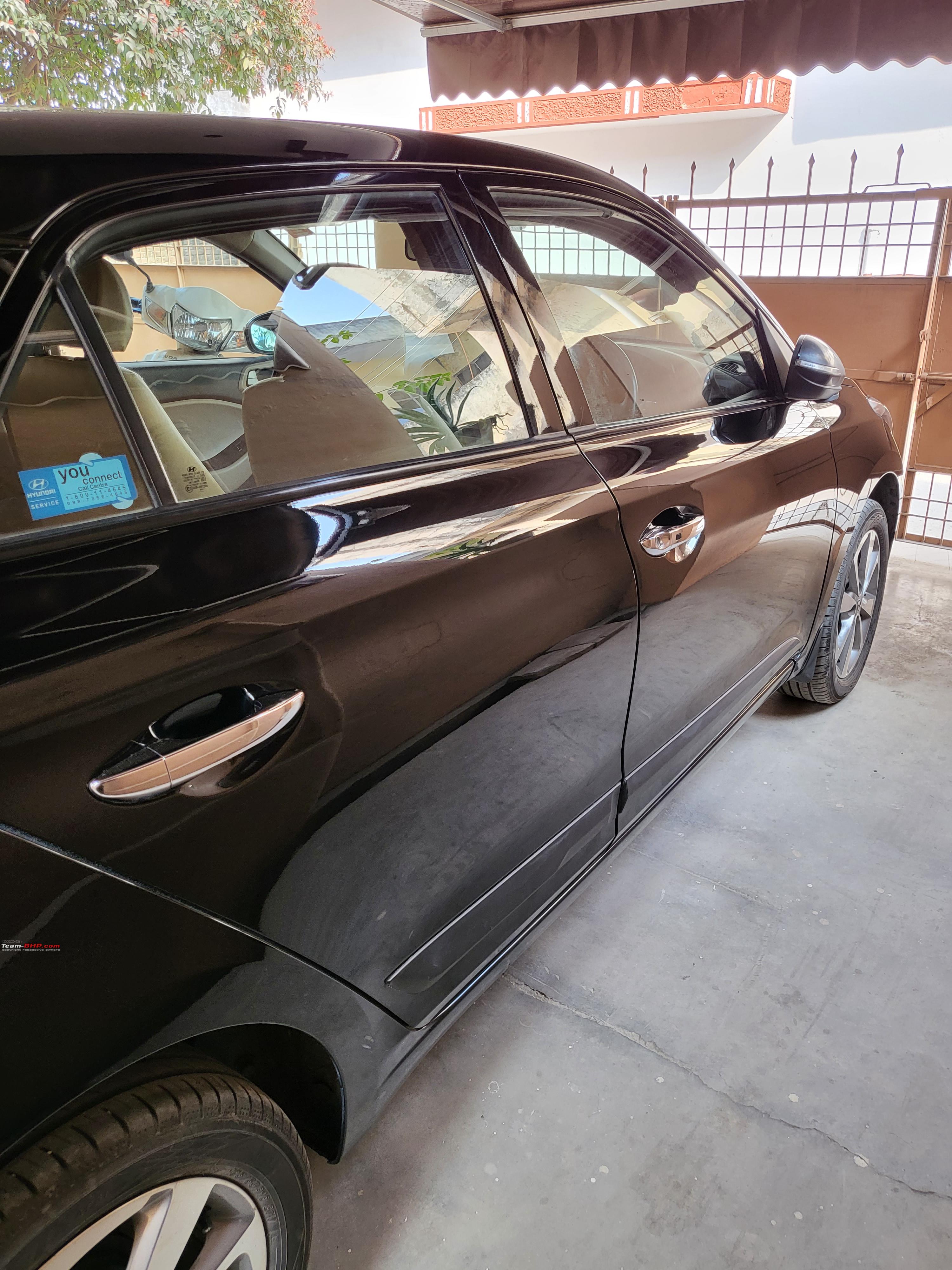

The car was always parked in shade. In Mumbai, it used to be parked in multi-level parking both in the office and at home. For the last 8 months or so, it has been parked under the porch in my hometown, Lucknow. Here is the picture of the current parking for your reference.
Horrible experience with 3M PPF | Completely deteriorated & hard to remove-20211223_110822.jpg
What works for me is good parking + car cover + detailing twice a year
