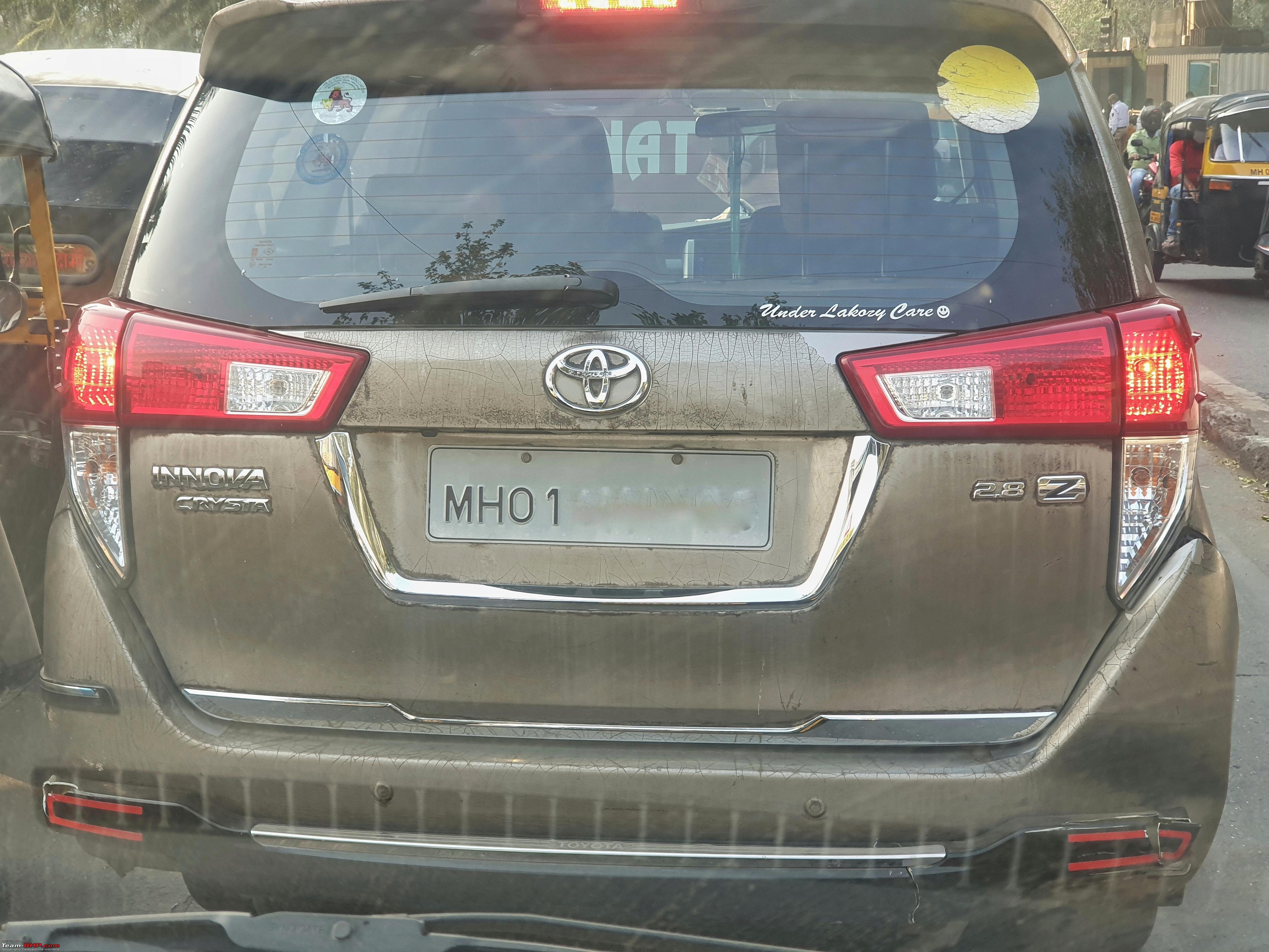

A PPF'd Crysta in Mumbai traffic
See the condition of the said PPF
Makes the car look really bad
Coincidentally saw this vehicle 10 mins after reading this thread
Horrible experience with 3M PPF | Completely deteriorated & hard to remove-20220117_1640190101.jpeg

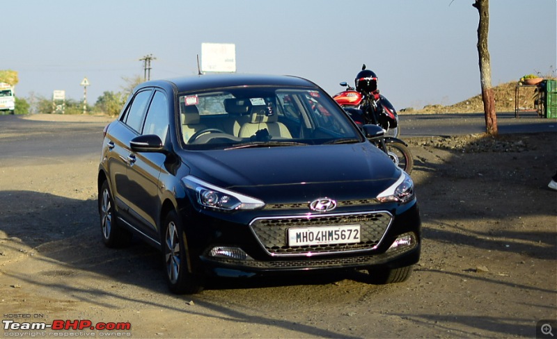

I'm attaching a few pictures on how PPF looked across different years:
After 3 Years
Horrible experience with 3M PPF | Completely deteriorated & hard to remove-_dsc018812.jpg
After 4 Years
Horrible experience with 3M PPF | Completely deteriorated & hard to remove-img_20200607_142623_bokeh.jpg

Understood. The PPF looks good in the older pics you have shared. Was the fading and deterioration sudden or did it come up gradually?
Harsh weather should not cause this. Any chance of any chemical/acid rain kind of exposure?
A good quality PPF with quality adhesive should come out fairly decent when removed.
Removal of PPF is best done with a steamer. Second best option would be by careful usage of a heat gun. That would free up the adhesive and would ensure paint is not damaged provided it is factory paint or good quality respray.
PPF deteriorated exponentially since the last 6 months, before that it was shiny and glossy. However, it had become yellowish and brittle but because of the black colour of the car it was not noticeable.
Heat gun and warm water were used. However, the adhesive was so strong that whatever approach we took it chipped the paint from the plastic parts and hard adhesive residue was left on the metal parts which took a lot of effort to clean. Here is the video which I captured while work was being done on the car.

The 3rd and 4th year pic looks neat..
What happened is 5th year... Acid rains ??
Was the car previously parked in covered parking and later in open parking under the sun?

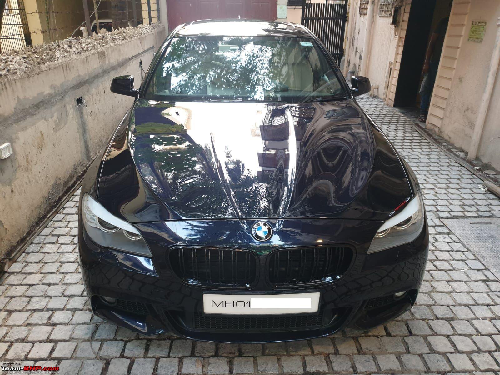

I keep my cars for long (typically 10 years), so thank you for this thread. Was always worried about how PPF would age over a decade. We did ponder over PPF, but eventually decided against it.
What works for me is good parking + car cover + detailing twice a year + other simple best practices listed in this article.
Turning 9 this year:
Horrible experience with 3M PPF | Completely deteriorated & hard to remove-1.jpeg
Horrible experience with 3M PPF | Completely deteriorated & hard to remove-2.jpeg
Almost 10 years since the last paint job:
Horrible experience with 3M PPF | Completely deteriorated & hard to remove-3.jpeg
