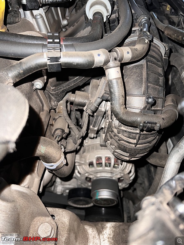

The Racechip ECU connects to three sensors in the car. A - Manifold Absolute pressure sensor, B - Boost pressure sensor, C - Crankshaft position sensor. It does not alter fuel injector pressure as in many diesel tuning boxes and the fuel pump will not be meddled with. They provide a wiring harness with A, B and C pairs of connectors and each of it is a T junction where one connector picks up signals from the sensor and sends it to the ECU, and the other connector plugs into the vehicle harness to send data to the car engine ECU.
Installation was done at night so I do not have detailed instructions but the connection A to the MAP was the toughest since its located deep inside the gap between the intake and the cylinder block. I needed to use a long screw driver to unlock the connector and then remove it with two of my fingers which reached till there. And to fit the Racechip harness to the sensor I could again use only those two fingers to slide it into locking position. The gap you see in this image is where the palm must go in above the alternator, and you only get to peep into the area from above
And to do this, I had to remove the vacuum pump off its mounting bolts to make space for the hand to be slid into the gap.
Connector B was relatively easier since it was easily accessible and connector C was cakewalk since the CKP sensor is right on top of the engine head cover below the plastic trim. Had to place the ECU near the battery and fusebox for now for easy removal. Will share some more pictures in the coming days when I get time to open up the engine bay in daylight.

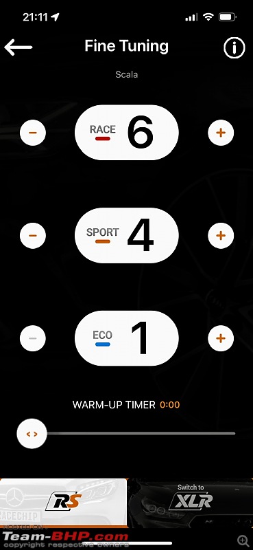

Like I explained earlier, after installation the ECU modes were supposed to be switched by mobile app only, since I opted for it. In the non-app version of the same product, there is an adjustment knob available which needs to be adjusted between six steps to change the performance modes from Economy till full fledged Race mode.
I was very angry about the app not working since there is a firewall that prevents Indian IPs from accessing their back end to fetch vehicle tuning data and update the ECU. When I contacted support, they gave a horrible response that the only way out was to use a VPN and they could not do anything about their backend and alter the firewall. Even after I tried using a paid VPN with Airtel internet, it didnt work and I requested a return(which was another challenge since I had to get it back to Germany first). I parked my car in my grandparents place with ACT fibernet and tried casually and the app was able to connect without issue.
Thats when it downloaded the maps specific to my car and flashed it into the ECU. After that I could set the performance modes. After this initial setup is done, there is no need to use VPN or internet unless an update to the maps is needed. So finally things got working the way it should.

  • ECU offers six maps and the mobile App offers three modes, to which you can assign any of the six maps.

  • There is a warm up timer which can be configured to set the maps to trigger after vehicle start. Useful if you want to keep it in higher performance modes and trigger it only after engine warm up
  • Economy mode or map 1 is what I always plan to use. It sobers down the turbo boost, eases throttle response and yet provides linear acceleration when needed.

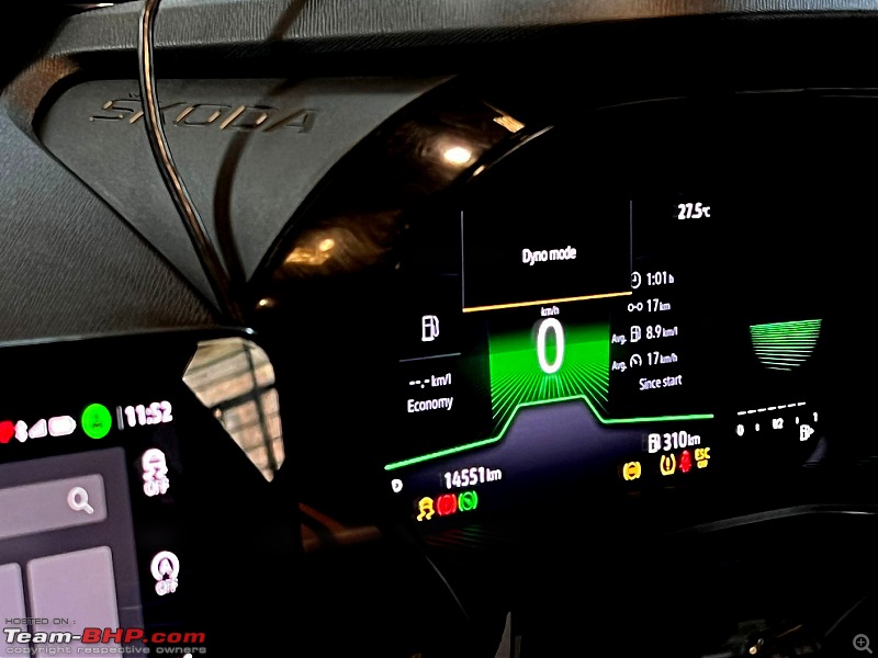

  • There is at least a 10% increase in FE and is evident on the display, as well as the DTE indicator not reducing even after some driving. Last week I drove 20kms to office and DTE came down by 5kms. But thats just an additional observation, not an absolute change.
  • The Eco mode in my crysta for comparison only alters throttle response and the car just gets lethargic until the throttle is shoved hard. Whereas in the Racechip, it is more like driving a NA petrol with the turbo not present.

By the way, here are some stats from the AC after the VCDS mod - You can notice how the evaporator temperature is at 2.0 deg C and the vent temperature at 10 degs even when the engine is idle with Climate control set at 21.5, which is how I have chilled air being thrown from the AC

2. App control is definitely a must have in spite of this issue. It let's you shift modes on the fly and doesn't require you to stop the vehicle, access the engine bay and make changes. Shifting on the fly is the only way you can feel the subtle differences between the six maps. Else the major difference will be between 1 and 6 only.
3. I went for the RS with 6 maps because the extra cost for GTS was not justified with one extra map and same control strategy. However the S version to RS version is a bigger jump because S has only two control channels and lesser maps. Hence I chose the RS and didn't go higher up to GTS.
Overall the experience has been good. No issues nor teething troubles just like a well engineered product. App connect works without any connection issues and you can switch maps easily.
On the performance front, I am now sticking to Sport mode or Tune 4. I am getting around 15% increase in FE. Me being a pretty heavy footed driver, the economy modes didn't work in my favour even though I want to switch to it and practice lighter foot driving. The Eco mode(Tune 1 and 2) makes the vehicle very sedate and that will end up in me pushing the accelerator further which will negate the economy benefit. I think it will definitely benefit if one drives with a light foot.
Tune 3 and 4 are such that the low end and light throttle situations are very sedate and controlled and will wake up the car when pushed slightly harder, like 50% throttle and after that the car gets fast. So for me it works in the city well and the car is well controllable in light to medium traffic. Its the best improvisation of the stock vehicle behaviour.
Tune 5 I haven't tried but Tune 6 makes the car fast the moment it senses your foot on the accelerator pedal So that's something which will be almost useless in traffic scenarios and you will end up unnecessarily accelerating and braking. I haven't taken the car on the highway yet so for me Time 4 is pretty much the thing now.

The curiosity bug bit me and I ended up driving to Harmonixx, Bangalore to do this:
Successfully RaceChipped my Skoda Slavia-whatsapp-image-20231003-20.29.38.jpg
In short, the Racechip ECU increases peak power and torque by a fair bit. The mid range is where the Racechip throws out better numbers but the peak power is rather consistent even across the modes. This supports my feel that even in Eco mode if the throttle is pressed hard, the power output still builds up without that initial eagerness. Will be posting the graphs in a bit since I am on the move currently.
Thanks a ton to Rahul@Harmonixx for the elaborate trials which included multiple runs in each mode so as to get reliable numbers and avoid any incidental variations.
