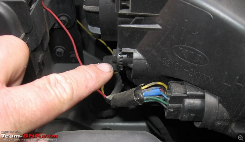

You will have to first attach the holder in the lock position and the bulb can get into the holder in only one position make sure to check this out when installing. Make sure the position of the led is vertical in the reflector adjust as per below diagram.
Caption 2: Installation Method
