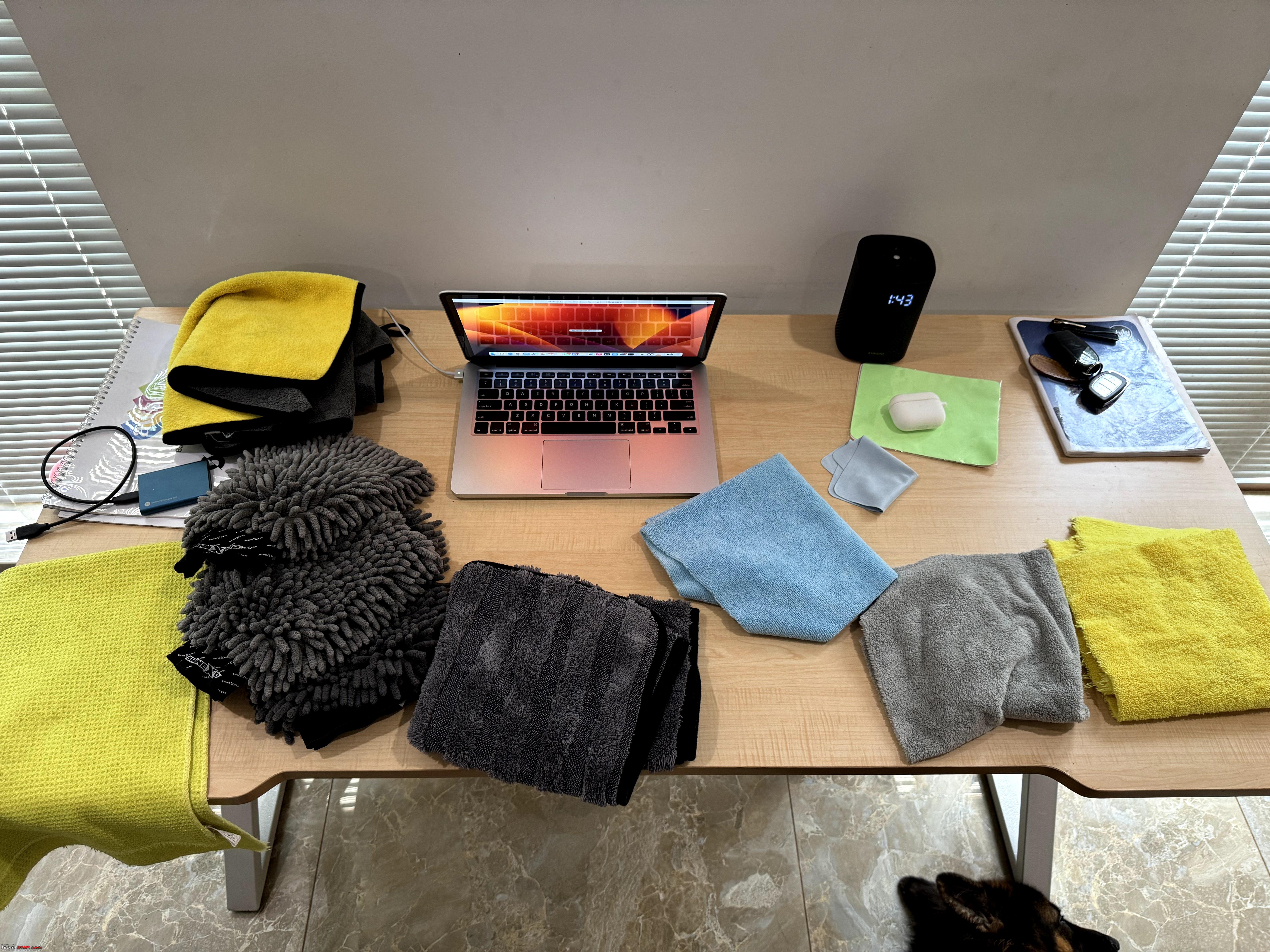

Here are most of the ones I purchased and experimented with over the last year :
The Dummy's guide to Microfibers : Types, uses and maintenance-img_3418.jpg
All of them have a different purpose and are of varying price points. Don't get too carried away with GSM and brands and wanting the most expensive one. After a certain point, they don't matter as much as you think and while durability varies, they are not meant to last forever. It's better to buy 2-3 cheap ones over one very expensive one. Some of the expensive dual pile ones can do 2 tasks but there is no such thing as a great all purpose microfiber that you can use for everything.

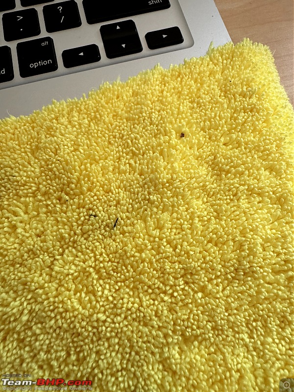

However, you cannot use them on glasses like windshields etc or they will leave tiny fibers behind. Glass is a different type of surface and it can rip out tiny little threads of microfiber which will then be seen as lint. For that, we have dedicated glass microfibers.
The Dummy's guide to Microfibers : Types, uses and maintenance-img_3644.jpg
Lint left behind on a mirror when wiped with a non-glass specific microfiber. If you accidentally end up with this kind of linting, just wipe with a no pile towel (listed at the top in this post) to remove them.

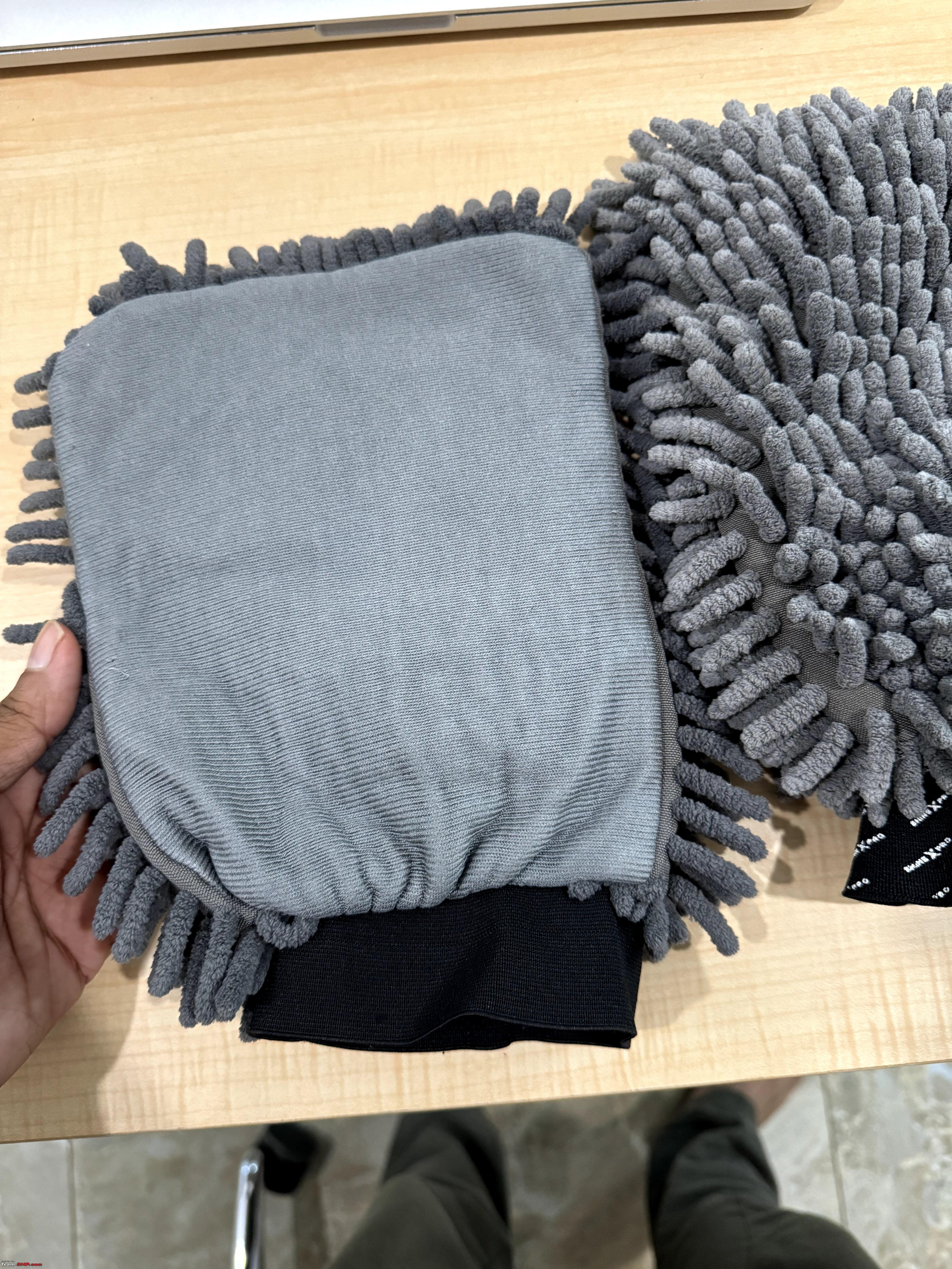

Chenille Wash mitts
They are the easiest to use for beginners. They have these noodles sticking out of them that move around based on which direction you are swiping. This means a different side of the noodle is contacting the surface when you change directions. This allows you to be less careful of how you are swiping as well as cover a lot more area before having to return to the bucket to clean them. The best part about these mitts is that swishing them around in a bucket of water will remove most of the dirt trapped in them, letting you re-use them. Works even better if you have a grit guard.
The Dummy's guide to Microfibers : Types, uses and maintenance-img_3432.jpg
The Dummy's guide to Microfibers : Types, uses and maintenance-img_3437.jpg
They come in two types. One sided and double sided. I recommend getting the double sided ones because you can just flip your hand around and cover even more area before returning to the bucket to rinse off the dirt. They are anyway only marginally more expensive than the single sided ones. The cost will generally determine the amount of soap solution they hold or how many "noodles" they have.
It's good to buy 2 of them. Use one for the top 80% of the car, and another for the bottom 20% which has the most muck and grime.

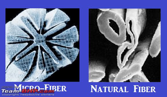

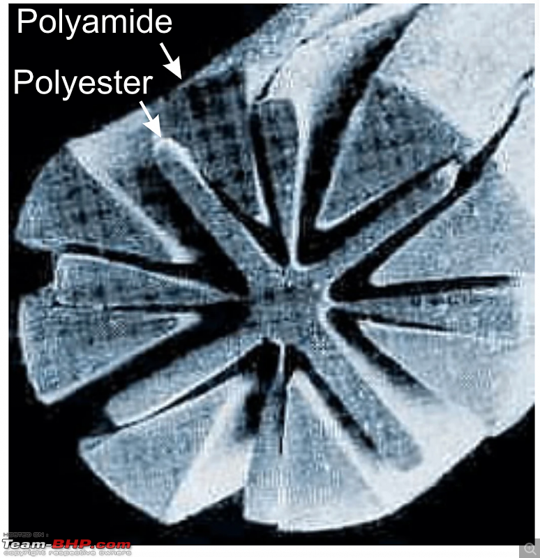

Microfiber consists of 2 parts, polyamide and polyester. They are fused together and shredded to form a 'star' like shape that is only visible under a microscope. This gives it a high surface area as well as crevices that allow it to collect a large amount of dirt. These tiny fibers are then twisted together to form threads which are then woven into a variety of towels, mitts etc.
This is how it behaves when wiping across dirt. As you can see, it's not some magical rag that transports dirt to the nether realm and it is possible to fill it up and requires to be cleaned every now and then.

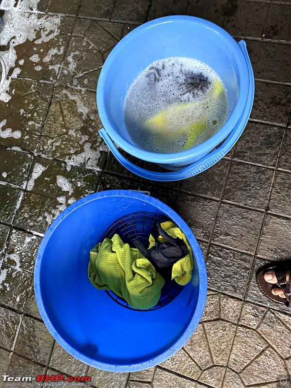

Sort out your drying towels and towels that are just very lightly soiled and your heavily soiled towels.
You will generally be left with some PH neutral car shampoo in your bucket after washing your car. Instead of throwing them away, we can put them to some use by throwing your heavily dirty towels in them and swirling them around.
If you have a grit guard for your bucket, even better. Rub them on the grit guard to get them to release as much dirt as possible.
The Dummy's guide to Microfibers : Types, uses and maintenance-2.jpg
The colour of the water in the bucket should now be pretty dark. Transfer the towels into another bucket and throw the dirty shampoo water away.
Now add about 10ml of APC such as kochchemie greenstar into the empty bucket. Fill it up with water. It should foam up on it's own. Throw the towels and mitts into this bucket. Swirl it around and then let them stay soaked. Leave it overnight.

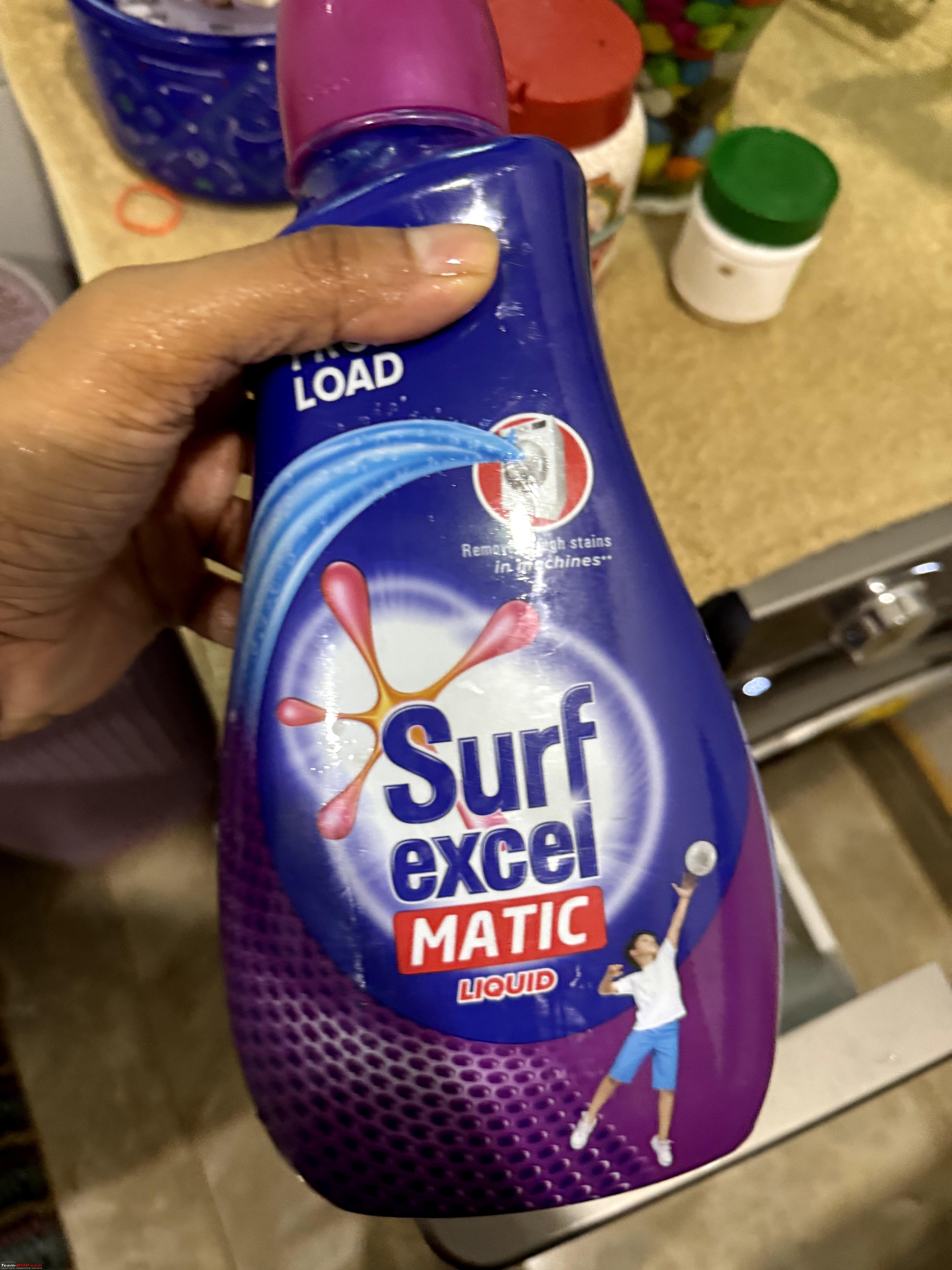

Then, I throw them all into the washing machine. If they are mostly clean, I just let them run for a quick cycle with no detergent. Just to rinse and dry it (20 mins wash and spin dry)
The Dummy's guide to Microfibers : Types, uses and maintenance-img_3474.jpg
If they are still somewhat soiled, then I run them for a longer 1 hour cycle with some liquid detergent added. Wash it on warm water (30-40C) if possible to help the microfiber release the dirt trapped in it.
Do not wash it in water hotter than that since it might melt the fibers. Do not dry it in a dryer which uses hot air for drying. Make sure not to use any fabric softener. It will clog up the microfiber and you will have to soak it in APC again to remove it.
The Dummy's guide to Microfibers : Types, uses and maintenance-img_3475.jpg
This is the detergent I use, same as for my usual laundry. It's not ideal but it's priced in the middle and works okayish.
There are detergents made specifically for microfiber which will work better.
However they are very expensive and I can't bring myself to spend 3k on a detergent to wash about 1-2k worth of towels. The trick I mentioned above with soaking in APC will generally get it just as clean.
